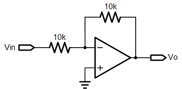

          So feeding a sinusoidal signal into the inverting input of, let's say, an op amp unity gain buffer stage, would be the equivalent of placing a negative sign (-) on the sine function?
            A unity gain buffer is non-inverting, so you need to use an inverting opamp stage.
