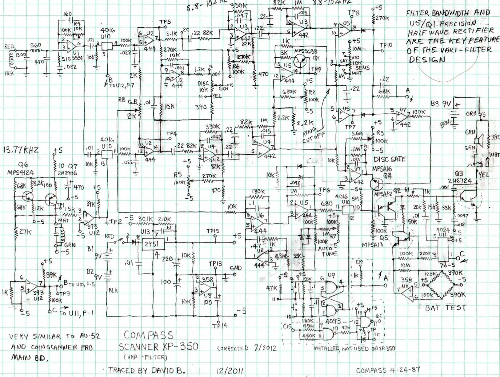

    I saw a reference to the term "vari-filter" on this scheme. I've seen it mentioned before in reference to designs by John Earle?, I think. What exactly is a vari-filter?
Name:	XP-350 corrected.jpg
    A narrow bandpass is nothing strange so why call it a vari-filter? Hocus pocus pseudo marketing?
      It looks like a gyrator filter?
        Well, I found the answer. It all makes sense:

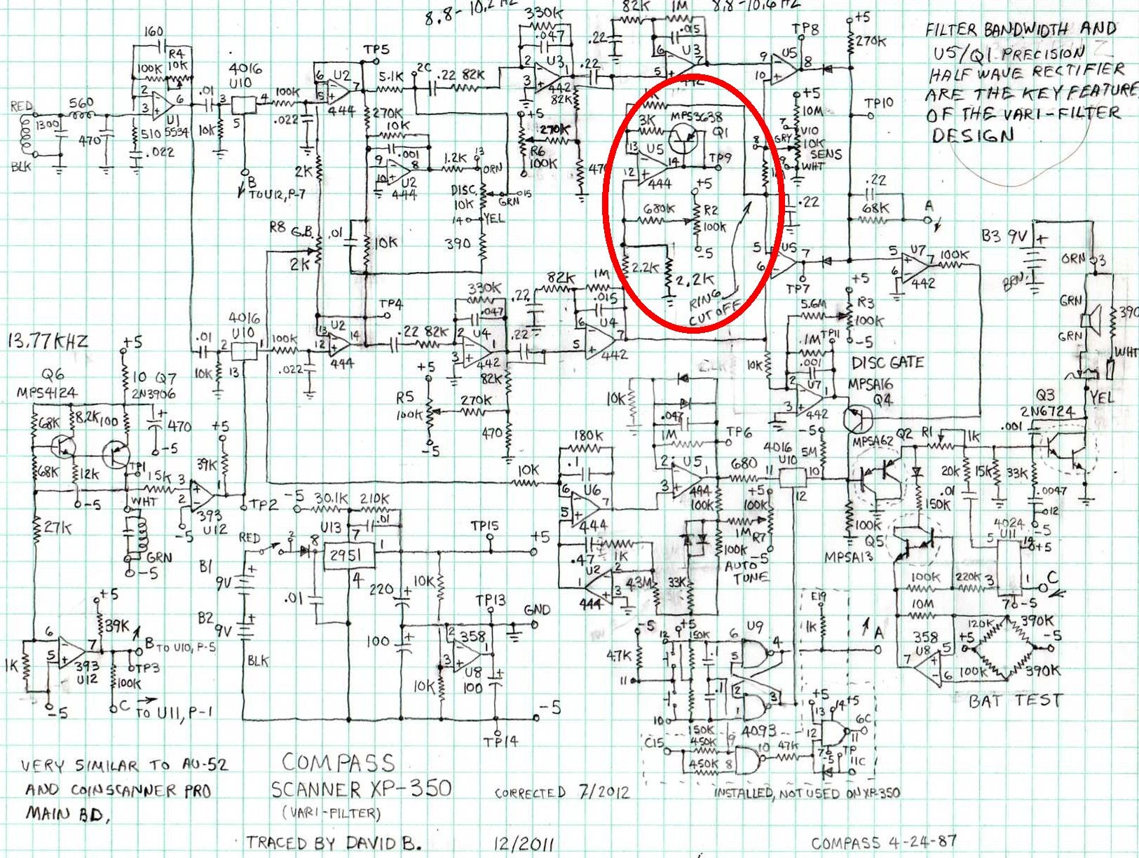

            I suppose it is this part of the circuit:
Name:	XP-350 ring cut-off.jpg
            Although I don't see how they can call it "proprietary"​

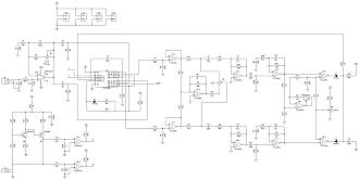

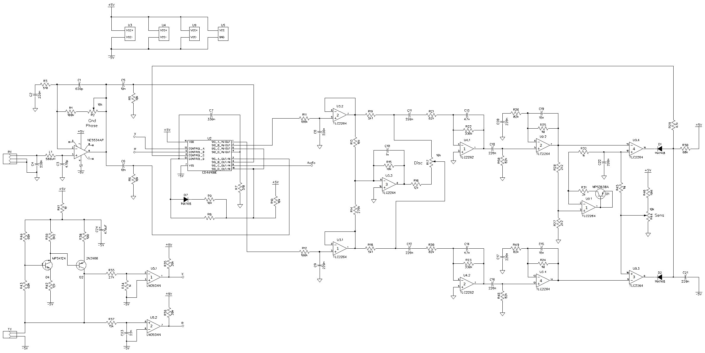

              I want to eliminate those offset trimmers. So I drew up a revamped circuit based on the liberty 150 and the challenger schemes.
              I think a high precision op amp will be suitable, like the TLC2262,2264 or similar one with very small input offset voltage characteristic.
              Any suggestions/ideas on how to eliminate the trimmers??
              Click image for larger version  Name:	liberty.jpg Views:	0 Size:	232.6 KB ID:	430368
              There are 2 extra switches available, so one switch is used to generate the audio frequency for the audio section and the second is used to pass it through to the audio amplifier as is done in the liberty 150 circuit. Clever.
              I left out the pinpoint circuitry.
                Here is the Diptrace file. I want to try to make a single layer board for the circuit. I was never any good at manipulating such software for single layer. The power supply and audio amp goes on a smaller board.
