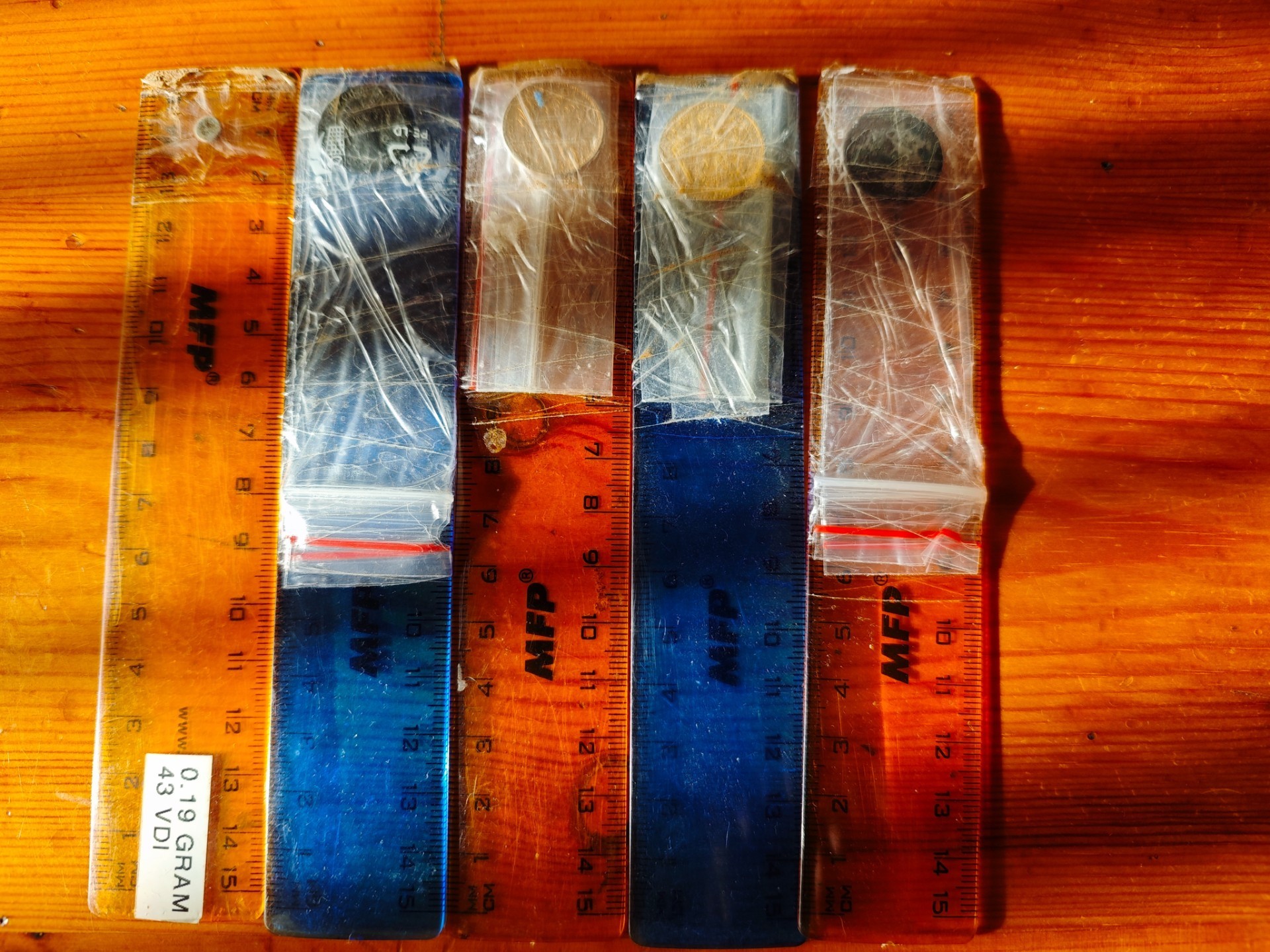

    Click image for larger version  Name:	IMG_20241217_112649.jpg Views:	0 Size:	674.4 KB ID:	431683Digga..first of all you need to ask yourself...at what depth did you find the coin-sized targets..let's say 2 centimeters in size..?
    If you have really light terrain..the detection range of powerful modern detectors on 11"-13" coils should be really large..
    detection of such a target is possible at a depth of 40cm and more..
    Here it also depends on what target you are looking for..very low conductive ..low-conductive, medium-conductive,, or high-conductive?..coin size?. Because the working frequency of the detector can have a certain degree of significant influence on the detection range..
    Light terrain allows..for:
    1...use high detector settings which have a great influence on the detection range..
    2..light terrain attenuates the signal very little...and in the optimal case you can get such a detection range on the target..very similar to the range on the target in AIRTEST..
    in AIRTEST..
    it should look something like this..like in my testing...
    Terain test:
    https://www.youtube.com/shorts/cxZsC4gv3gQ
    AIR TEST:
    I am only giving these tests as an example...​​
    In airtest I use coins of the same size but different conductivity to find out the sensitivity and range of a given detector and coil frequency.. on targets of different conductivity...
