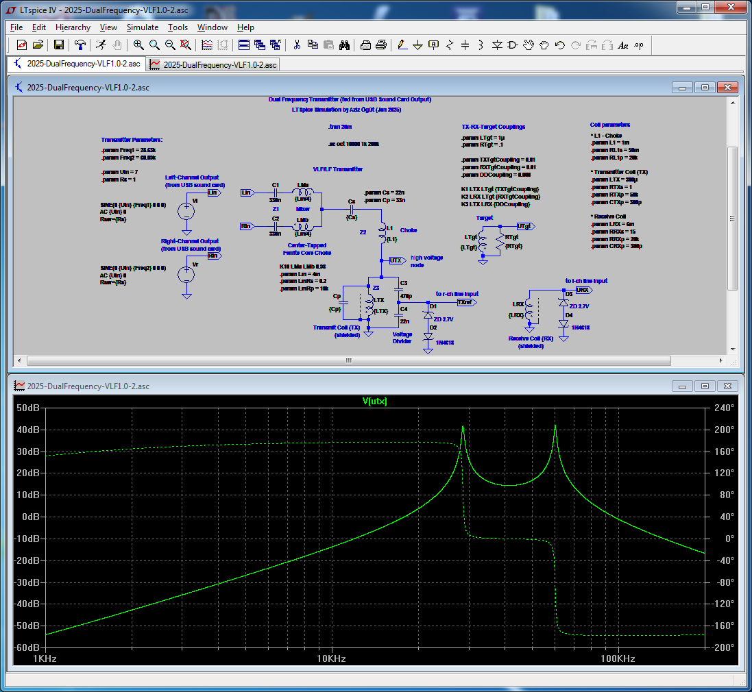

            • Hi all,
              this is a preliminary version of the dual frequency VLF/LF transmitter for Tablet PC + external USB sound card solution. I may reduce the output power for the final version. This is, what is easily possible with the G6 headphone output. You can reduce the TX coil current by reducing the coupling capacitors C1 and C2. The resonant frequencies are defined by Cs, L1 and Cp, LTX. C3/C4 is a capacitive voltage divider to get the TX reference voltage down to reasonable voltage levels for line input of the sound card. C3/C4 has low frequency determining effect to the resonant frequencies. Use zener diodes (D1 .. D4) to clamp the high voltage level to protect the line input of the sound card. Below is the spice simulation file for your convenience. And some pics.
              The dual frequency VLF/LF transmitter schematics:
              Click image for larger version  Name:	DualFrequency-VLF-LF-Transmitter.png Views:	0 Size:	146.8 KB ID:	433587
              Click image for larger version  Name:	DualFrequency-VLF-LF-FrequencyResponse.png Views:	0 Size:	103.8 KB ID:	433588
              That's all for now.
              Aziz

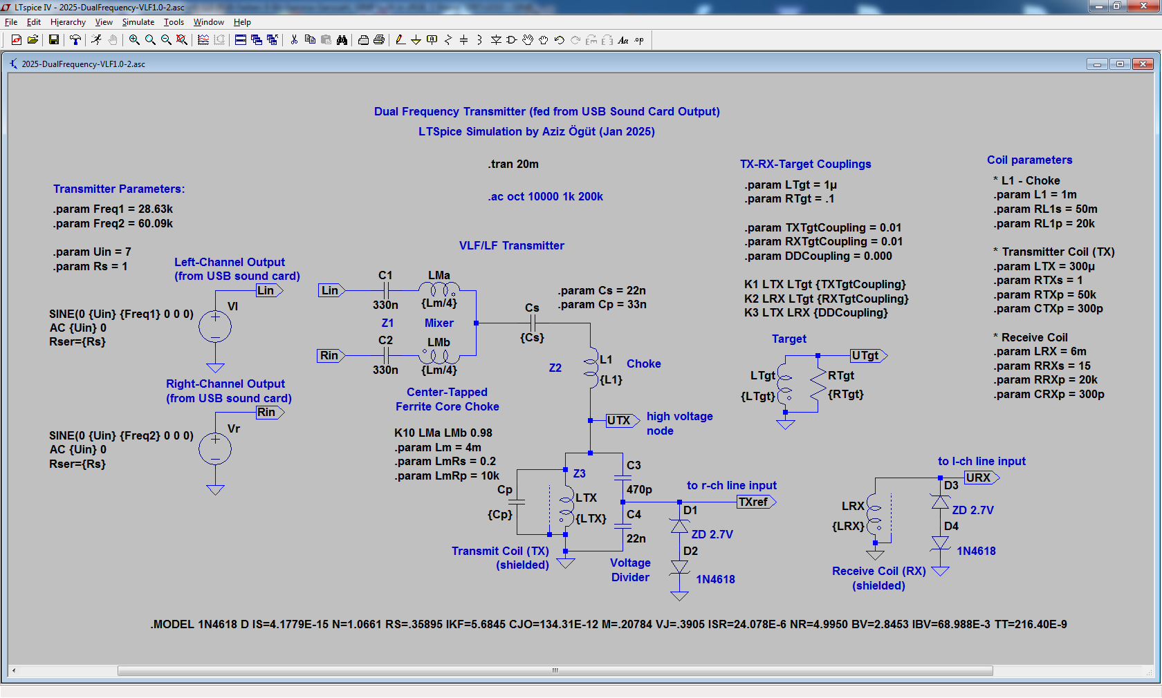

                  • Hi all,
                    lets reduce the transmitter power a bit and make things much easier (and low cost). We are leaving the inductive mixer (the mixer choke Lm) and duing the mixing pure capacitive. Reducing the coupling capacitors so the external usb sound card gets not too hot. We really don't need much power to the TX. It is still enough power.
                    See what happens in the following schematics.
                    The TX-coil voltage is still swinging between +50 and -50 V.
                    And we don't need the mixer choke.
                    The capacitive voltage divider must be adapted (increase or lower C4) to get the TX-reference voltage into the reasonable range. In this case, we have to decrease it to 10 nF to be in range of +2.5/-2.5 V.

                        • Hi all,
                          how to calculate the resonant frequencies f1 and f2 of our dual frequency transmitter?
                          That's really a good question. I don't know. It is quite complex. Yeah, you need complex math as we have lot's of complex resistors Z there. In series and in parallel. All mixed together.
                          Best way is tweaking Cs and Cp for given L1 and LTX inductances. In spice simulations using ".step param list" command for instance. Spice simulations are making it really easy for us.
                          For fine tweaking the frequencies in the real circuit add a small capacitor (470pF- 1nF) parallel to Cs and/or Cp to move the resonant frequency to the center of the bin-frequency. Depending on which is tweaked, it affects one frequency more than the other.
                          Best seen in the spice simulations.
                          Note, that the coupling capacitors C1 and C2 and the capacitive voltage divider caps C3, C4 will also have little effect to the resonant frequencies.
                          Aziz
