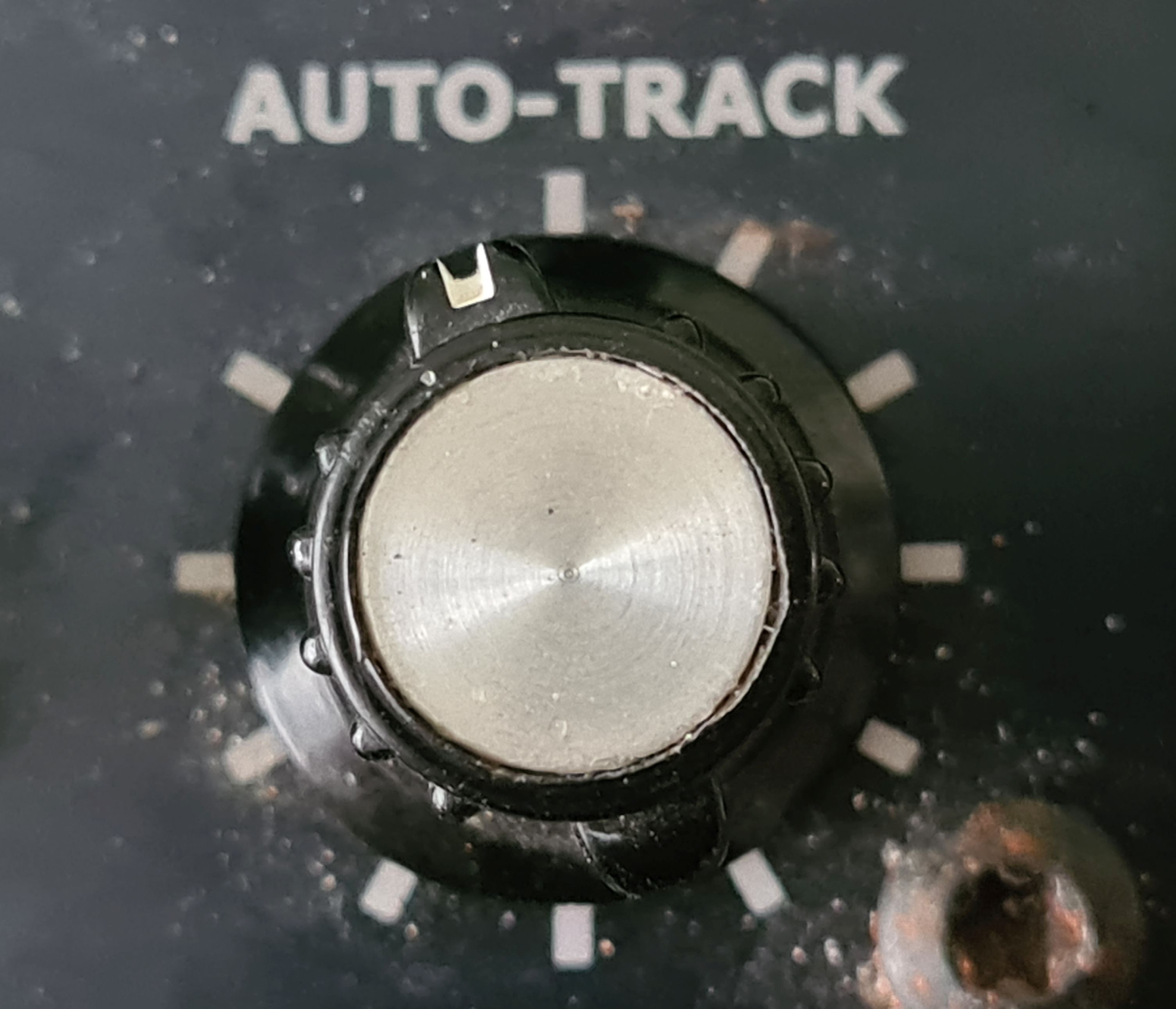

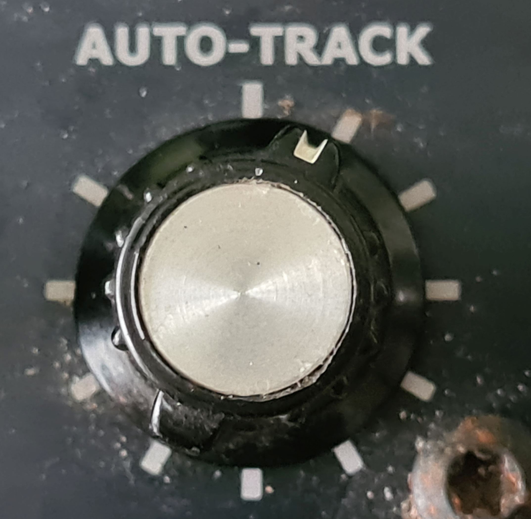

        Does the knob have an off/on? When the knob is turned fully anticlockwise there seems to be a little resistance between the two points in the pictures, samely, when moving from fully anticlockwise clockwise there is again a feeling of an off-on occuring.
        If it is an off/on should I use the detector in fully anticlockwise (off), or just past point of resistance (on) as in picture 2? Or turn the knob to somewhere else?
        I would say that the beaches I detect are quite flat.
        Thanks in anticipation.

          yes, the auto-track poti of the Crossbow Classic has an on/off switch.
            The Auto-Track (SAT) control does not have an on/off switch. There is a Static/Dynamic switch on the rear panel which changes the setting between slow and fast modes.
            AUTO-TRACK
            In association with the STATIC / DYNAMIC switch on the rear panel, the AUTO-
            TRACK control adjusts how fast the detector tracks the threshold level. Slowest
            tracking occurs with the control at minimum (fully anti-clockwise) and conversely
            the fastest tracking occurs when it is set to maximum. Initially try setting the AUTO-
            TRACK control to about 7 o'clock. This provides good separation between targets
            while allowing the coil to be swept back and forth at a reasonable speed. Again, you
            should experiment to see what works best for you.​
