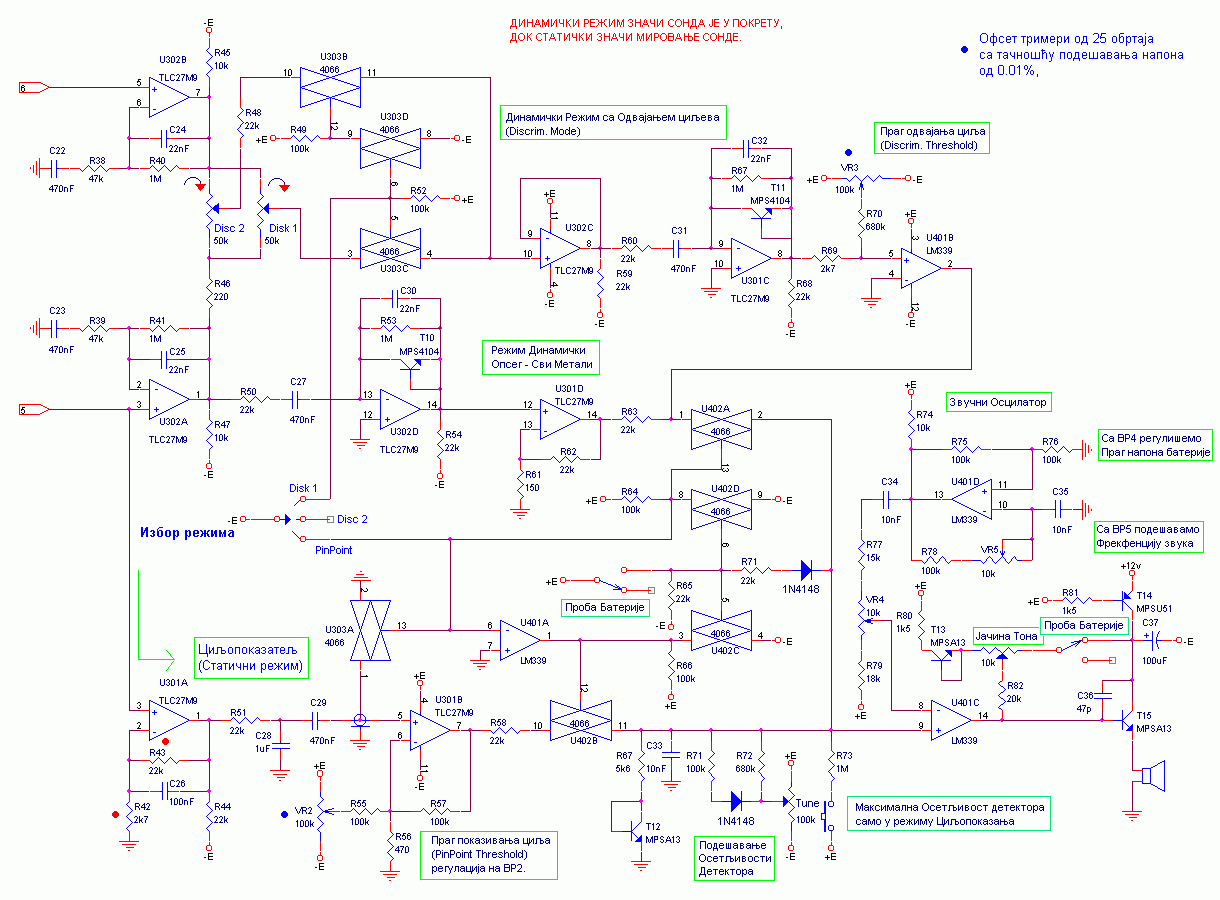

    thank you much Ivconic. yes, i forgot Protel 99 is popular among russians.
      those files in serbian and this is sure ORCAD. i think there has to exist PCB file anywhere.
        Yes it is Serbian.
        Those are just basic explanations on what stage does what.
          can anybody say what CAD was used to do the PCB file?
          TIA
          Look here on this page: http://md4u.ru/viewtopic.php?f=63&t=1291&start=0
          Here the same is given in Sprint layout files​

            thank you. really do not like SP... no checking, made for the pirates. i do not have access to attachments in MD4U, pan Zak-Zakrževski disconnected attachments for unregistered.
            i had banned by him because i 'sell boards for prices of gold plates'. anotherway i must gift my hard job for free.
              I have access and here I downloaded the file.

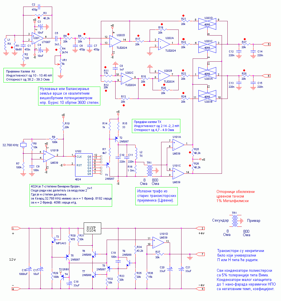

                  The 1266 would make a nice project. The transformer for the demodulator can be purchase fom Mouser maybe others for about $2.I don't know which one the 1266 uses, but here is what's available..
                  add: It uses 8ohm to 800ohm so it would be the 42TL008-RC
                          Yes ,it would make a nice project. The transformer is no longer a big deal.
                            Also, the crystal oscillator would need a replacement. Unless that crystal can be located? These two things have also held back people from building the goldbug and 1280x
