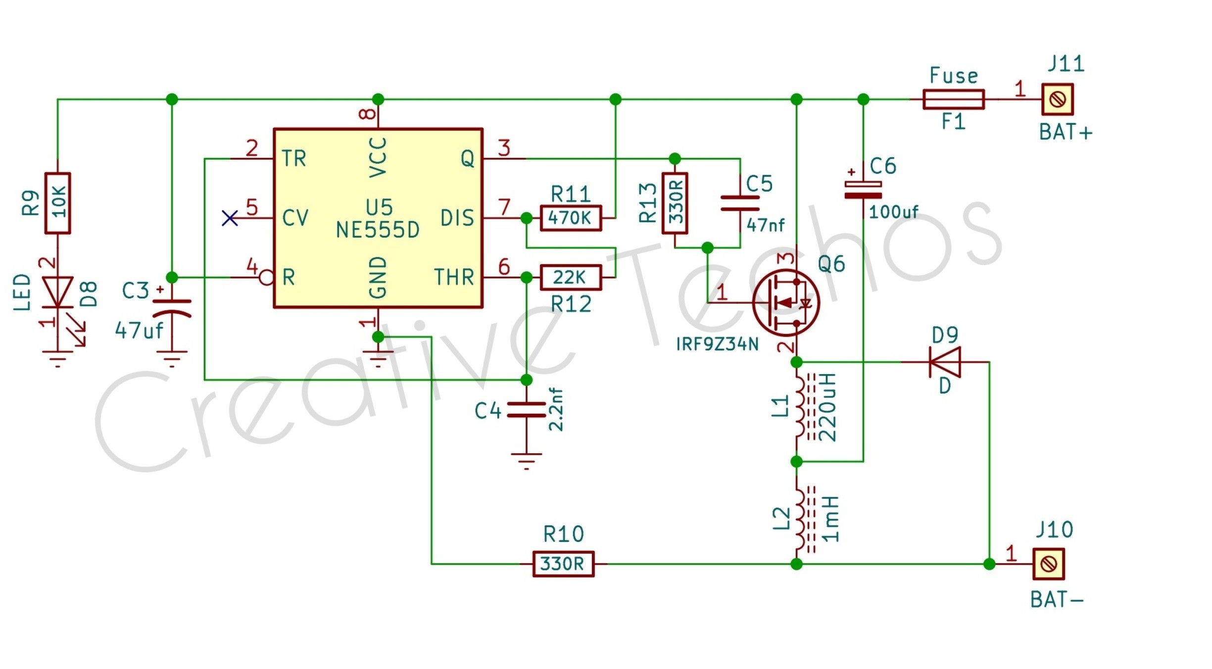

    need help design pcb for this schematics
    because i don't understandClick image for larger version  Name:	Schematic Circuit Diagram_.jpg Views:	0 Size:	242.8 KB ID:	435184 understand
    What is the footprint, pin spacing and pin hole width for L1 and L2?
    Also; what is the battery voltage?
    Also; The IRF9Z34N is a P-channel mosfet and on your schematic is the symbol for an N-channel mosfet:

      i have lost my skill draw the pcb bro because long time not use
        You didn't understand, I'm asking you specifically about the L1 and L2 data as well as the mosfet because I might have time to draw you a pcb.
          sorry bro miscommunication
          The Battery voltage is 12v
          the detail for
          L1 and L2 is same size in this link i dont know where to check the size
          https://my.element14.com/bourns/78f1...kaAkzhEALw_wcB

            maybe this is same shemathic
              Click image for larger version  Name:	PCB.jpg Views:	0 Size:	160.6 KB ID:	435200​
                Second one is different in two details, 10nF at pin 5. and zener diode:
                Click image for larger version  Name:	PCB2.jpg Views:	0 Size:	173.9 KB ID:	435203

                    This is Lead acid desulfator
                    this devices can maintain the lead acid battery and extend the battery long life
