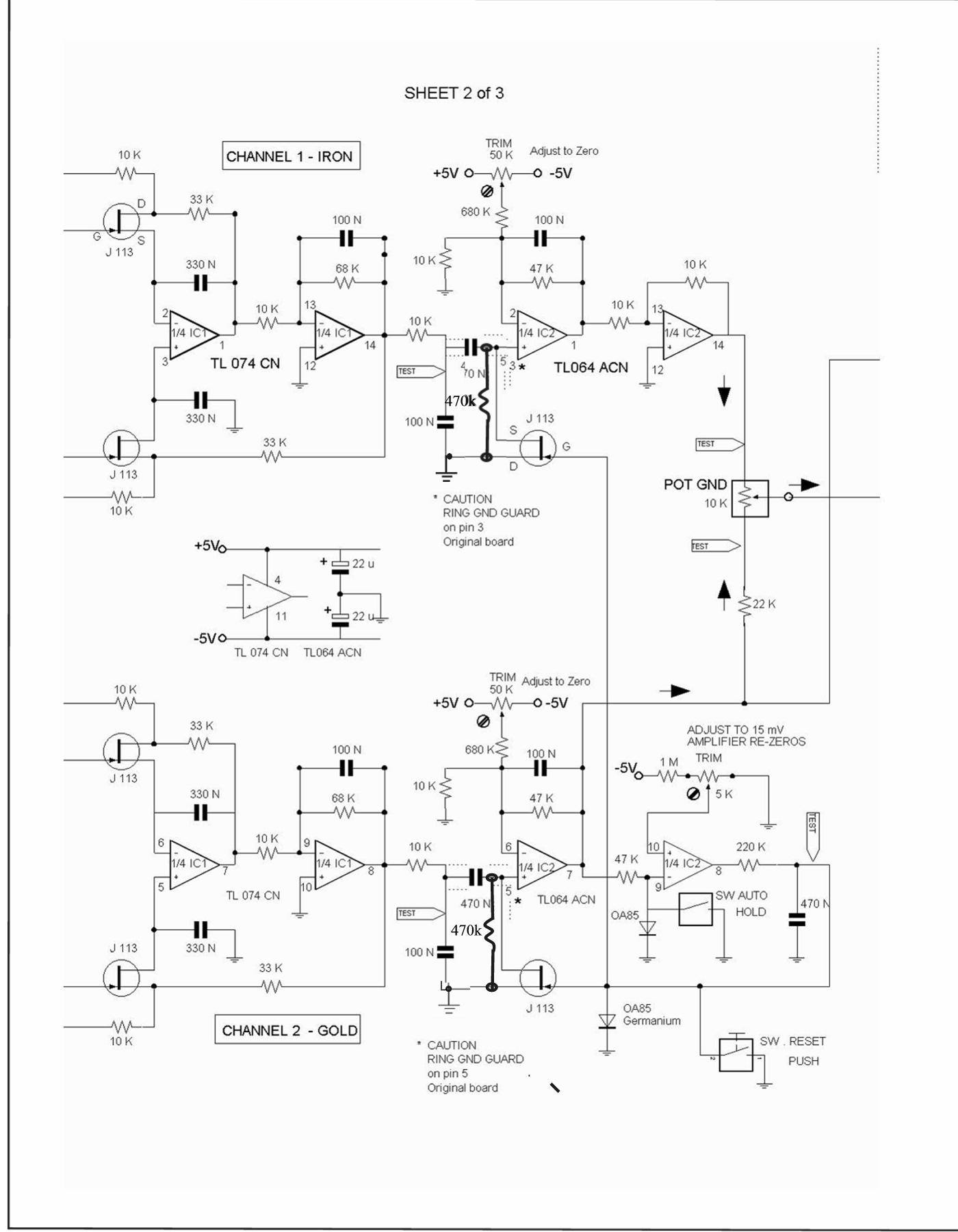

            Now, there area a couple of minor changes that should be made to the schematic. On sheet 2, there are two J113's that need a ground. Each one is below a 1/4 of IC 2 and have a 100nf connected to the D connection. The D and the bottom of the 100nf should be connected to ground on each of the two FET's. Also, a 470K should be connected across the D and S of the FET's. This creates the autotune. You can change the value of the resistor to larger or smaller depending upon how fast you want the circuit to retune. However, you should keep the two resistor values equal if you do change them.
            I have attached part of the schematic showing the grounds and resistor. Sorry about the sloppy additions but the program I used doesn't work well.

              and thanks for the hints. I've noticed that there was something wrong, I mean the two fets connections that perform the reset of the middle stage earlier in other posts also but never seen before the autotune resistors mod. I see that the reset is simply obtained switching the 470nF capacitors to ground and so virtually eliminating any potential on the op amps inputs relative to gnd. The autotune feature (thank you) is really interesting for me : that mean one haven't to manually retune or reset the circuit when a peak occurred in the input and the op amp saturate and the detector will become a non-motion type ? It is right ?
              Best regards,
              Max

                  Hi Max,
                  Yes, the Goldscan will become a motion type detector. Now, if you want a non motion, just add a switch in series with the resistors I show on the schematic so the resistor circuit can be opened. This way, you could have either a motion or a non motion detector.
                  If the resistor circuit is opened, the detector will drift so the pushbutton labeled switch auto hold will be needed to retune back to the original threshold. Now, this pushbutton (pb) switch is labeled incorrectly. It switches from non motion to a very fast retune and is needed to adjust the various pots both before and after the pb. As an example, the two pots, one for each half of IC 2 are to be adjusted for zero out of the amp. By holding down the fast retune button, external signals are eliminated and the adjustment is much easier.
                  Reg

                    Hi Reg,
                    this morning I've finished to mount the "sheet 2 of 3" part of the circuit on a protoboard
                    with soldered joints and ic sockets just to see what happens. Has one can expect from the
                    schematics considerations I've got two opposite signals at out pins 7 and 14 of IC2 due to the
                    symmetry in the configuration of the two channels. That's fine. I pushed down the "reset"
                    labeled pb and see on my scope the two signals convergence, then I just set the two 50K
                    (IC2 diff integrators offsets, right ?) trimmers to find the overlapping position that
                    cancels out any residual asymmetry (well not at all but most of I think).
                    About the "sw auto hold" labeled part (1/4 IC2, switch, 470nF capacitor etc) (please correct if
                    what I suppose is wrong):
                    1. the labeled "sw auto hold" seems in the posted schematic a normal switch (I mean 2 stable positions)
                    but in real (commercial) goldscan IV units it is a push button (?) and serves only for tuning back
                    to the original threshold in a quick and reliable manner after performing a reset operation
                    2. it seems to be working like this (I'm not sure anyway :
                    - when the "sw auto hold" labeled is open then the amplifier provides a strong negative feedback
                    to stabilize the two sections of diff integrators mantaining outputs levels near gnd and so avoiding
                    saturation on these stages, doing so with a tank capacitor (470NF) that holds a control
                    voltage (vgs) limited in range from gnd to (about) -0.3 volt (forward voltage on germanium type diode)
                    (J113 has a Vgs cutoff of -0.5 volt minimum --> so, after transients, it works in linear zone acting as
                    a voltage controlled hi value resistor, maybe of some megaohms thus resulting in a non-motion behaviour
                    ,but I think here imbalance can be introduced by temperature related drifts and leaks in some time)
                    - when the "sw auto hold" labeled is pushed, thus connecting pin 9 of IC2 to gnd, then we have an
                    offset voltage (negative - schematic say --> 15mv in absolute value but do not indicate the test point -
                    is it on the middle of the trimmer or at output of the amplifier ? I think is on pin 10) on the output, depending on
                    the trimmer regulation, that gives a stable vgs polarization of the 2 fets (J113) stored in 470nF capacitor
                    resulting in more conduction (Rdson typ= 100ohm for a Vgs=0 volt in J113 and some hundred Kohms near pinch-off) and
                    a discharge path for input capacitors (470NF) --> so we have motion type detection and easy regulation;
                    when the pb is released negative feedback works again Rds increase in the megaohm(s) level and non-motion behaviour
                    is then restored.
                    So I think that the true difference between "reset" and "auto hold" labeled is only in their usefulness :
                    Maybe reset is used in lab regulation time (gnd balance nulling) and to fast reset huge input charges due to
                    target overloads instead of waiting that negative feedback do the work (could take many seconds I think).
                    The "auto hold" seems to me, like you wrote, best choice for accurate regulation of threshold in worse cases.
                    If it is true (I never used a commercial goldscan before and don't Know) it'll possible to do regulation using
                    only reset push button, but with less accurancy.
                    Best regards,
                    Max
                      Hi Max,
                      I've finished GS4.I remove the resistors to get non-motion mode. Because the sensitive is very weak at motion mode.
                      Now my big problem is the detector will drift.i must push the "reset" button often to get quiet.
                      I think the problem is the "switch auto hold" can'nt work well.May be the schematic incorrect.Because the "switch auto hold" is use to prevent the amp saturate and can't avoid the drift.
                      Do you know the voltage on IC1 8 pin and IC1 14 pin? positive or negative? I measure both of them are positive. Am i right? and may be the problem is there.If

                        the 4 and 8 of U1 must stay at GND: gnd is the positive rail that goes to the positive lead of battery.
                        The drift doens't probably depends of U1... U1 is there just to provide the clock for voltage converter / charge pump.
                        You have to check Mosfet and damping resistor, often drift depends on one of them or both.
                        Also, some components could have high temperature coeff. and thus giving a big variation in signals cause of temperature changes.
                        On my GS4 the drift exist but is very few... I have to retune every 7-10 minutes in hot climate conditions... 12-15 when cold.
                        The original sold unit, as I know, is about the same : user must retune threshold from time to time when no SAT enabled. This is due expecially to the very high gain there and use of old, drifty components.
                        If you instead hear the tone change within seconds or in a minute... there must be some problem in your PCB / components.
                        Also...the Mosfet usually doesn't require an heatsink... cause of the low RDSon and duty-factor but sometimes adding one make things stabilize easy and for longer. You can try.

                          Hi Max
                          Sorry my bad expression.I mean 14 and 8 of "IC1" is on the Reg attached image on this thread.In you schematic it's 14 and 8 of "U10".
                          Yes,if the temperature changes,my GS4 give a sharp beep.I still think my
                          "SAT" not work, so i need to know the the voltage on 14 and 8 of "U10".

                            ok, now I understand. It's something near gnd level , the positive lead of battery level. Small deviations there of few hundreds mV are tolerable.
                            If you read about the positive voltage you're on the right way.
                            I don't remember much of GS4 tuning... but I think a good value is around 50-100mV there respect to gnd.
