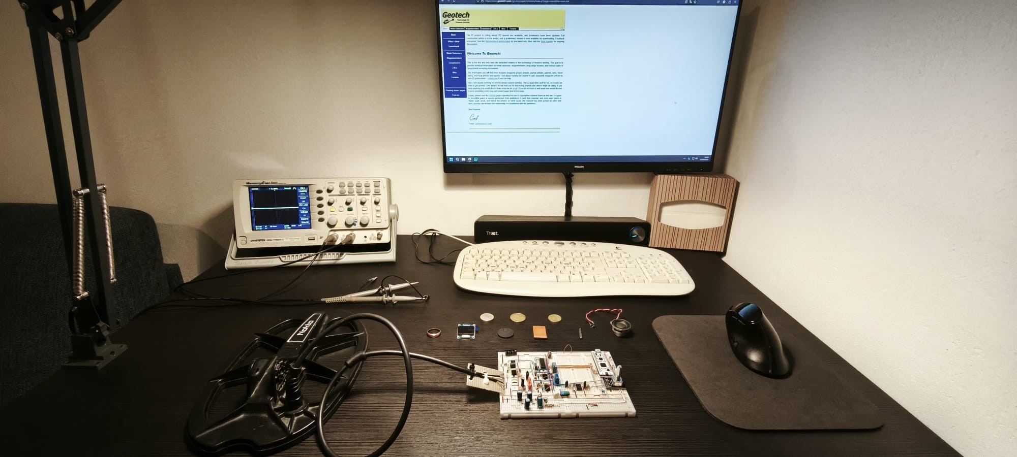

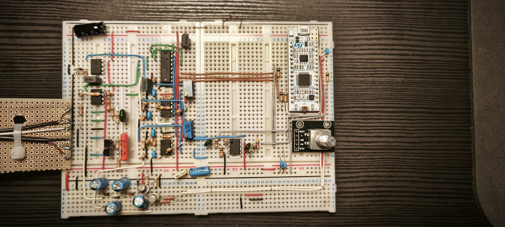

    I would like to share the progress I’ve made on my metal detector project so far. The analog front-end is largely the same as the VLF DISC design of the ITMD3, but there is a strong digital electronics component. The adaptation to the TX frequency, demodulator clock generation, tone generation, parameter settings, and data acquisition (12-bit resolution) are all managed by an STM32F303K8 running at 64 MHz. It uses a Nokta IM28 coil.

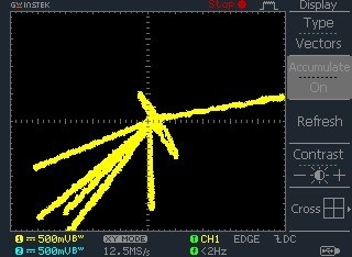

    As you can see, everything is still on a breadboard, but it works quite well. The noise on the demodulator lines is ±25 mV—which I know is a lot—but it's a good starting point. Please take a look at the attached XY chart. It shows the signal produced by different targets when lowered near the coil.
    Detection starts at about 18 cm for a ring and 25 cm for a large coin. The SSD1306 OLED display caused a vertical line, ferrite produced a line in the top-right quadrant, and a screwdriver tip created a loop—very interesting, but more importantly, very distinguishable! I didn’t think it would be this easy to discriminate between different targets.
    The output audio tone, however, turned out terribly—I initially thought my approach would help with discrimination, but it didn’t. I plan to implement a tone that changes based on the slope of the received signals.
    All STM32 programming was done using Keil IDE with direct register manipulation for timers, GPIO, ADC, etc. There’s a lot of optimization to be done, but I’ll get there step by step. I plan to design a PCB that includes everything except the microcontroller so that different ones can be used as needed, making modifications easier.
    I know there's still a lot to explain and much more to do, but since today I heard a tone from it for the first time, I just couldn't contain my excitement! If you have any questions, I’ll be more than happy to answer.
    In the meantime, I plan to upload everything to a GitHub repository so the material will be accessible to everyone—but it will take a few days.
    All updates and tests will be posted in this thread. I hope you’ll find them useful!

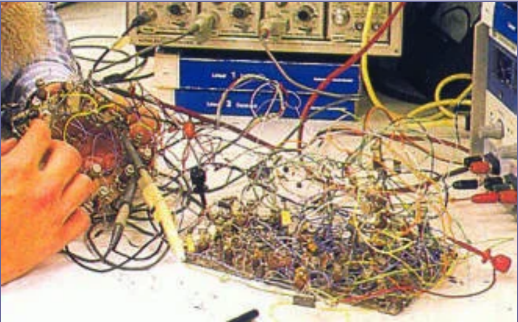

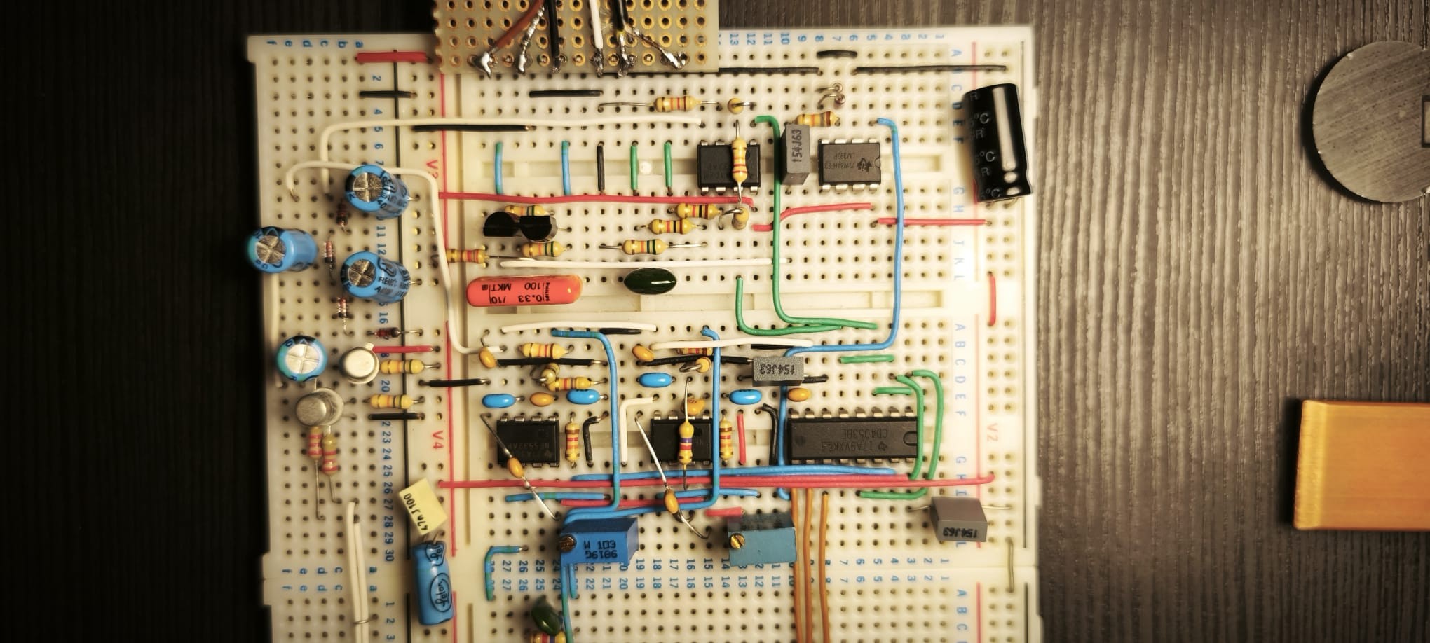

      Excellent! Your breadboarding is a work of art, easy to follow & troubleshoot. Unlike what Bob Pease used to make.

        Thank you very much!

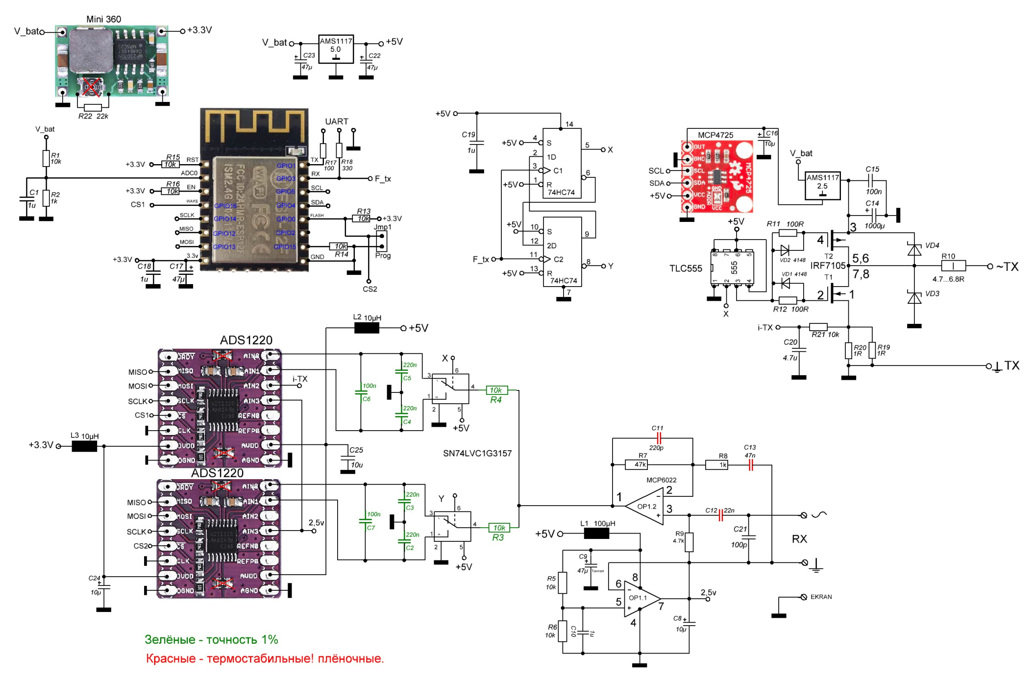

        The breadboard tidyness is a must for me, otherwise fixing bugs or changing components would be impossible. Next things to do:
        1. Generate a decent audio tone;
        2. Test on ground. I am afraid the ground signal might saturate some amp stage or the demodulators, so maybe I will need to tweak some gains;
        3. Use the STM32 DAC to give signals some offset that is now implemented using potentiometers, making everithing settable by the encoder.
        The encoder can now only change the phase of the demodulator clock in order to implement ground balance.
        Updates will follow!
          In the meantime, here's the schematic. Each block is described
            Very nice work. The breadboard layout is superb.

              But I guess you are refering to the one with the scope in XY mode?

                      This picture gives a good idea for a youtube channel called "Breadboard circuits" where breadboard layouts are pictured for a whole range of popular circuits for experimenters and those learning electronics. But I imagine this has already been done.
                      Your layout is a really nice example.

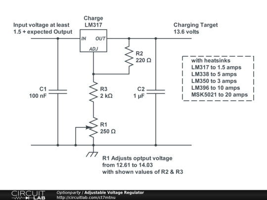

                        MCP4725 together with AMS1117 please explain how it works.
                          While it may look simpler to some extent, did you try to implement it phisically? I also started with a vert simple schematic that got complicated because of all the problem I found on the road.
                          To be fair, it is still getting more messy as more functions are implemented, that is part of the game
                            Having followed BP for years and done much "airware" circuitry myself I can tell you that what looks neat to the human eye is often suboptimal when it comes to critical systems with subtle capacitances and inductances etc.
                            Especially if you are researching new ideas ( for instance the invention of "feedback" in amplifiers and oscillators )
                            PCBs were only invented for fast manufacture .. not performance. ( see history ).
                              = Adjustable Voltage Regulator
