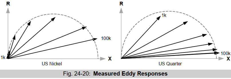

        When the frequency changes, iron behaves differently than normal eddy targets. Here are a couple of coins:

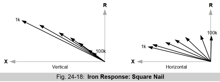

        and here is a nail:

        You can see that when the nail is vertical the magnetic response is always dominant, but when horizontal the eddy response can take over. You also see a very predictive movement of eddy responses along a semicircle that you don't get with nails; MF attempts to recognize these differences, whereas SF doesn't even have this information.
