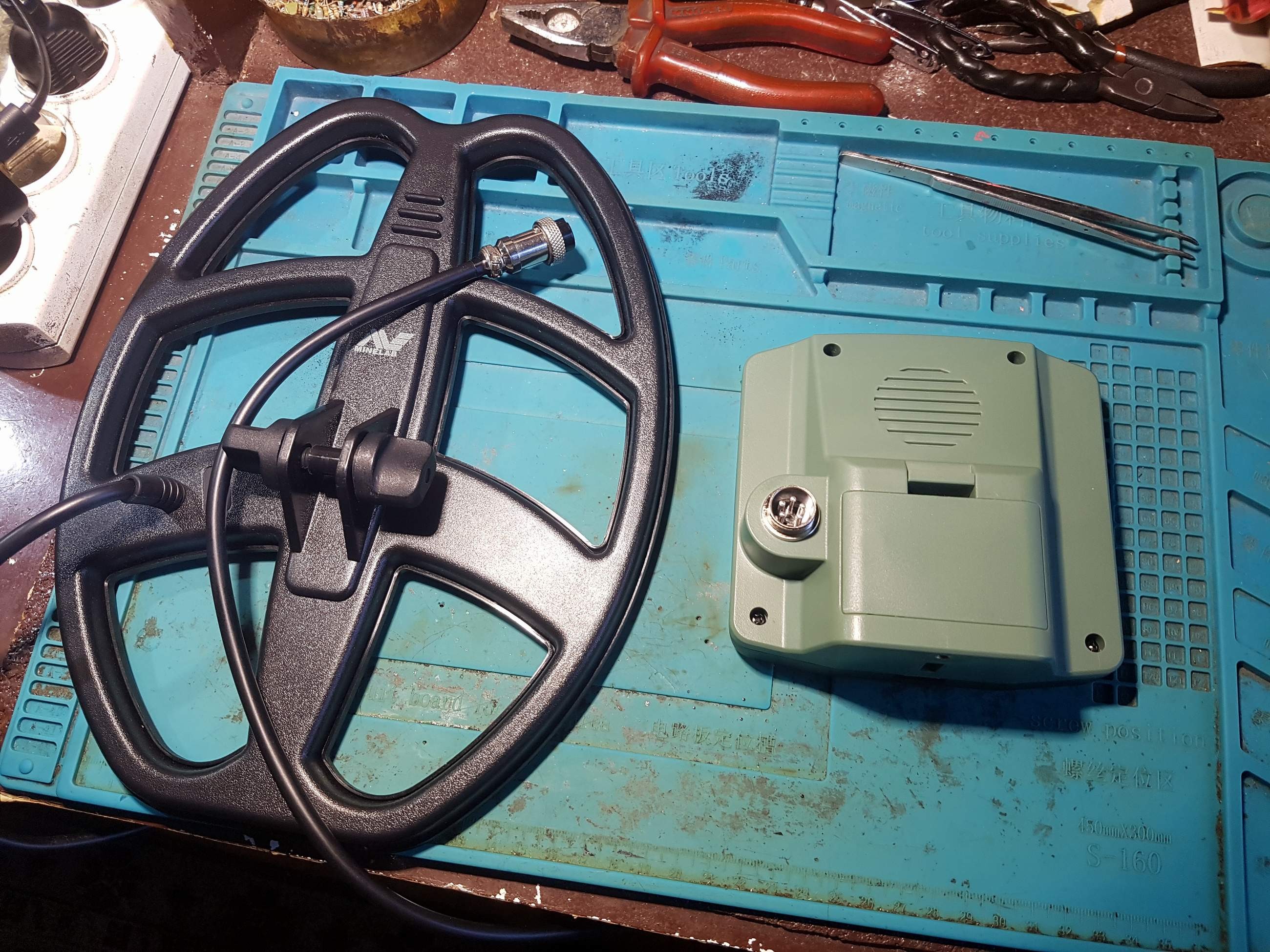

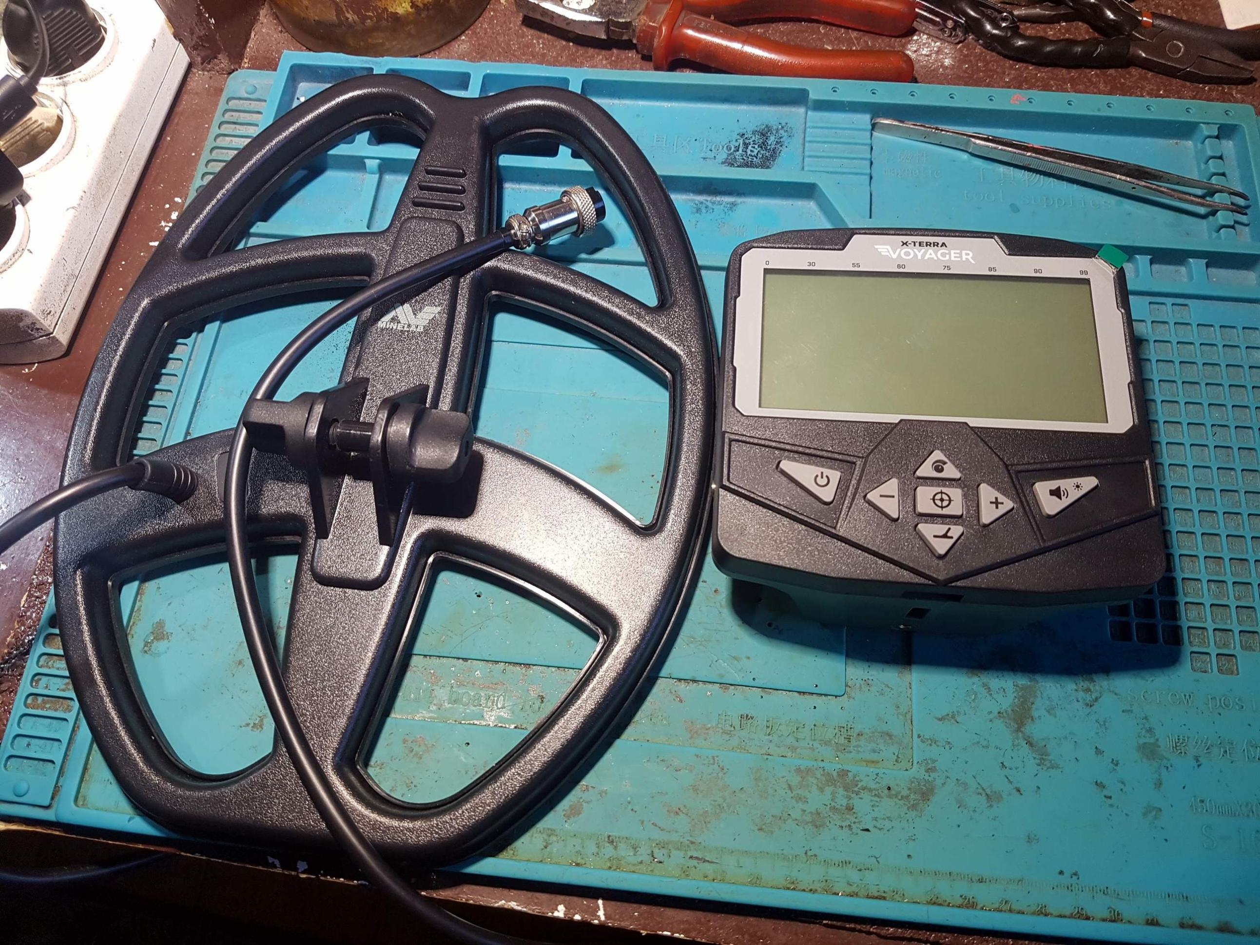

    A man from another town visited me and brought a Minelab X-Terra Voyager, new, just unpacked.
    The problem.
    When only the detector is turned on; detector works, all controls work, all buttons work, everything works normally.
    But when the coil is attached; the detector will not turn on.
    Also, when the coil is disconnected and the detector is turned on, if the coil is connected at that moment; the detector turns off immediately.
    A ten-minute visual inspection shows that it is a totally new, never-used detector. Nothing is irregular.

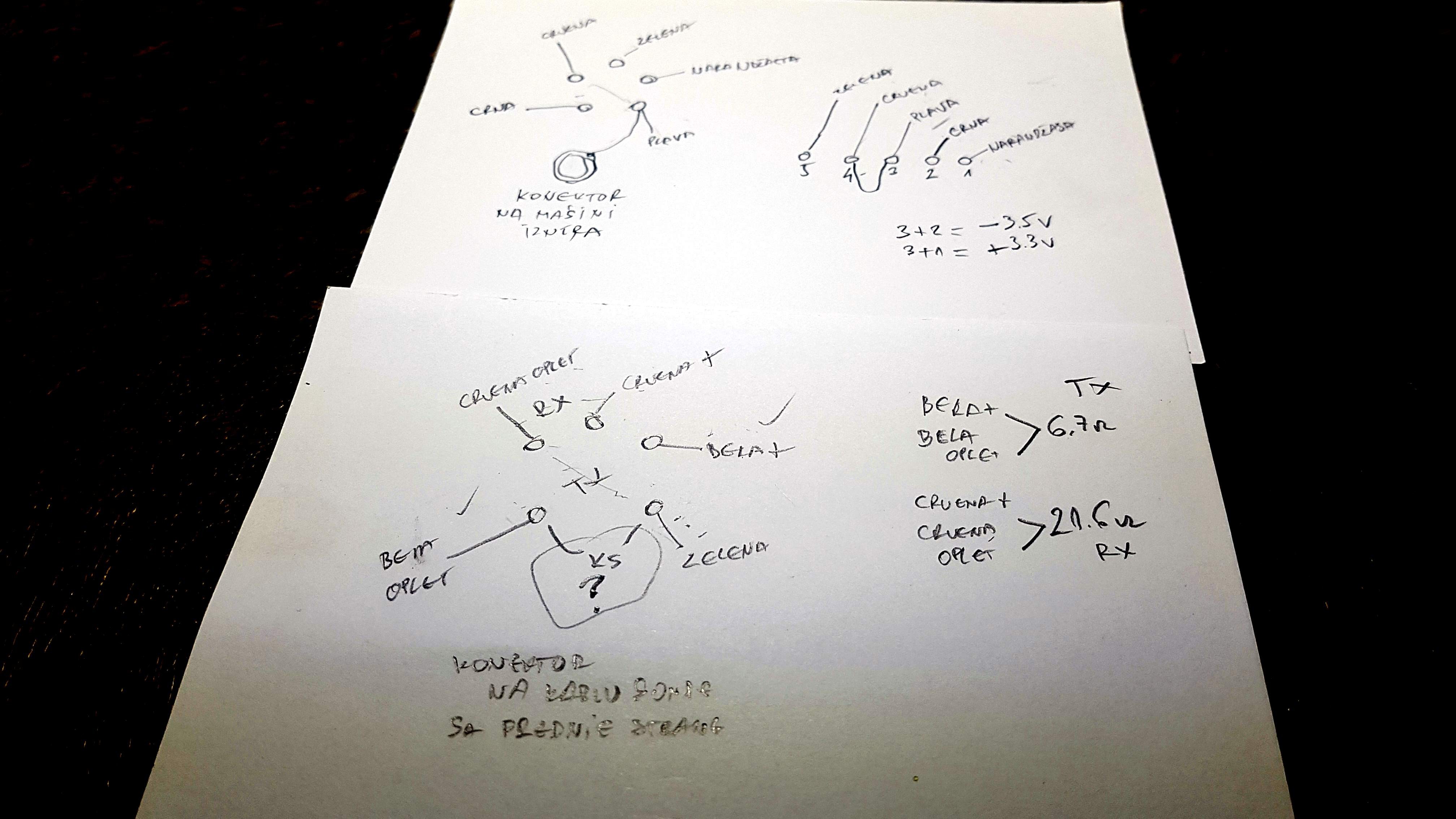

    I took an ohm meter, a beeper, two sheets of paper and began to draw the connection on the coil connector, then opened the detector, and drew everything around the coil connector on the detector box.
    In the attached photos you will see a picture of sheets of paper with my "scribbles".

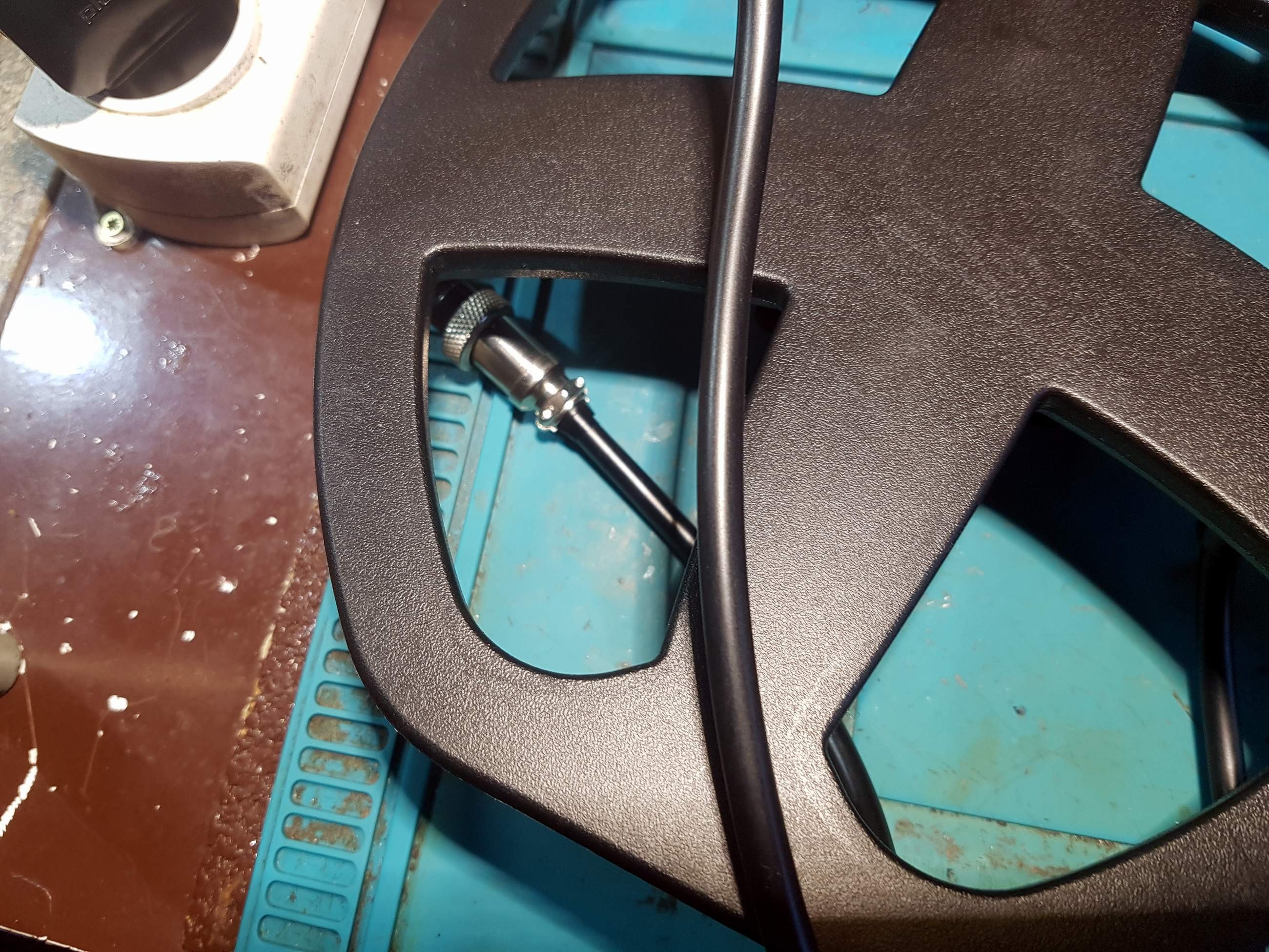

    After a thorough analysis of the wires and connections...I noticed that there is a green wire in the coil cable that has an unnatural short to one of the other wires in the cable.
    A desperate attempt, some would say "Solomon's solution"... or "how Alexander solved the Gordian knot problem"...
    I simply cut the green wire in the coil connector with a nail clipper and shorted and insulated it.
    I plug the coil into the detector, turn on the detector... everything works great!

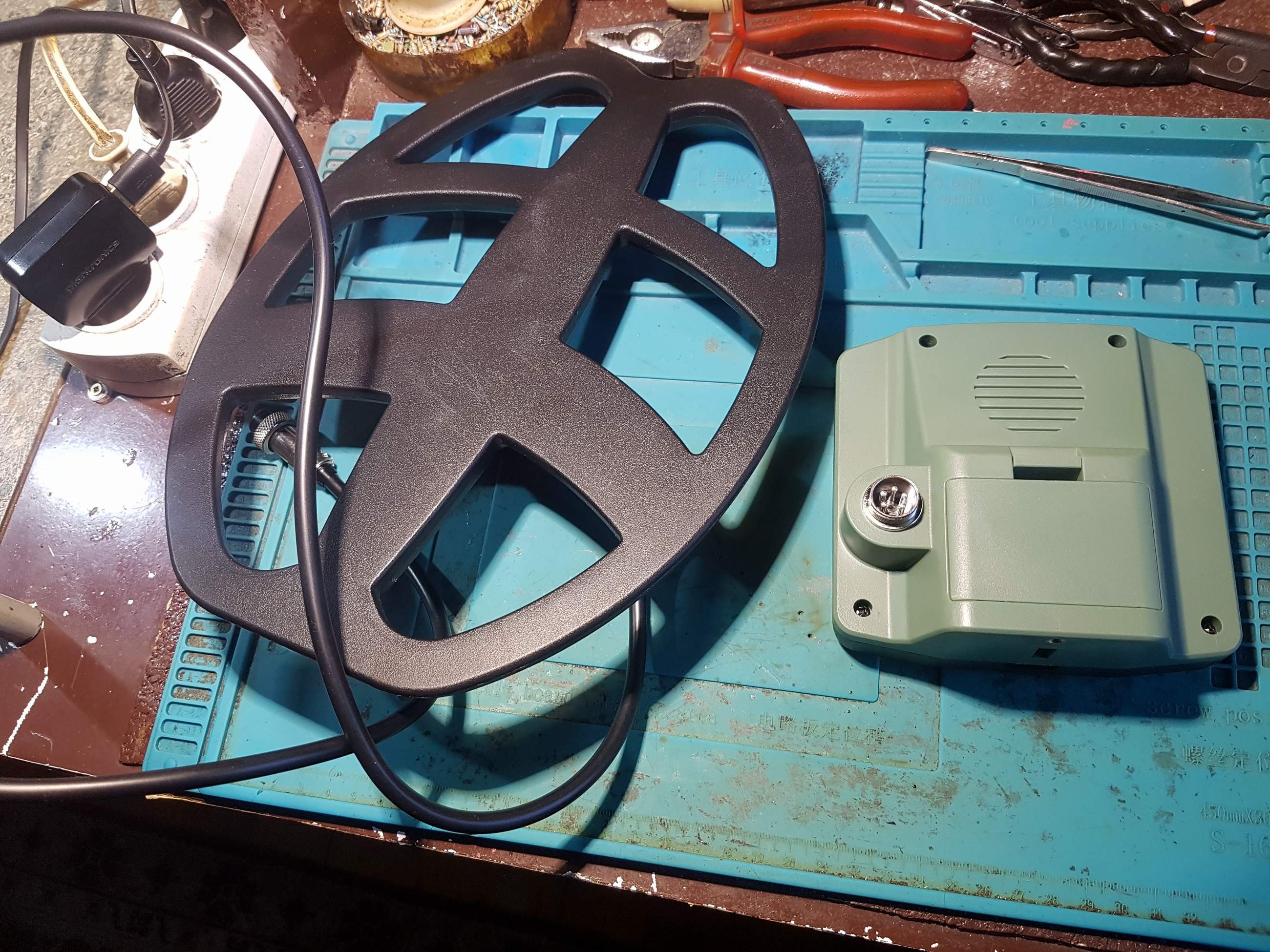

    There's something... the detector doesn't have the typical Minelab watermark sticker. There is no serial number sticker on the coil.
    The quality of the plastic seems to me (maybe I'm wrong) not to the level of Minelab quality.

      But I'm surprised that Minelab doesn't put a watermark sticker on the detector and a serial number sticker on the coil.
      It just doesn't look like them.
      As well as the catastrophic error in the coil connector... everything points to this series of detectors being manufactured by a third party.
