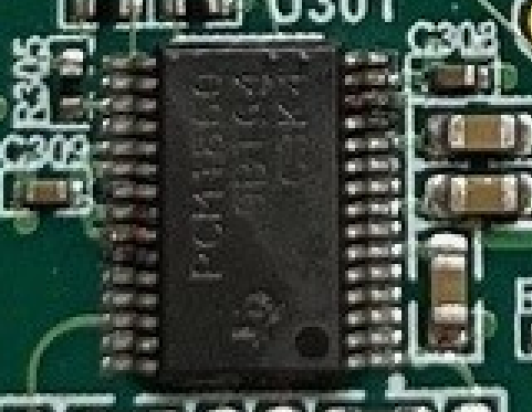

                  Regarding the measurements, I admit I'm not sure where to test; I tested to the best of my ability.
                  I had some doubts about the capacitor because it looks strange, see the photo.
                  But it looks fine.​

                        Anyway, the PCB has some clearly-labelled test-points on it, such as 'GND' and '3V2D' ( digital ) '3V2A' ( analogue), they may give something to probe.
                        There's also what appears to be a fuse, or poly-fuse, the green-coloured 'resistor' next to the 'RED' power pad. Maybe worth checking.

                            Maybe the photo is not enough resolution, maybe this is nothing... but with the available photo it seems to me that something is wrong with this chip. Some pins have turned a darker color, as if burned or overheated.
                            Pins 12, 13, 14... 23,24 and 25. Also... C308 is missing the left solder side...
                            Click image for larger version  Name:	image.png Views:	0 Size:	59.9 KB ID:	438193​
                              There seem to be traces of oxidation all over the board!
