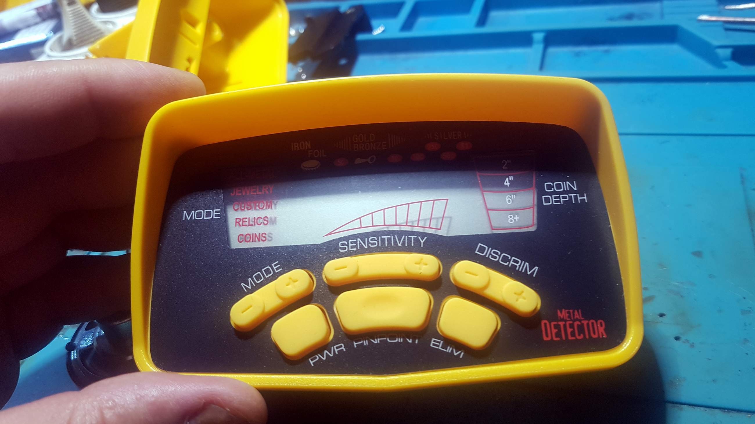

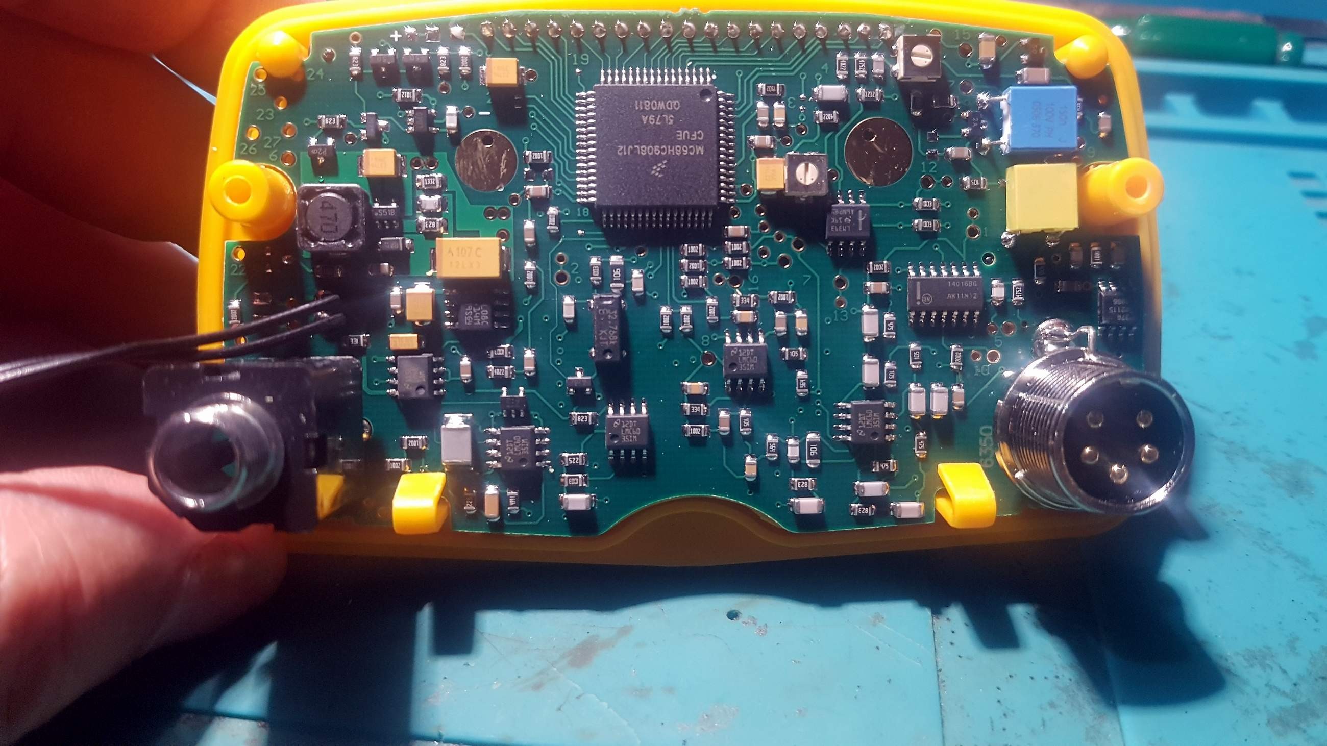

    For fun, I took a Chinese copy of the Garrett ACE 250, to check to what degree the Chinese managed to clone it.
    To my surprise, the copy is 99.99% the same as the original.
    And it works 100% the same.
    The only "flaw" is a very bad speaker that the Chinese put in their clone.
    I have an original speaker from the "EuroAce" model and immediately put it in a Chinese clone.
    From that moment it became impossible to recognize that it was a clone!
    I had a dozen ACE detectors, I have a couple of "burnt" pcbs, there are some parts.
    So I can compare. There is no difference.
    The work quality of this clone is EXCELLENT!
    The quality of workmanship and materials is about 95% at the level of the original.

      So the only drawback was a very bad speaker, which gave a quieter and vague "dirty" tone.
      Replacing the speaker changed everything, now it works 100% the same as the original.

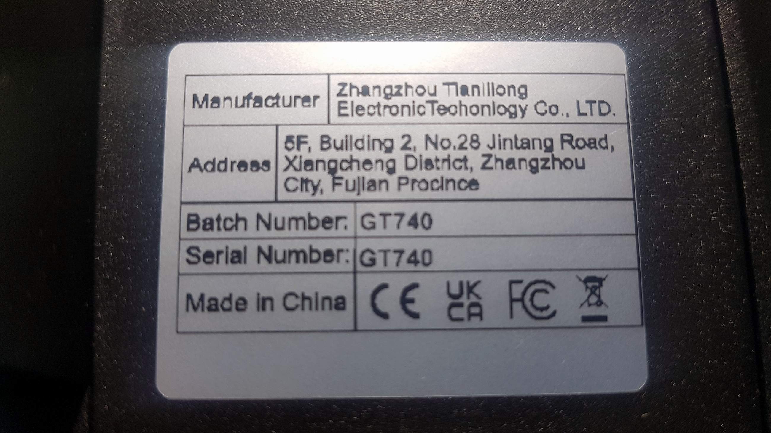

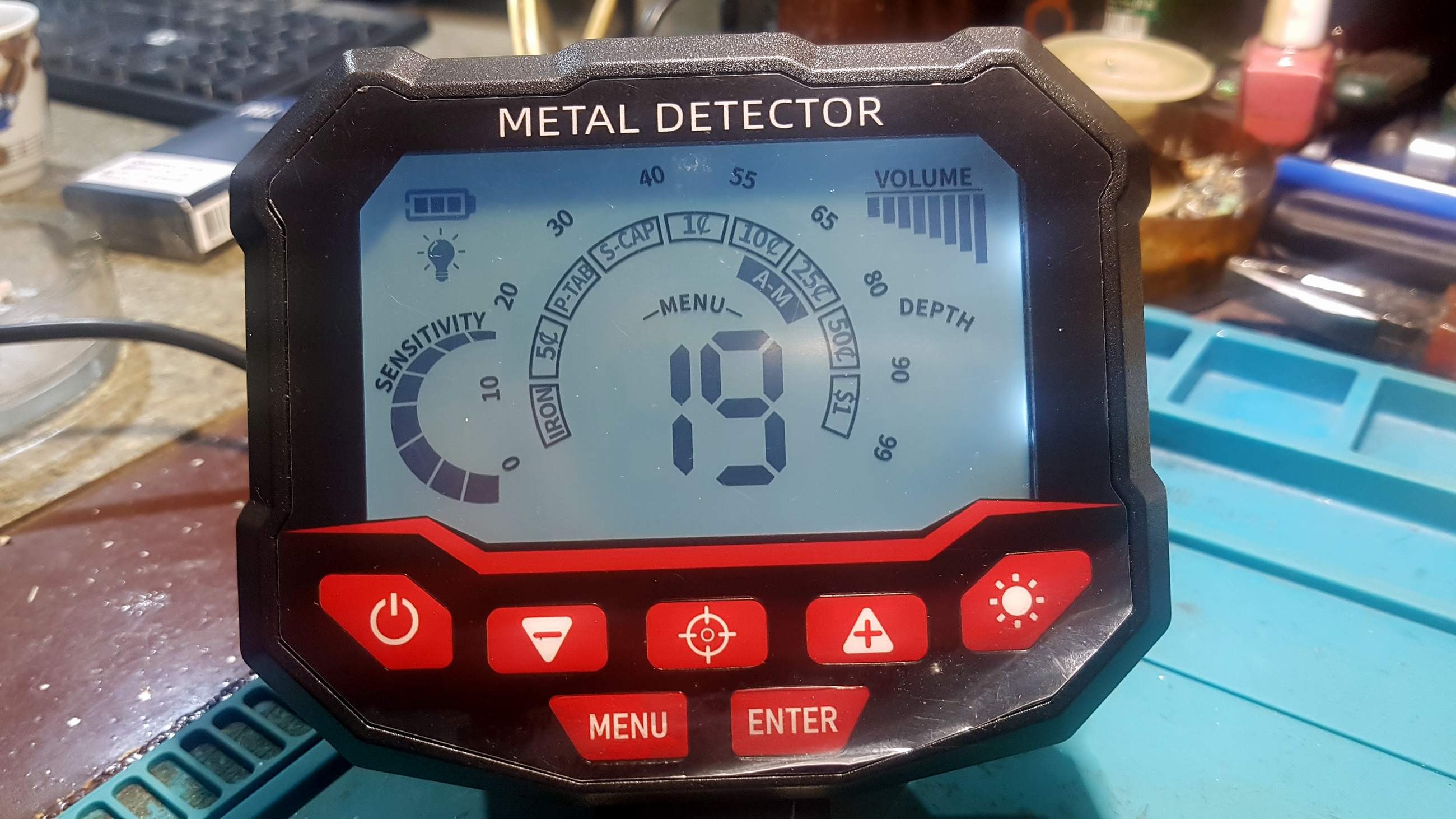

                Along with this ACE 250 clone, I also took this very interesting looking metal detector.
                The price in China is $35 more or less.
                But by the time it got to me; the price has increased 3 times!
                First impressions:
                1) The detector box is made of very flimsy and cheap plastic, although the design is pleasing.
                2) The "machine" itself works, there are no false functions, everything is there, in place, everything works correctly (alas... read below)
                3) Search head is unnaturally large, very ugly design, hollow, light and worst quality plastic... it wouldn't even last 5 hours on my fields.
                4) The cable from the search head to the machine is of the worst possible quality, it's hard to find worse than this!
                5) The connector on the cable is a "DIN" type, the last time I saw it was in the mid-80's on those outdated, ancient audio devices.
                6) Although the detector works correctly and accurately as far as the audio and VDI scale is concerned... the "depths" in the air are so poor and miserable... funny!
                7) Audio is good but too quiet even when "Volume" is at maximum. The reason: a desperately small and weak speaker is built into the machine.
                ... "eight" is giving funny smiley, so let's skip it!
                9) After 5 minutes of testing... the processor started to "bug" and "glitch" and the detector "froze"!
                10) PCB and LCD are very nice, tidy, no visible flaws.
                Conclusion:
                Typical Chinese business! They never finish the job.
                It is obvious that the code developers for the processor did not test the code well enough.
                I'm yet a professional "tester" and I always find bugs in an hour... give me an Android phone, give me an iPhone... write an app, I'll find you "1000" bugs in the first test.
                So this so-called "detector" is not even worth the initial $35...

                  Strangest of all, this detector has a USB-C connector on the side of the box.
                  There is no mention of that connector in the short Chinese "English" manual.
                  The detector is powered by two 9V batteries.
                  When I remove the batteries and connect the charger (from a smartphone) to USB-C... on the pins of the two connectors for 2x9V batteries, I measure about 6.6v!???
                  The detector then turns on, but it "flickers" non-stop and does not work stably at all.
                  The Chinese seem to be suffering from an excessive love for those USB-C connectors, putting them on all their devices even though it often makes no sense.
