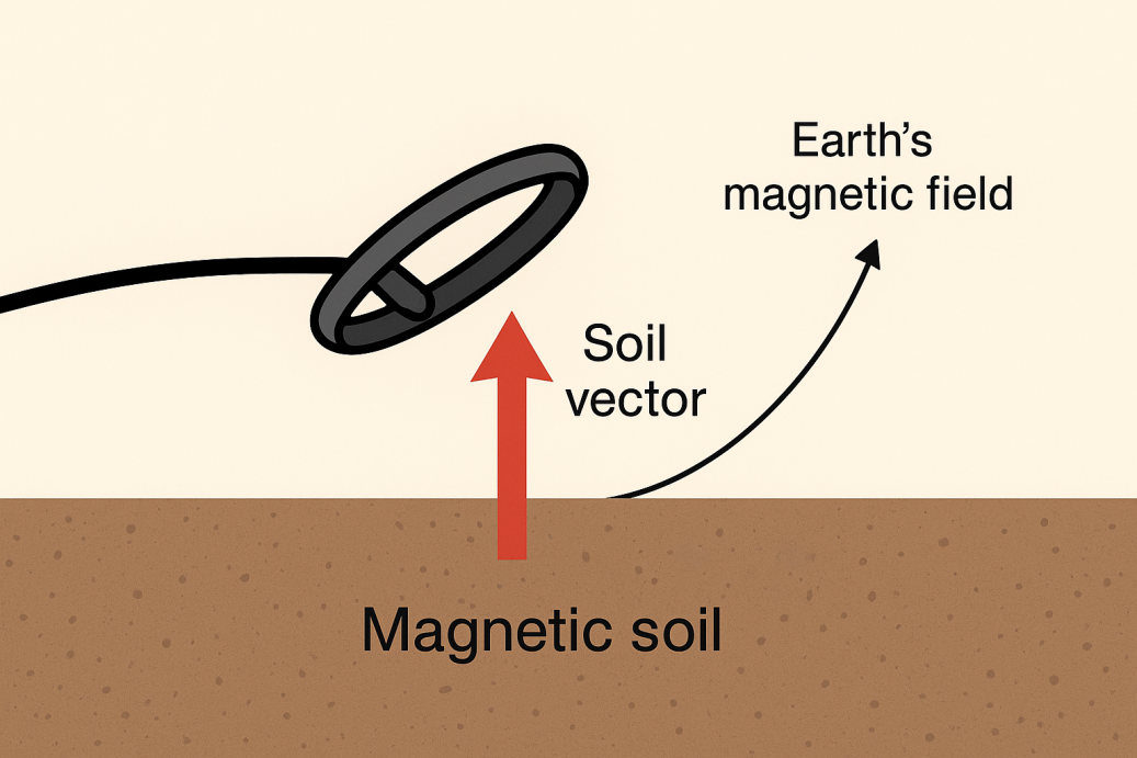

      Not from what you describe. Soil has 2 attributes that are important to detectors: loss angle, and susceptibility. By "vector" I assume you mean loss angle, but depth loss is more a factor of susceptibility (strength of ground) than loss angle (phase). And really strong ground also creates a stronger lift-off effect, which makes the detector harder to ground balance even though the loss angle is well within the GB range.

          Not from what you describe. Soil has 2 attributes that are important to detectors: loss angle, and susceptibility. By "vector" I assume you mean loss angle, but depth loss is more a factor of susceptibility (strength of ground) than loos angle (phase). And really strong ground also creates a stronger lift-off effect, which makes the detector harder to ground balance even though the loss angle is well withing the GB range.
          Vector direction shall be nearly vertical, pointing upward or downward depending on local magnetization.
          Reason: shallow magnetite grains produce a strong vertical component that interferes with VLF/multifrequency detectors, causing noise and reduced depth.
              By soil vector I mean the detailed explanations in this patent - https://www.geotech1.com/pages/metde.../US4030026.pdf - Fig. 3 and Fig. 4. I also had a neodymium magnet, but I forgot to check whether the soil sticks poorly to the magnet. I forgot to take a sample of this soil. The soil is located in a karst area - about 200 meters from it there is a very large cave with stalagmites and stalactites, which is a tourist site. The test hole is at a level about 4 meters higher than a huge clearing resembling a crater. About 7 meters from the hole there are large shapeless limestone stones. Millions of years ago there was a sea there. Years ago the soil had much higher humidity and was even more problematic. Then there was a Minelab GPX 4500, but we forgot to check how much the depth loss was.

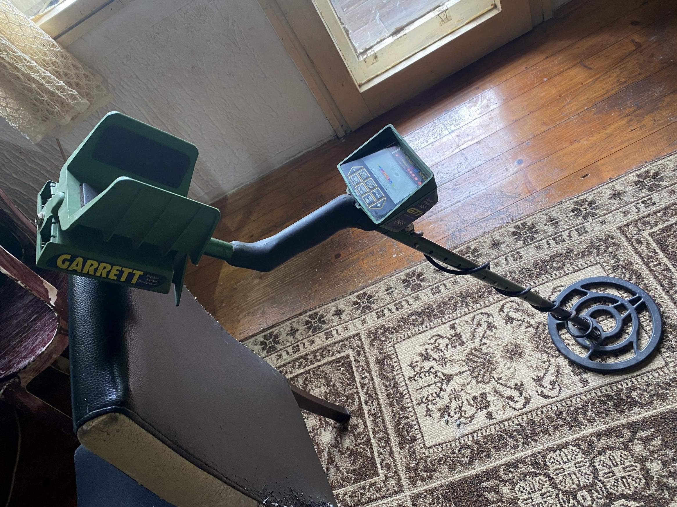

                    Wow it is in very good shape!
                    The other day I god Garrett GTI1500 with Imaging coil.
                    The collection keeps expanding.
                        I do not recommend this detector for a collection, but to work with it if it is completed with a three -storey antenna (it is quite thick) by the same company. I remedied the same model detector model about 20 years ago. In a rather "junk" settlements you will understand why I recommended it to you ...
                          I find his diagrams to be confusing. Figs 3 & 4 deal with the coil phase error and Figs 5 & 7 deal with ground error. Rotate the plots 90° to get them roughly to the same orientation as ITMD3. Even then, George uses the TX voltage drive as his reference whereas I prefer to use the TX current drive so there needs to be an additional Θ rotation.
                            What was that?
                            Can't understand.

                              ​we forget about fig.4. we look at fig.3 vector 298 are natural ferrites – magnetite (hot rocks). They do not introduce energy losses into the spatial region around the transmitting coil. however, everything that is clockwise after vector 298 introduces losses – from conductivity and (or) from remagnetization. vector 296 – there is ceramics. it does not introduce losses from conductivity, but from remagnetization. the reason is inertness. Only natural ferrites (magnetite and others) do not exhibit inertness – their magnetic domains are practically without inert in magnetic fields at frequencies below 100 kilohertz. Iron objects introduce losses from remagnetization and from conductivity, and their vectors are ALWAYS after ceramics clockwise. Anyone who has looked at the oscillograms of iron objects obtained from the receiving coil of the Fisher CZ5 Quicksilver knows this. The oscillograms of iron objects have rounded fronts, and magnetite - extremely steep fronts. The vector of the ceramic is about 5 degrees behind the ferrite (as explained in the patent US4030026). And so - I ground reject precisely on the problematic soil. Then I waved the piece of ceramic in front of the probe and oh - miracle!:whew - the ceramic had a negative reaction ... the patent explains that the vectors of all soils are between the ferrites and the ceramic - this is really so. When we ground reject the soil, then the ferrites have a negative response, and the ceramic - positive. The fact that the brick (ceramic ) had a negative reaction indicates that the vector of the soil is located after the vector of the ceramic clockwise. which means that this soil incurs greater losses than ceramics. When it is wet, things get even worse and the vector approaches iron objects. As an operator, I am not particularly afraid of mineralized terrain, but I am terrified of such soils
