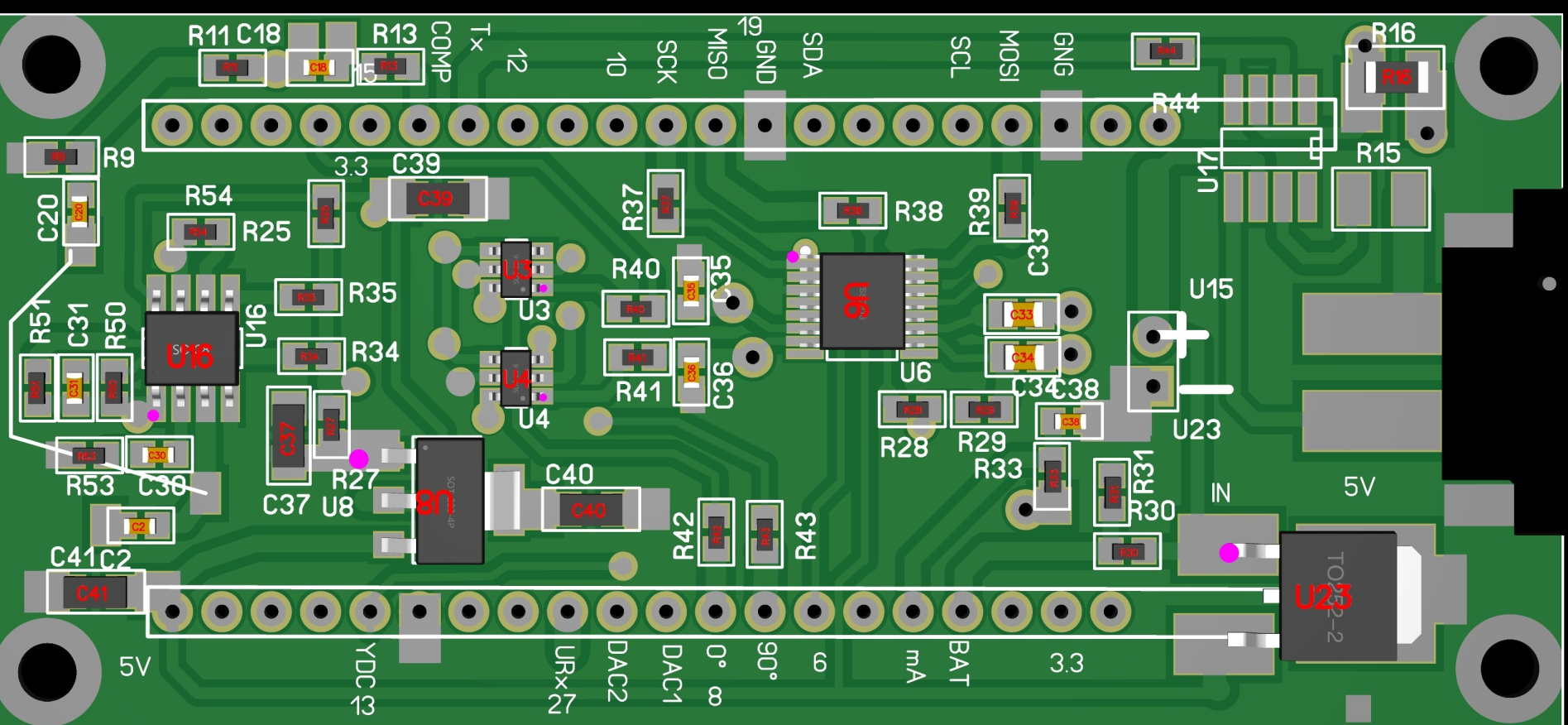

                    Here are XP Deus FMF photos of the PCB to show how simple it all is.
                      or this - simple
                      Click image for larger version  Name:	image.png Views:	0 Size:	1.19 MB ID:	440726​
                        Oh, they use a full bridge on n/p MOSFETs. The use of only n channel MOSFETs would make it even more economical. But it doesn't matter. Thank you for the information. And do you have any data on the coil Rx and Tx: inductance, resistance, wire diameter. Th, it will most likely be wrapped in litzendrate.
                          or this - simple
                          Judging by the two rows of landing holes, the board is adapted for the use of a ready-made module with a microcontroller. The tracing of these modules is far from ideal. Is it possible to see the diagram of the device whose boards you demonstrated?
