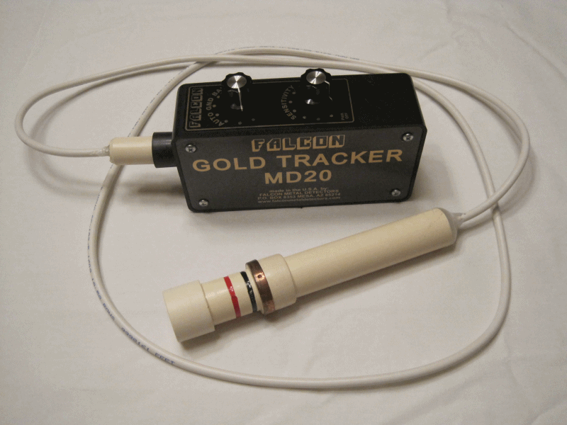

      i almost forgot this type of detector... so much discussion was in later... so much activity of the geotechers... look FALCON MD20.
      sometimes the activity gives birth to nothing.

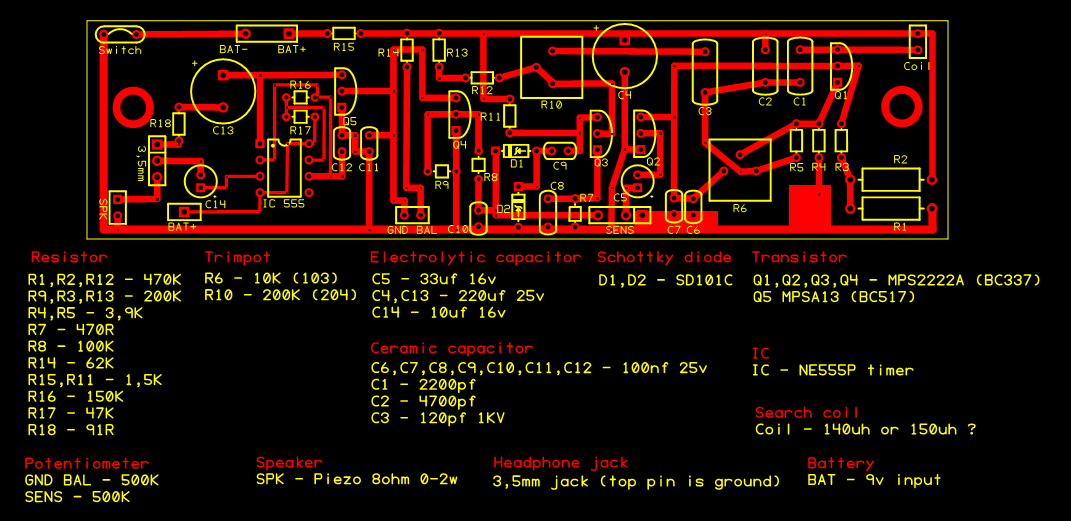

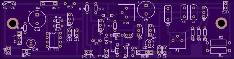

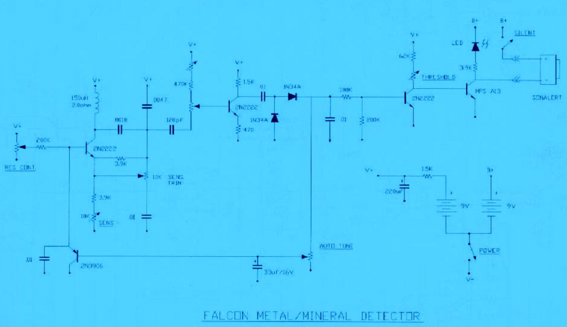

        Here's everything I have on the Falcon MD20.
        The TX frequency is 300kHz, and the pinpointer head is a D10mm ferrite rod with 60 turns of 0.2mm wire.
          The Falcon is just a simple energy-theft pinpointer, works the same as a Garrett Pro-pointer. The only special thing about it is it runs at 300kHz.

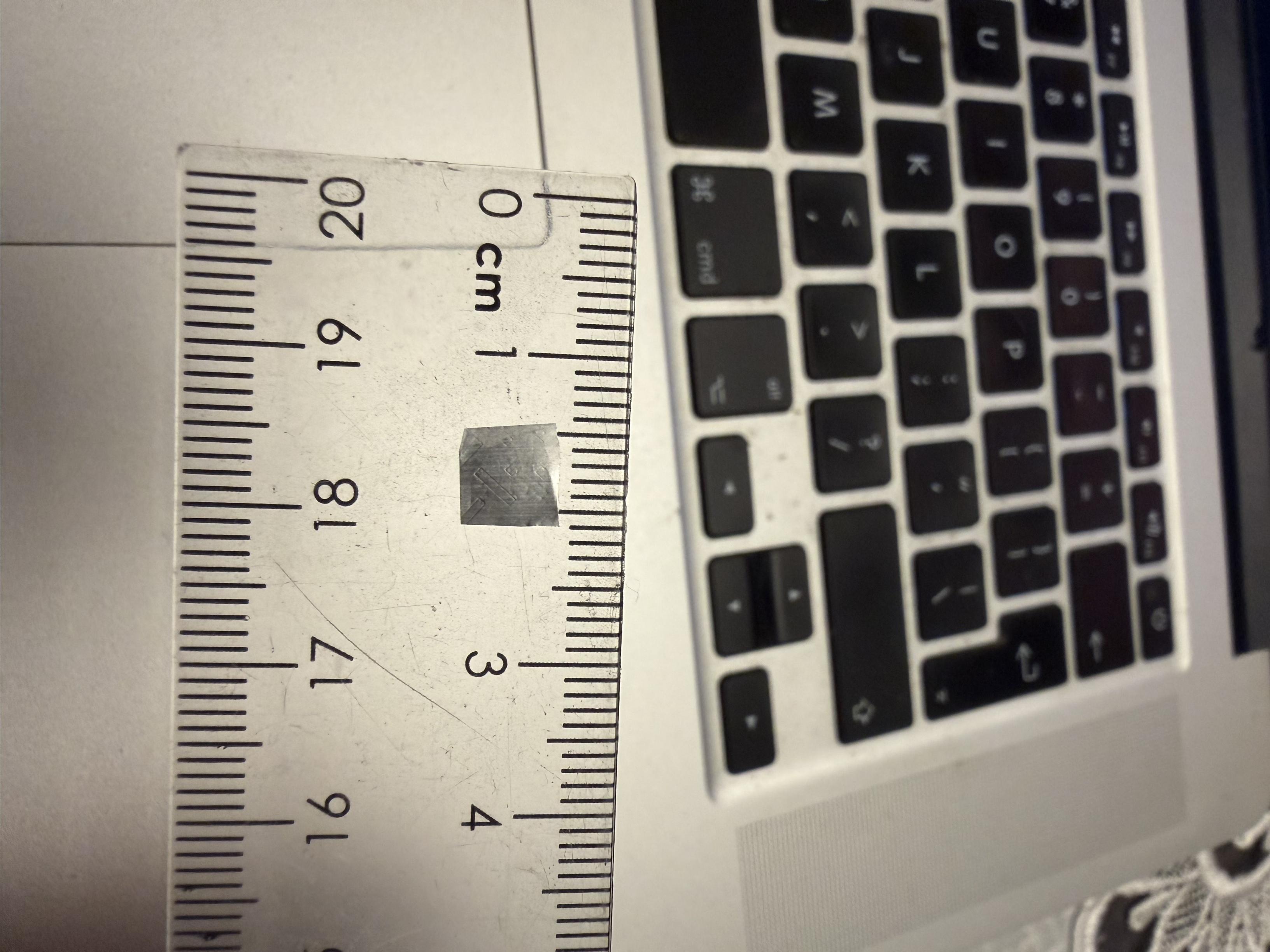

              Seriously though. I tested my XP Mi-6 pinpointer and it detects a 5x5 mm piece of kitchen foil. It doesn't detect anything smaller.​
              Click image for larger version  Name:	IMG_0108.jpg Views:	0 Size:	580.0 KB ID:	442436
