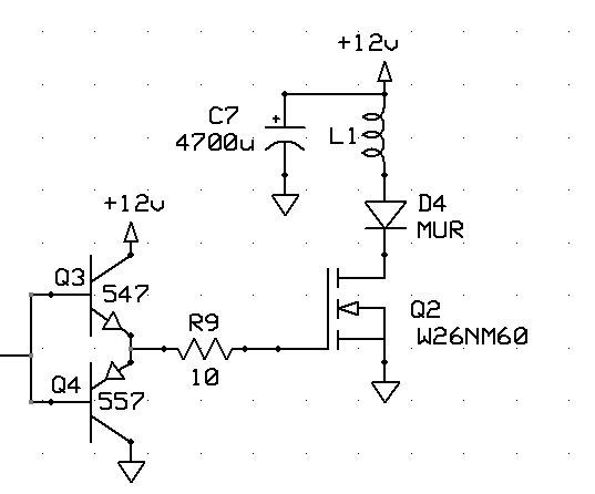

    150-200Hz PPS, 200uS pulse width , 30-70uS sample delay.
    With 200uS pulse width, the TX transistor will probably heat up, put a heatsink.
    If you want a completely safe solution; use a strong mosfet like W26NM60, it doesn't need a heatsink.
    Such mosfet will need more robust gate signal, use totem pole driver:
    Click image for larger version  Name:	image.png Views:	0 Size:	6.5 KB ID:	444395

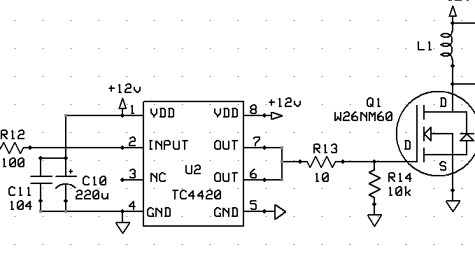

    Or use dedicated driver:
    ​​​​​Click image for larger version
      Thanks, Ivconic.
      I'm using a IRF740 mosfet. Can I omit D4?
        Yes you can.
