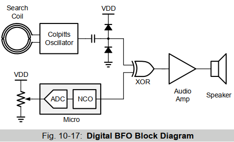

                        Thanks. Read it and is quite the detector. Interesting how the builder used the flip-flops to do this. He eliminated the drift from one of the two oscillators. Then turned the search frequency into a square wave to be digital then using the two pulses now injected into the flip-flop where one pulse doesn't change and the other doesn't change and the flip-flops are happy until the search coil changes frequency and throws the flip flop out of sync and then the error is processed as a tone. Looking at it closely it it is very similar to my first design in which I removed the reference oscillator and replaced it with a pot more or less. I need to draw out what it looks like, but keep in mind its never been built. I should build it to see if it works. The second one I am working on, I've never built as it is theory and will take some tweaking to get to work. It will have a crystal controlled oscillator as part of the circuitry. I am also trying to keep the search oscillator fairly stiff from drifting but loose enough to convince a change in the frequency. I suppose it is somewhat like the one above in that I will have it detect a phase difference which will be detected by another part of the circuitry. as a digital signal but I also want to give it the classic up down tone mix the two together so you can hear both at the same tome, digital and analog. You will have control over which one is louder. So you will have a go-no go signal plus a variable tone, one everything is set it wont drift, theoretically. Is it possible ? I don't know for a fact. I am fairly certain there wont be any drift whatsoever and the only drift is what I've set that will only happen when a target is found, then it will allow for drift for 1 second that's it. I'm a little old fashioned but am going to learn to draw schematics using Kicad or something. Otherwise I could just draw it out nice and neat or I guess I could use paint to draw a schematic of the first design. The second one I am still working out the bugs to make it work. Thank for sharing that BFO schematic with me.
                              The most stable BFO design will place the tuning in the reference oscillator and make it digital somehow. Here is a concept from ITMD3:

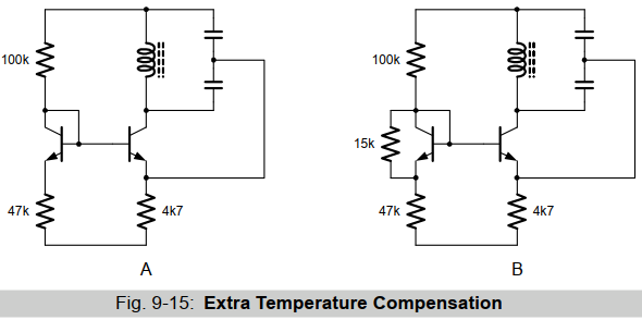

                              The search oscillator is squared up and XOR-mixed with a micro-generated square wave. Conceptually you could do the mixing in the micro. You still have to worry about the stability of the search oscillator but at least there are no varactors to deal with. Here's a way to do temperature compensation in a Colpitts oscillator:
