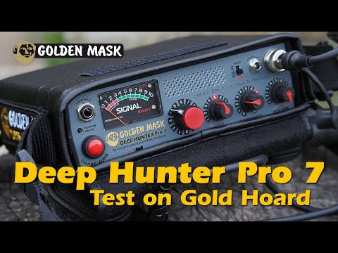

              The device I own is a Golden Mask Deep Hunter Pro 7 SE pulse induction device. I'm looking for a digital data recorder and converter that can be integrated via the headphone jack to obtain 3D data images. That's what I'm talking about, and I have nothing to do with what you said—no conspiracy or joke. Thank you again, with all due respect.

                  I assume it's this detector you have?
                  It is clear that it has a very simple audio VCO type.
                  There is no "information" there.
                  Especially not for "3D data images"?
