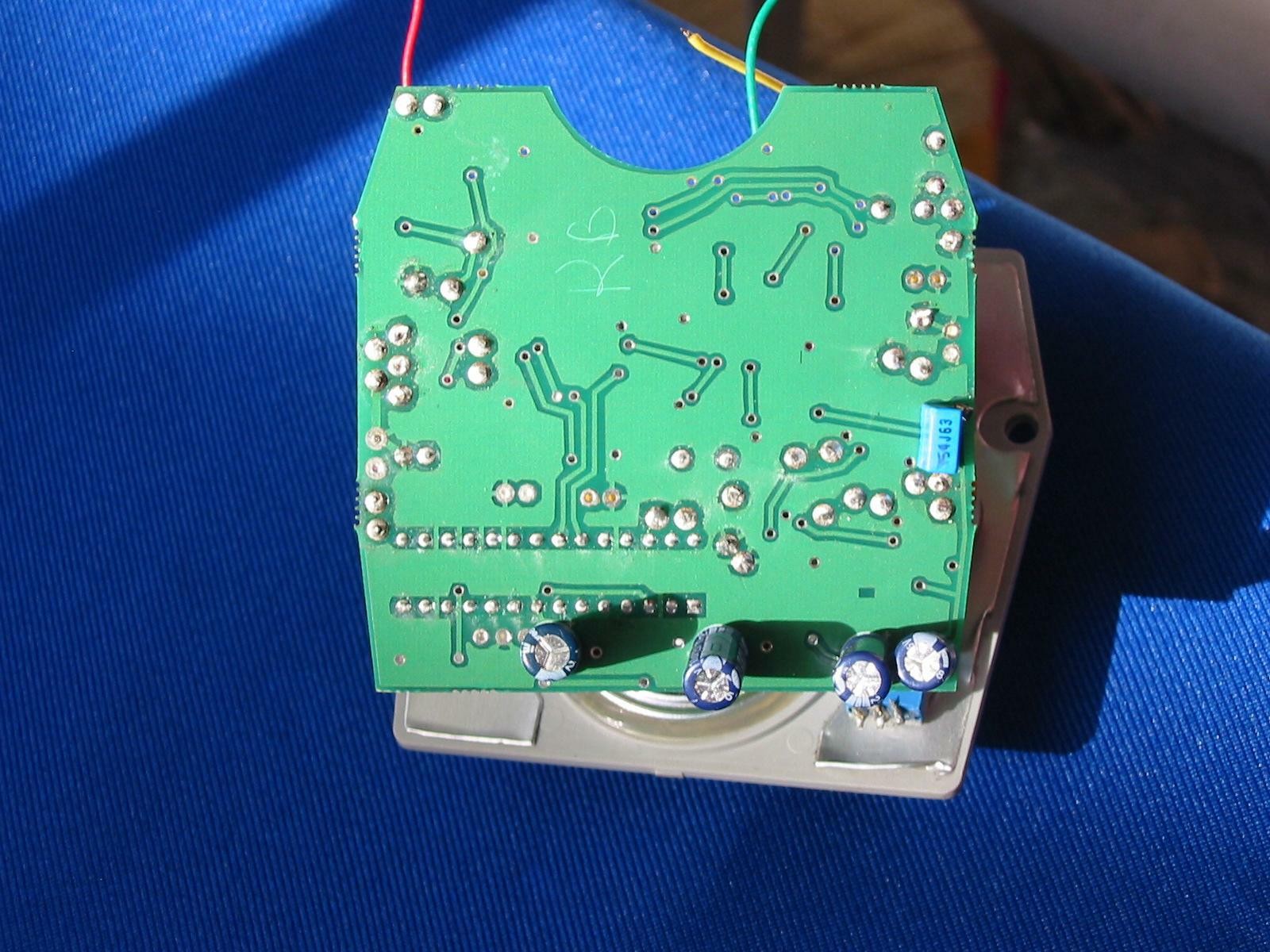

    I see a total of 5 caps that can easily be replaced. I could do that.

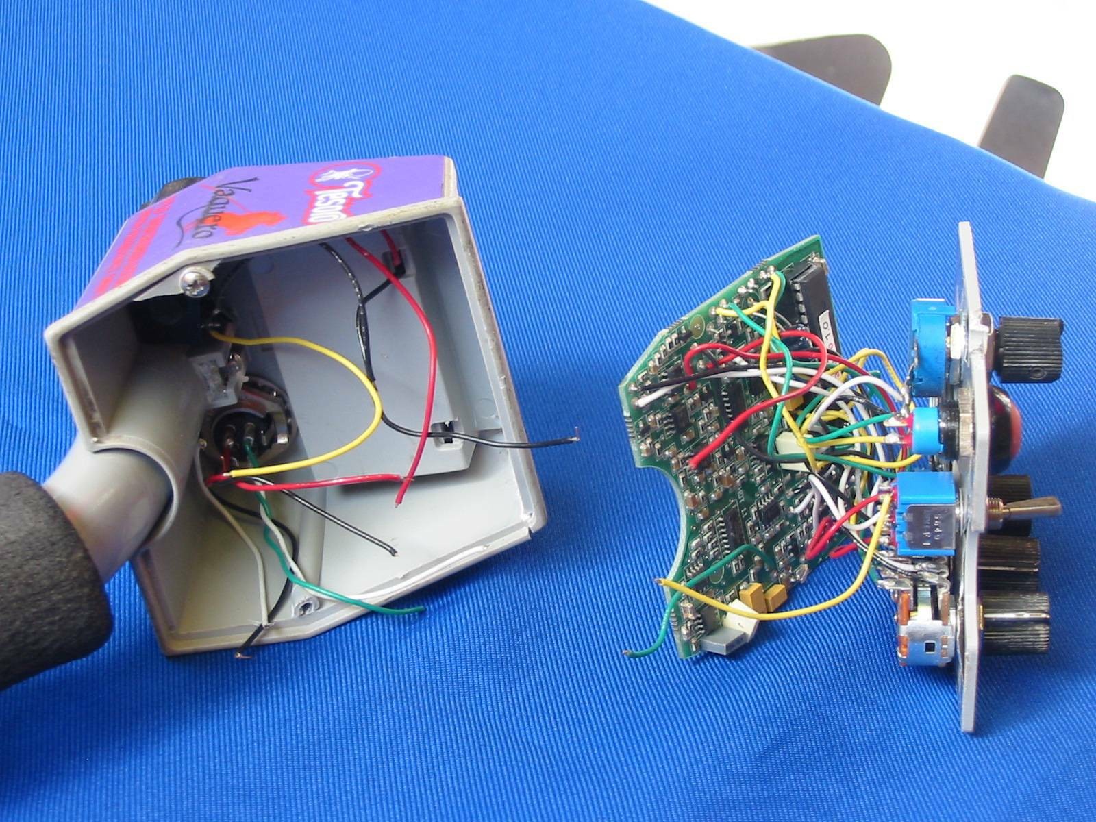

    I was hoping to see a gutshot of another Vaquero, and also a DC resistance reading of another 8x11 DD coil.

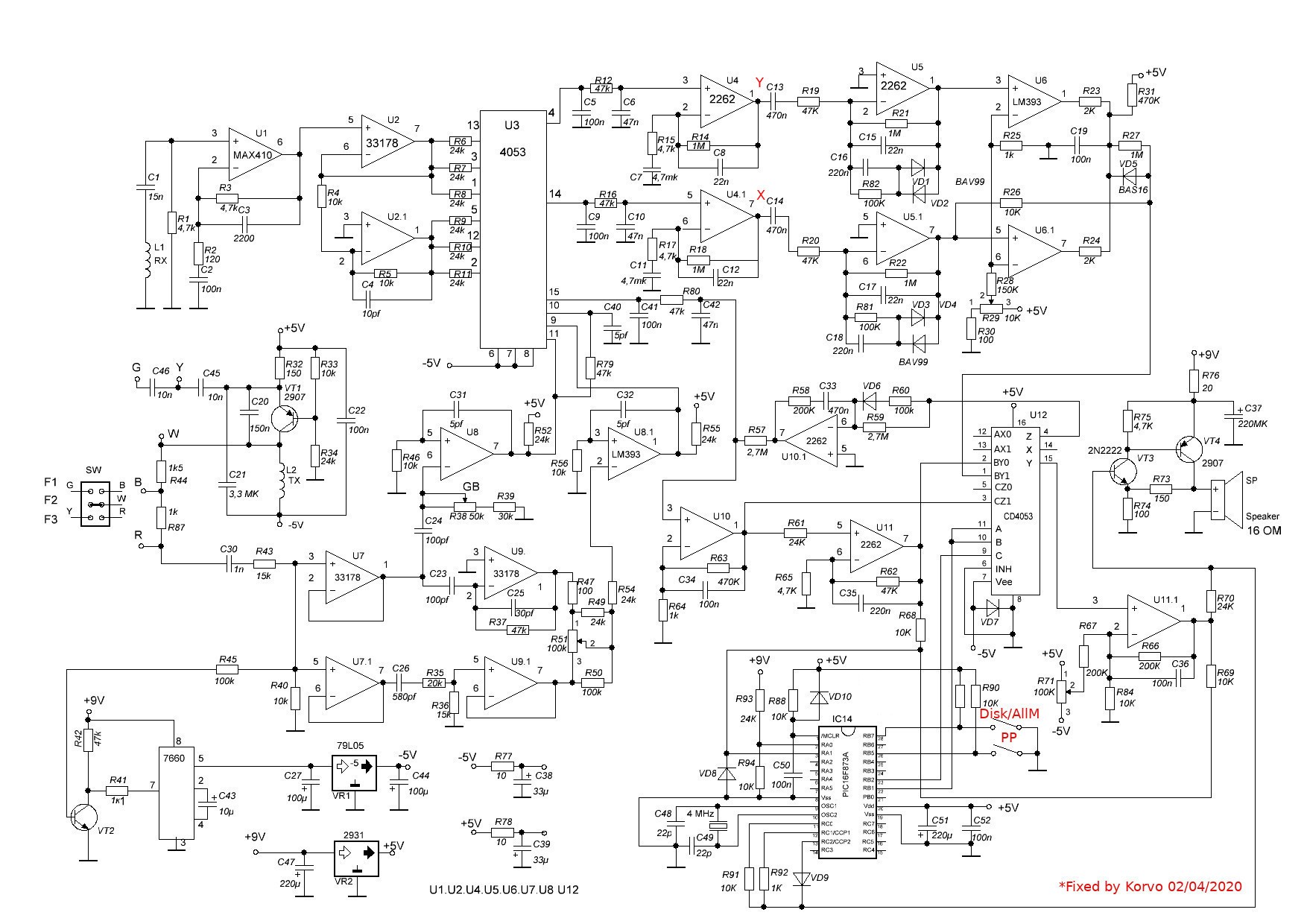

      This might be the Tesoro Vaquero schematic.
      The GB pot is shown as 50k.

            The schematic that Qiaozhi shared, helped for verification of the caps. I think it might be a different version though. It does not match up 100%. I will try to mark the differences between my machine and the schematic.

                this is all i have.
                  Thanks for the images kt315. I see that there is an added cap on mine, touching the 8 o'clock position of the circle.
                  I did receive my parts in, so I will replace them and the GB pot. Everything else looks good.

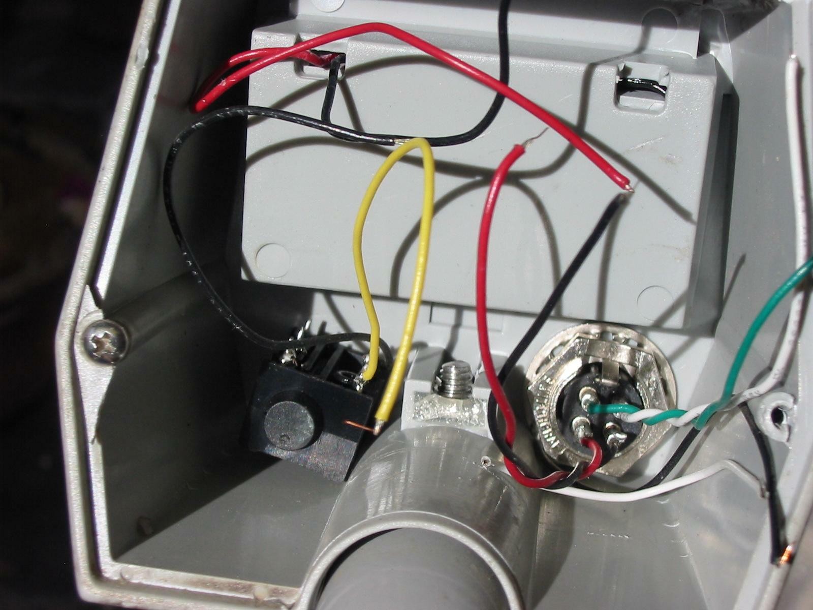

                      At first, I thought something was wrong. When in All Metal, I couldn't get a threshold tone, unless I pressed the PinPoint button. I was feeling like, maybe that's the way it is supposed to be. I had to read the manual. then I started to feel like I bought a dud machine.
                      I re-opened it up, and noticed the soldered tabs were touching the All Metal tabs. A slight bend, and re-tested for threshold, Voila! Fixed!
