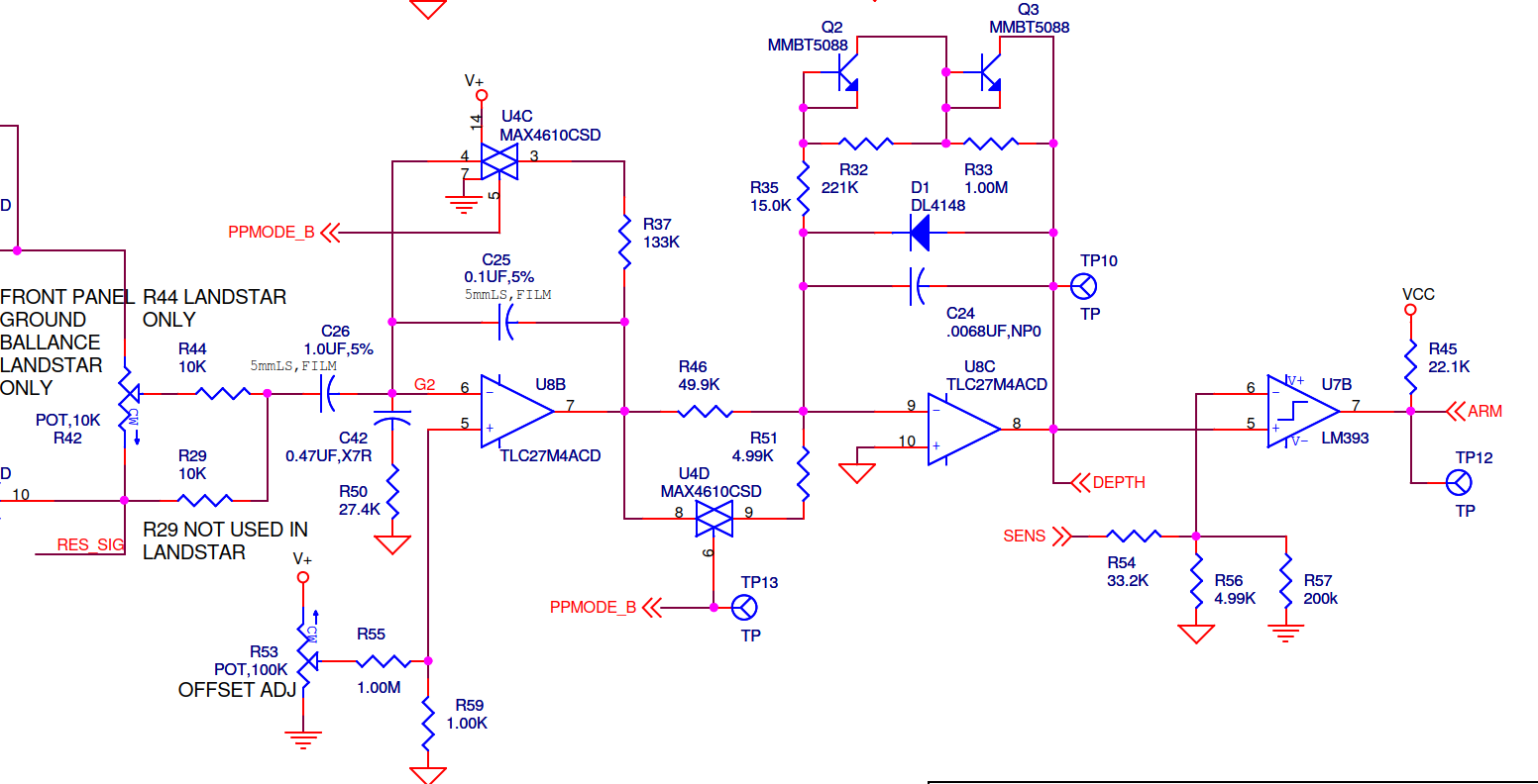

    I picked up one of these older detectors in working condition. I don't have and cannot find a schematic for the Land Star.
    There are 4 trimpots on the PCB, wondering if one is a threshold adjustment and if so which one?

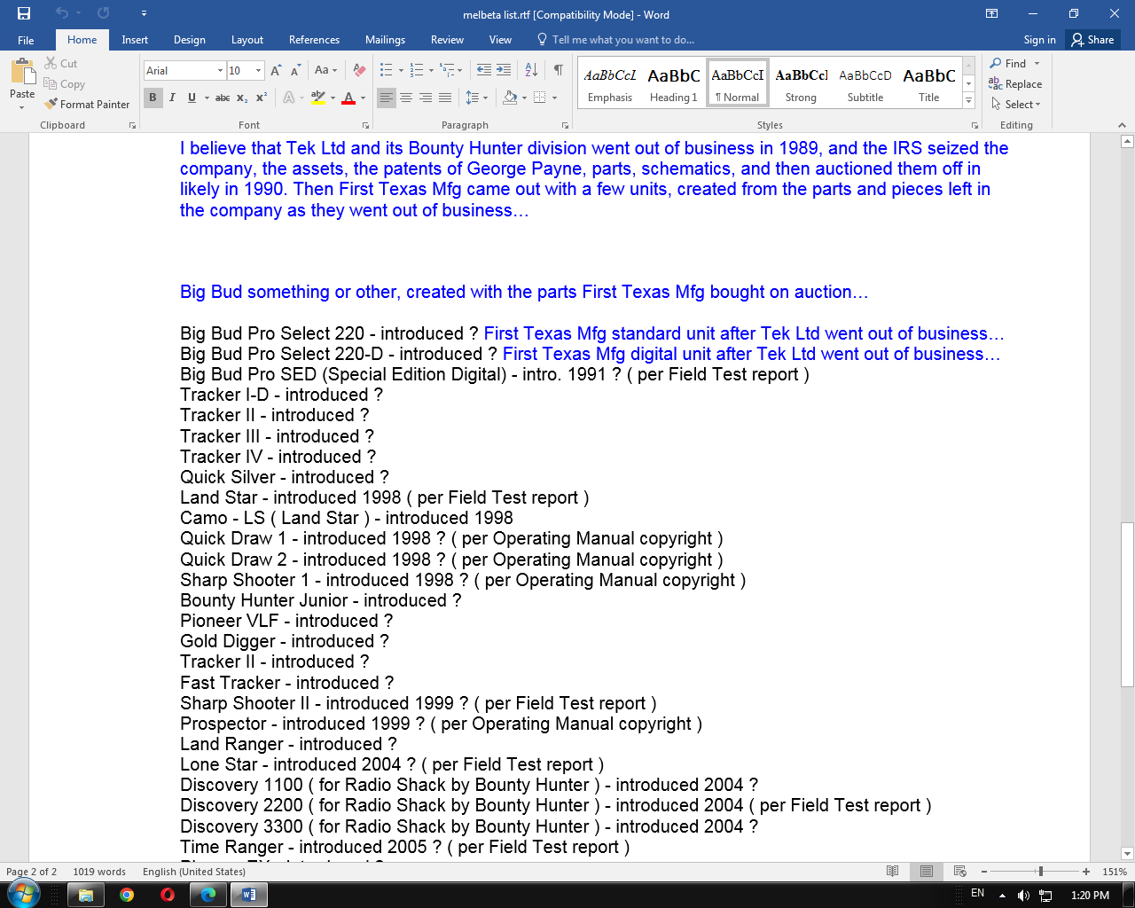

      maybe Melbeta will give a light? her file.

        R53 is the only possibility I can see for a threshold adjust. "ARM" feeds the micro, which then drives the speaker.

          Thank you!!
