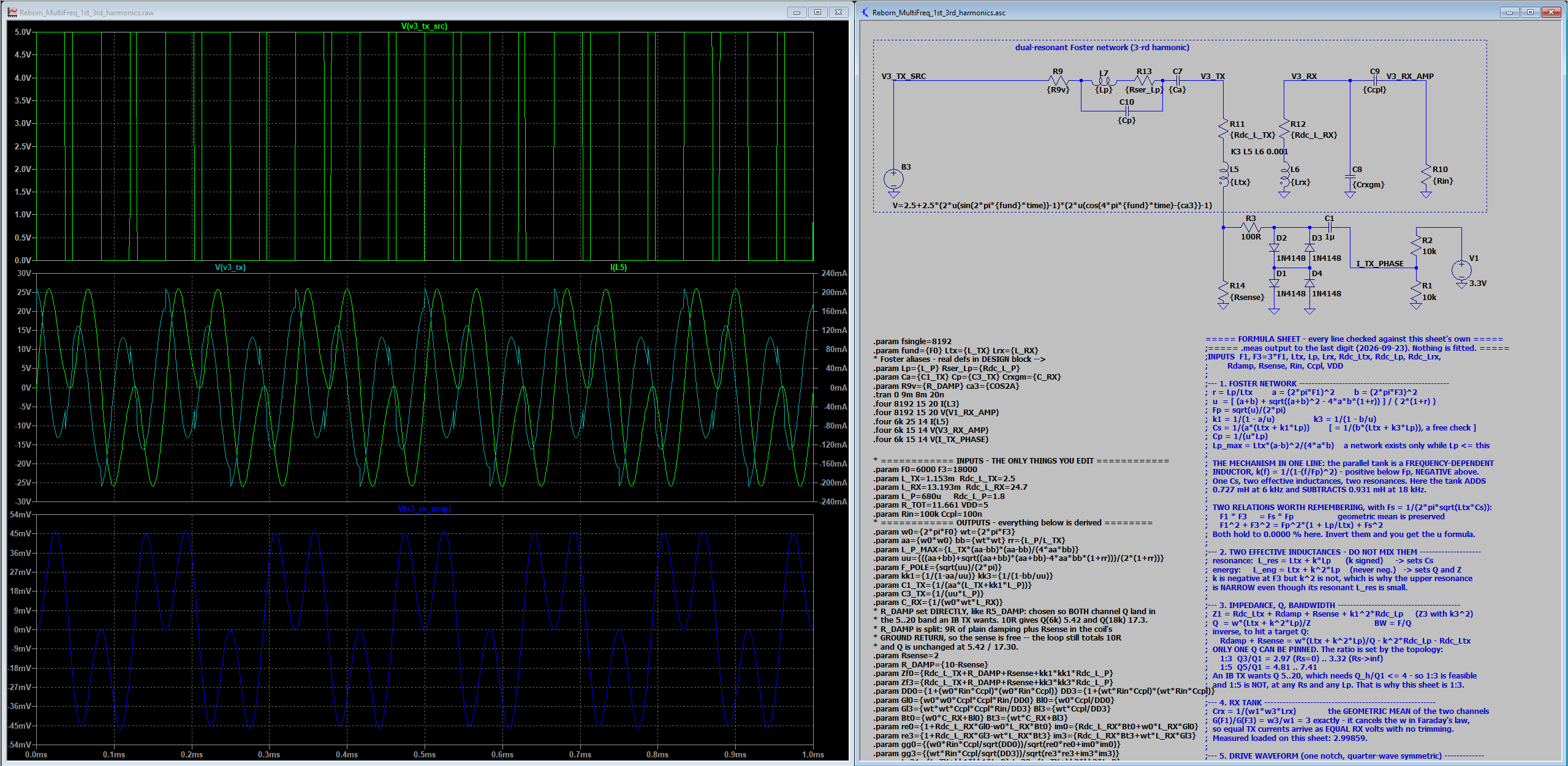

    Below is the LTspice simulation of the dual-resonance Foster network at 6 / 18 kHz (1st / 3rd harmonics): Q(6k / 18k) = 5.42 / 17.30 — both within the 5…20 band; Itx(6k / 18k) = 134.9 / 134.8 mA.
    5-th harmonic doesn't make sense doe to high about 41 quality factor, the stability of 5-th harmonic will be poor especially on wet conductive soils. So decision to use 6 and18kHz seams reasonable.
    Tx stage: Lp=0.68mH, Cp=200nF, Cs=353nF for my Ltx=1.153mH (Rdc=2.5R), Rdump=9.1R.
    Rx stage: Lrx=13.19mH, Rdc=24.7R, Cp=18nF.
Name:	2026-09-23 214512  - Dual-Resonant Foster network 3-rd Harmonic 18kHz and 6kHz.png.png
    The first plot is the binary 0/5 V driver signal, which contains mostly the 1st and 3rd harmonics. The second plot shows the TX coil voltage (not sinusoidal) together with the coil current, which is a clean sum of the 6 kHz and 18 kHz components. The third plot is the RX coil voltage.

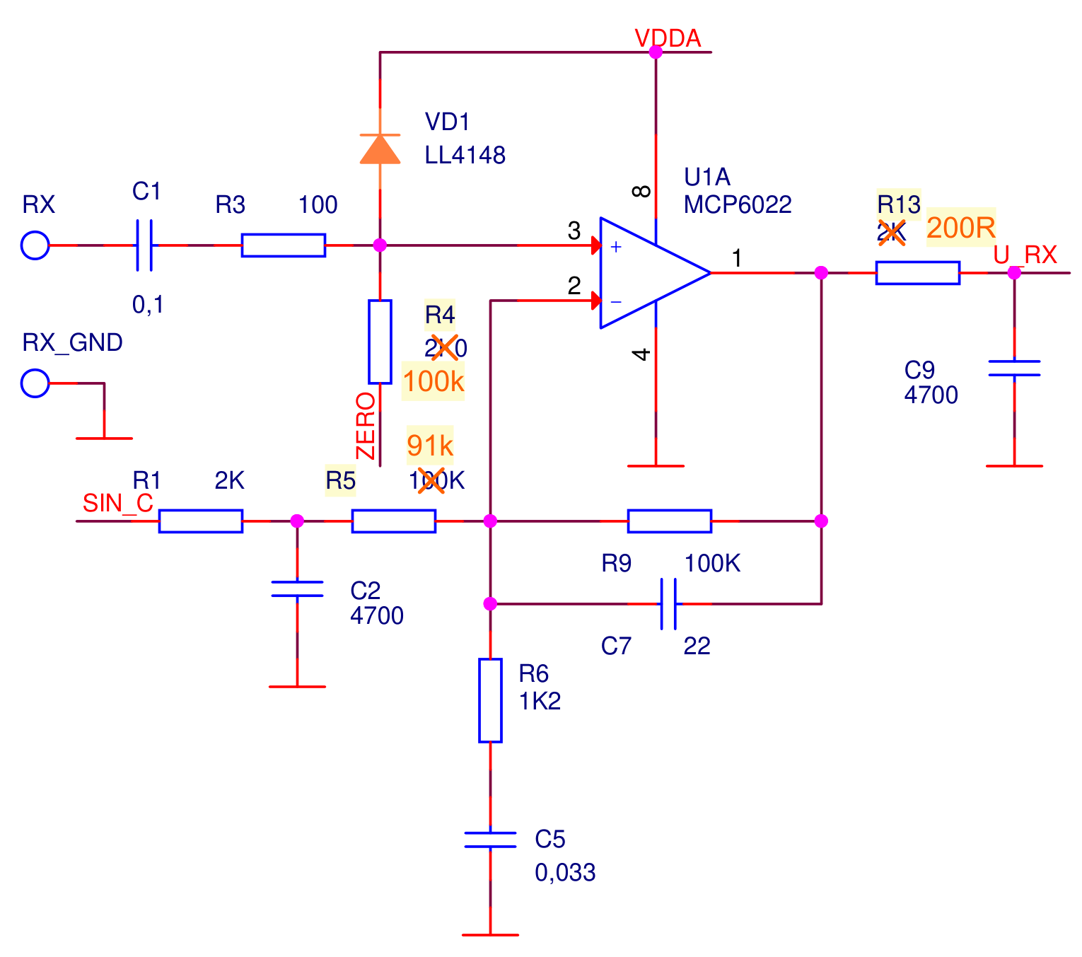

    The RX front end of the Quasar ARM requires only a minimal change for multifrequency operation:
Name:	Quasar_ARM_SCH - Minimalistic Update.png

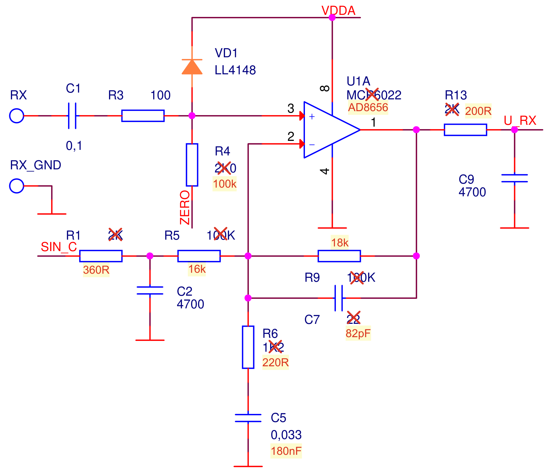

    Alternatively, a more thorough modification gives approximately three times lower noise and an expected detection depth gain of +23…31 %.
    ​ Click image for larger version
Name:	Quasar_ARM_SCH - Updated (+23..31 % depth).png

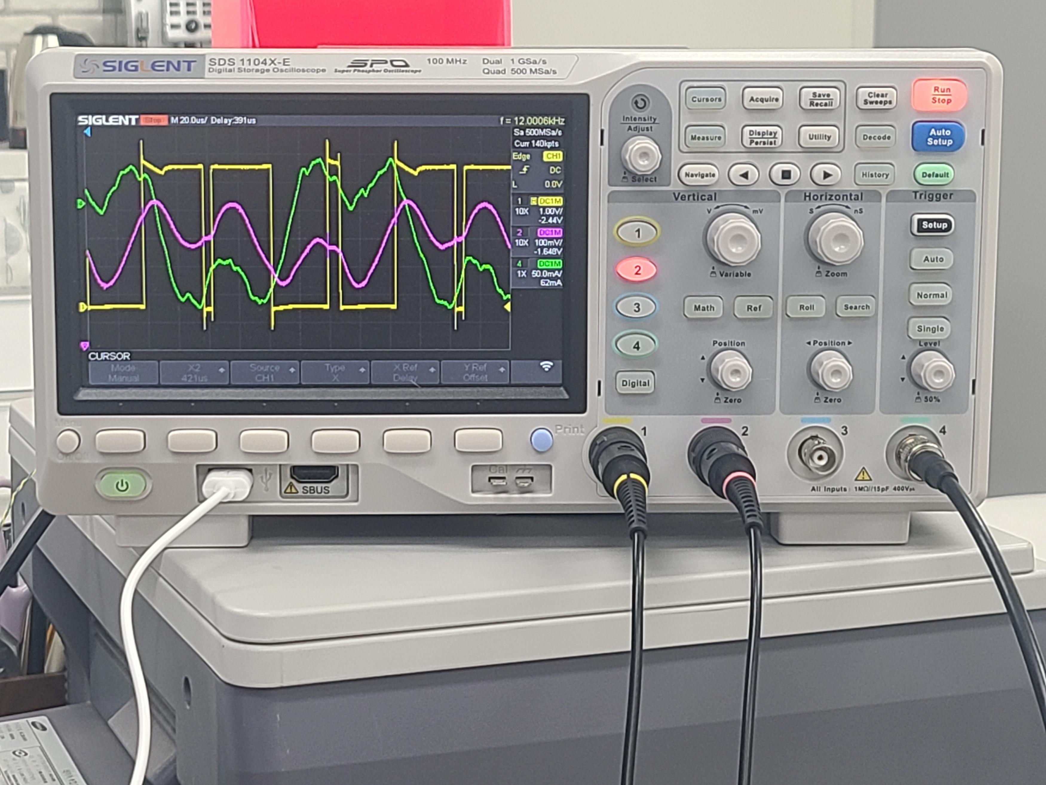

    Real HW shows similar to simulation waveforms: YELLOW: TX DRIVE, GREEN: TX COIL current, INDIGO: RX Amp output to ADC.

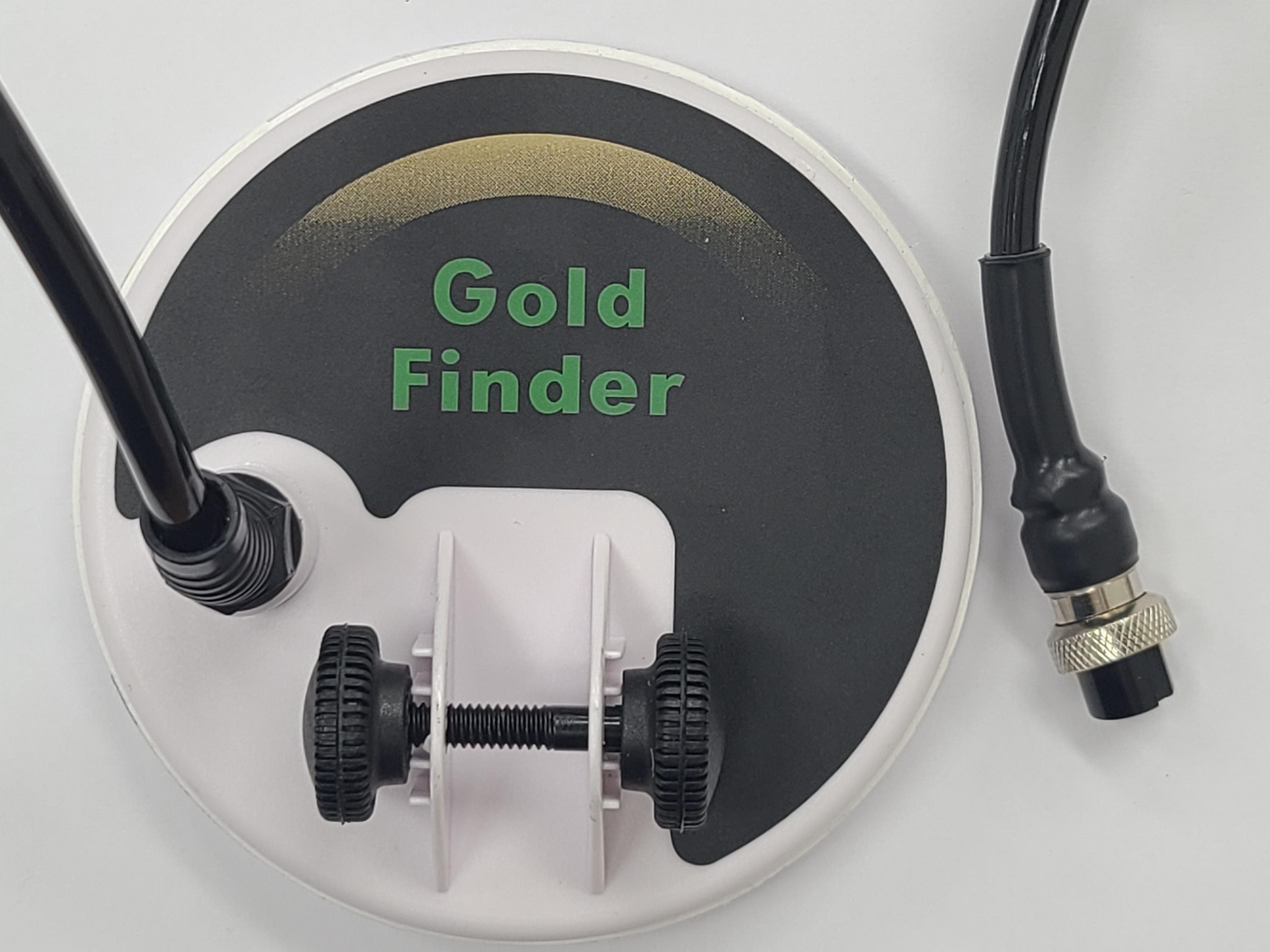

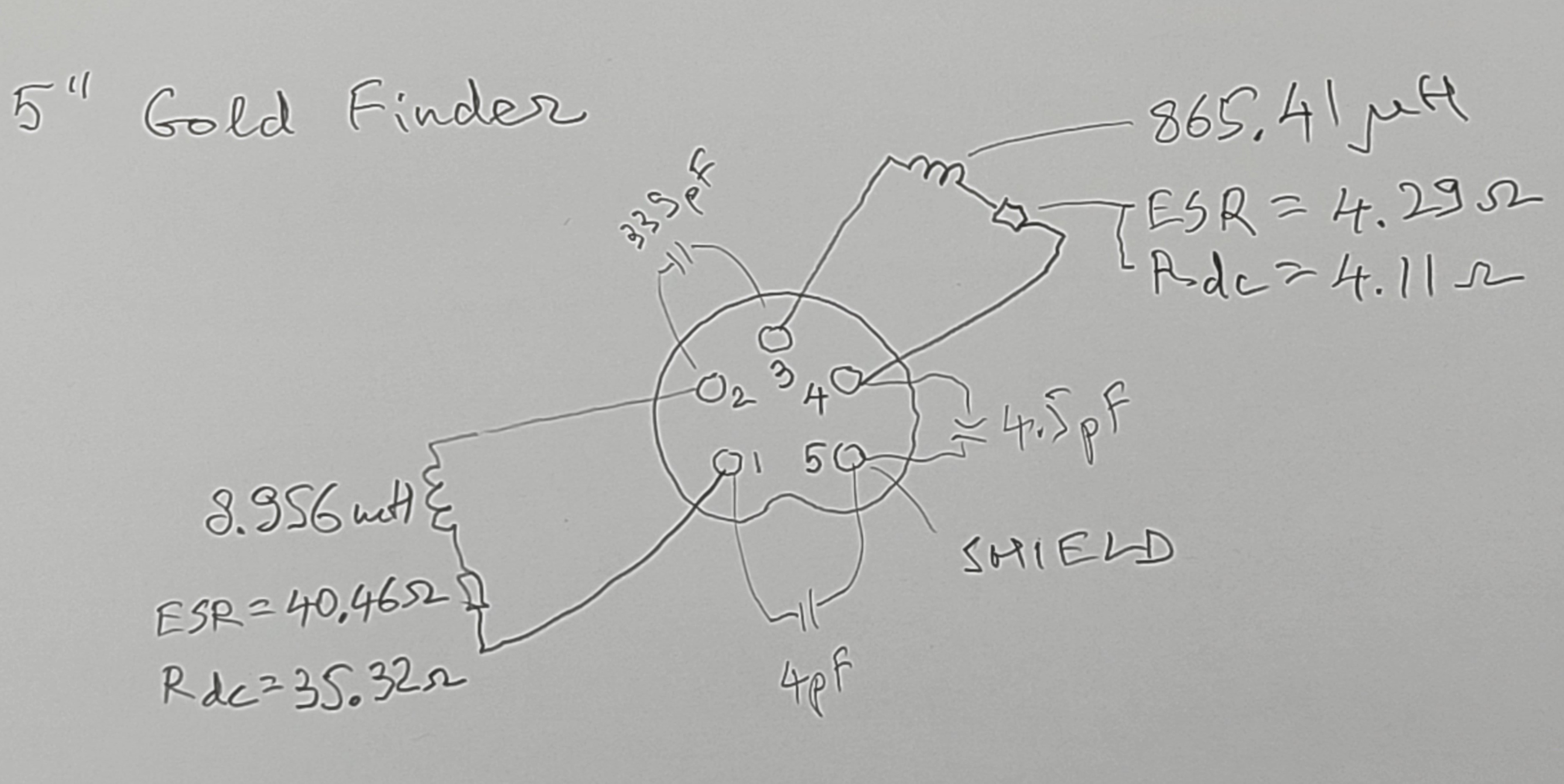

    Today I tested a 5" AliExpress coil with the Quasar ARM hardware and the firmware I’m developing.
    The coil has no resonance components inside. It’s sold for the Chinese TX-850 metal detector.
    The resonant networks are tuned for a TX frequency of about 10 kHz. I tuned the RX resonance lower than the TX frequency for better VDI stability:
    - TX, series resonance: Rs = 18 Ω, Cs = 330 nF (polypropylene)
    - RX, parallel resonance: Cp = 47 nF (polyester)

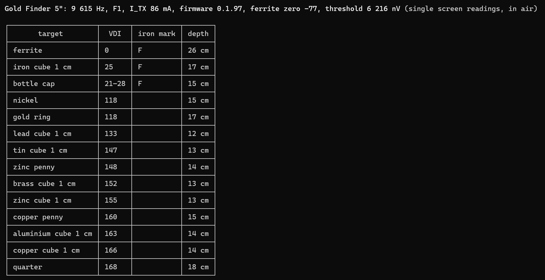

    Air test results at 9.615 kHz:
    Click image for larger version  Name:	Reborn 5-inch coil 9615Hz VDI.png Views:	0 Size:	59.6 KB ID:	453962
    The RX coil's residual imbalance is 30 mV peak-to-peak, so I had to reduce the compensation network resistor R5 from 91k to 22k.
    Click image for larger version  Name:	20261024_191252.jpg Views:	0 Size:	530.0 KB ID:	453963
    Click image for larger version  Name:	20261024_191723.jpg Views:	0 Size:	580.3 KB ID:	453964

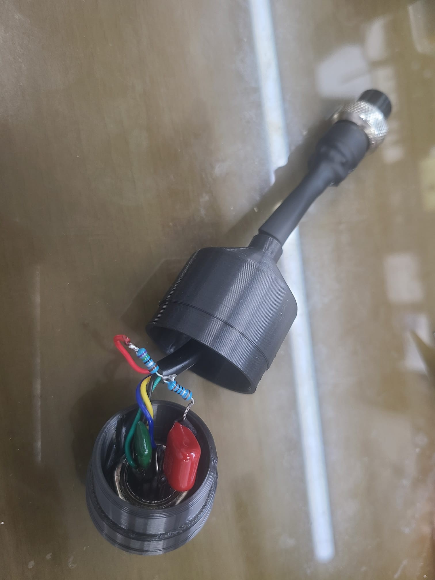

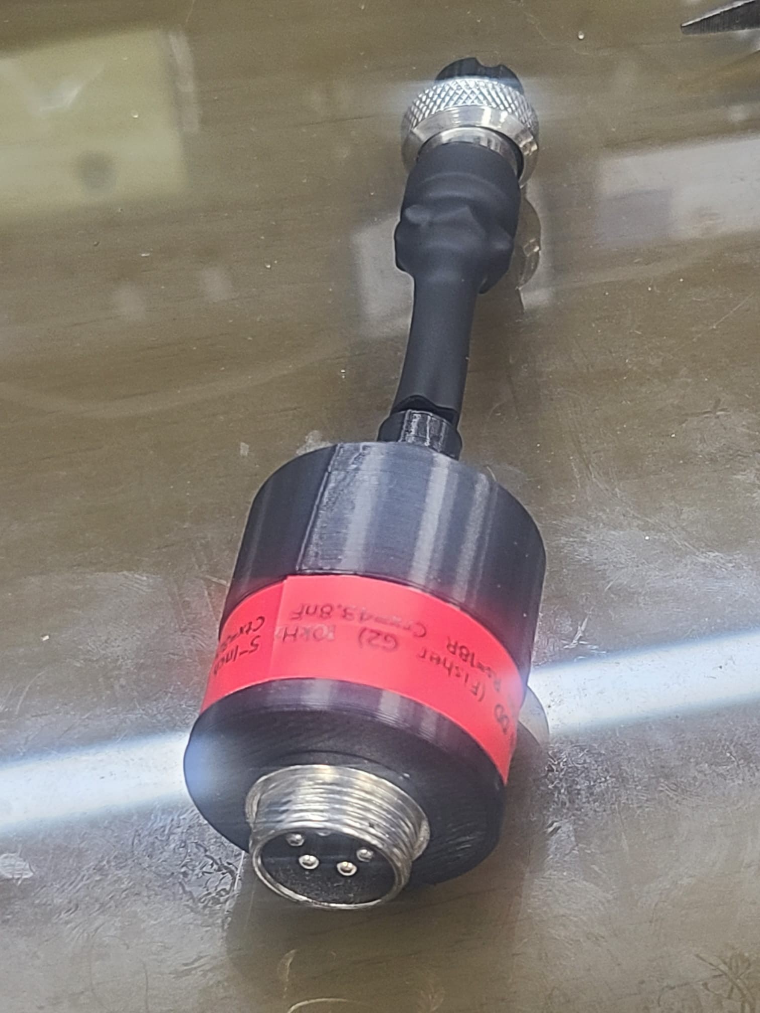

    Here’s the adapter with the resonant networks:
    Click image for larger version  Name:	dongle_2.jpg Views:	0 Size:	203.4 KB ID:	453965 Click image for larger version  Name:	dongle_1.jpg Views:	0 Size:	318.6 KB ID:	453966
    With the adapter, any coil with any pinout can be tuned for any single or dual-frequency operation.

          Firmware test targets: 1×1×1 cm cubes of iron, lead, tin, brass, zinc, aluminium and copper; US, Chinese and Korean coins; bottle caps, pull tabs and ferrite.
          Click image for larger version  Name:	20261101_155338.jpg Views:	0 Size:	614.2 KB ID:	454173
          The menu three:
          Click image for larger version  Name:	Screenshot 2026-11-01 185201.png Views:	0 Size:	100.9 KB ID:	454174
