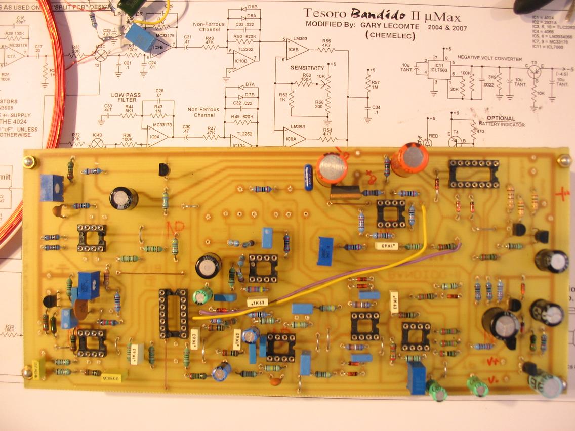

    hello friends, as are the value of: C10, C13, C14, C16, C18
    V+ = +8v, v = -5v
    L1, L2, L3 A.W.G 30? Greetings
    V+ = +8v, v = -5v
    The Schematic you Posted is for My New SPLIT BOARD Design, Not that Single board one that you show.
    However the Values for C10, C13, C14, C16, C18 Are in my opinion, "Correct".
    Battery Supply Voltage is 9 Volts.
    V+ is Regulated and is +5 Volts
    V- on this boards (using the transitor oscillator/Rectifiers) is Probably only About -3 Volts.
    YES, L1, L2, L3 A.W.G 30?
    But its really not all that Critical.
    Wire of 28 to 32 AWG is OK

      hello, thank you very much, I do not know the circuit with two pcb, greetings

          Here it is:
          http://www3.telus.net/chemelec/Projects/Bandido-Split/
            bandido two pcb
            Wonderful, today I am going to make this pcb. Thank you very much
