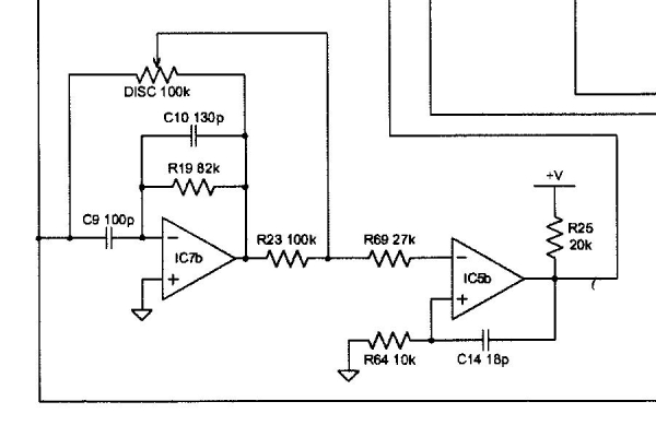

    For those peoples that build the BandidoII from original Carl schematic with original cap. value and a real Tesoro coil!
    Any one of you can try this little mod for me? (Or for yourself)
    I make this mod on mine and that is sold my Strange DISC variation range!
    But ! because i have changed the front-end amplifier,i cannot say that is the answer for the original shematic problem.
    So! If you want to try it!?!
    First pic= Original Disc shifter
    Secon pic= My mod
    If you take a look at the phase shifter from the "Golden umax" and from the "toltec 80" i take the mod from these shematic.
    Fisrt and second pictures...
    Original configuration
    http://thunting.com/geotech/forums/a...1&d=1175254245
    The moded configuration
    http://thunting.com/geotech/forums/a...1&d=1175254355
    Thanks!
    JF

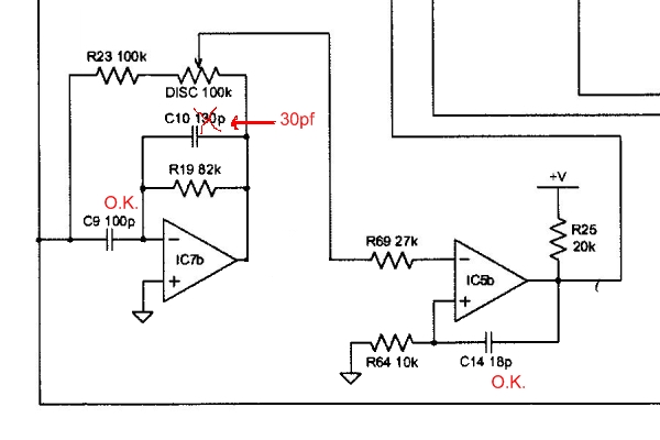

      OOPS!
      In my first message ...I meant:
      I make this mod on mine and that resolved my strange DISC variation range problem.
      O.K. now that's better.
      Salut!
      JF

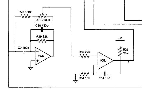

        Another thing!
        Because i changed the front-end amplifier(White classicIII configuration instead of Tesoro umax) ,i had to change only one cap value to the Disc phase shifter.And my Bandido work fine now!
        look to the attachement!...
        If some one of you get positive results with this mod,please to share it here!
        Thanks!
        JF

          That 130 pF was found to be Incorrect LONG AGO.
          Actually My Schematic uses a 22 pF Cap as I found this is Probably the Origional value on the Manufacturered units.
          Drfinately Not 130pF or even 30pF.
          Although 30pF is probably Close Enough.
            Hi! Chemelec tank! for reply.
            I know ,30 pf is near to 22pf with tolrence.
            I Think i will remake another test with the original configuration and the 30 pf.
            It will take few minute and i will report my results.
            Thank again!
            JF
              Hi! Chemelec,you are right!...
              ...Probably i forgot 1 stage in the process.Sorry for the doubt. I obtained approximatively the same patern of discrimination with the 30 pf cap.The only difference with my mod is that i have an extended coin range up to the silver dollar.But all the coin range is a keeper range,so it's not very necessary.
              O.K.! Thanks! for your Help !Chemelec
              My Bandido work fine!
              HH!
              JF

                I think that if too high a value of C10 is used in the Bandito discriminator, then arises the possibility that large iron will be detected when fully CW, but I have no easy way to test that.
                How is it that silver dollars weren't detected before? Seems like something wasn't right. My understanding of the discrimination circuit operation is very fuzzy, at best.
                  Hi! Porkluvr
                  By an extended range of dicrimination up to silver dollar, i mean that you can detect a silver dollar and reject silver quarter at full CW of the control pot.
                  That permit you to see the difference between 1c/10c,quarter,halfdollar and dollar.
                  And if you raise again the C10 value you can reject a silver dollar.Maybe that can permit to see the difference between big iron items and the rest.But i will have to make the test with a greater value for C10 to be sure it can be usable in real conditions.

                    Hi all,
                    I'm sure now that 130pF is wrong there as Gary stated. I found having 22pF is right to reproduce goodrat's diagrams for that part of the circuit.
                    Also with 22pF I get near-to-total iron disc as bandido II must have when in disc mode. Imbalances occourrs only when masses of iron or sheets of it are really close to coil then perturbating too much filed lines.
                    So I think that the magic number is 22 !
                    It's interesting the use of 100Kohm resistor to modify phase shift but I think that this way one can go easy out of disc for iron and then failing rejecting it.
                    I don't know if is a good idea to have 30pF there...maybe if you NT change cap to 22pF you don't need resistor but just original pot.

                        Where did you get That Schematic From?
                        I Have never seen that Arrangement for R23.
                        All the Schematics I have seen, R23 is on the Output Pin of IC7B and Connected to R69, with the Center of the Disc Pot connected between R23 and R69.
                        Gary
                          Gary
                          Hello! Gary.
                          O.K. I know i maid my circuit test a little bit too fast ,and now i am sure your circuit and caps value are good.I tested it with my circuit and it work fine.
                          The shifter arrangment you can see is from the schematic of the Golden umax i got on the Geotech forum few months ago.All the resistor are the same.But the arrengment is different.I only wanted to try this circuit in my bandido for experiment.The conclusion is the difference is minor.
                          JF
