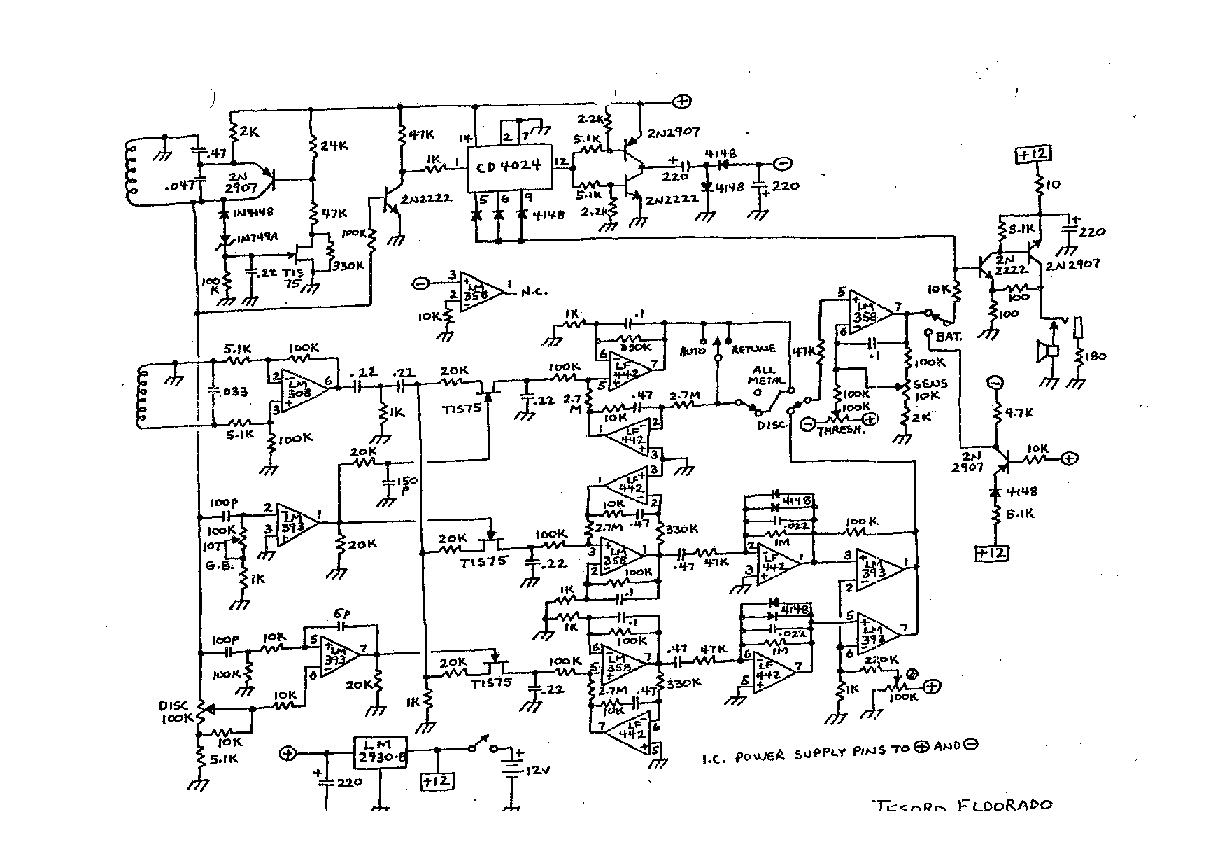

                            Hi Max.
                            Yes i believe that Eldorado is a bit better than Bandido. I don't remember now but i have read this at a test.
                            Take the schematic

                              Hi Geo,
                              thanks for the schematic of eldorado. I'll take a deep lock at geb and disc to figure out differences.
                              At now I'm testing DD 22cm coil on ground and seems I get good results with bandido I've made. Got 1 eur-cent at 20cm in ground...seems good !
                              Maybe eldorado has a bit more depth tha bandido with same coils and objects cause I've noted that bandido circuitry have little drawbacks near IC8 due to partial asymmetry of output levels of comparators...at the moment is just an idea...need to study better the problem.
                              Anyway, tesoro's seems good general purpose and we can test them cause uMax models don't require any programmed device.
