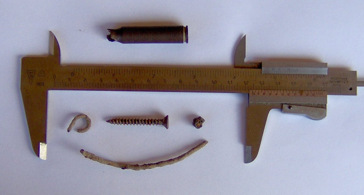

    Hi all,
    here are some founds made with my BandidoII uMax on the test search field.
    Above the tool is another shotgun shell that I've found at about 20cm depth.
    It's made of brass. From a research I've made it results to be from a "Mulliker-Carcano M91 war rifle" ...no-comment man...
    OK
    cartridge is something years 1929-33 but I'm not
    sure if it's a standard type or something special bullet e.g. soft-head that I know
    were made too. I've found another but this is in better shape.
    Then under the tool you can see what's really surprised me...
    are all IRON objects of some kind. A modern wood washer made of iron-alloy, a round
    piece of iron-wire, another piece of iron wire that seems were galvanized with zinc
    but then now really oxided, then on the right a small unidentified part of iron too...
    that to me seems like a small pipe looking at its shape.
    NOTE THE DIMENSIONS OF IRON OBJECTS: THEY ARE ALL SMALL !
    I've found the washer at 6-7cm depth, the round wire at 3cm, the "small pipe(or whatever)"
    just under surface (few mm I think), the bigger iron wire at 12-14cm.
    Problem is that objects are well signaled by bandido I've made...so I can't understand
    why cause they are much smaller than original items of iron I've found on the searchfield.
    Again, pinpointing is easy enough to find them in less than 1 minute each...but then what
    a surprise...
    Cause a casual and rare horse shoe is not a big problem...but if one have to dig all this stuff
    WOW... what a discrimination ! We can also leave unused disc at all and dig everything like we do in all-metal search for relics.
    I was thinking that these kind of objects are rejected by bandido ...I'm really confused now...
    Is just my unit problem to dig such smaller objects or maybe I need to change something in
    my bandido ???
    Can some kind of chemical treatment (e.g. zinc plating) caused this sensitivity to that small items ???

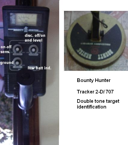

      Another detector wich reject also great iron objects, but sometimes you hear a "rash" in his presence (OK, you can check for curiosity), is the cheap double tone discriminative MD Bounty Hunter model Tracker 2-D/707. This is very sensitive for small no iron objects and has options for all metal, discrimination and level, ground control, sensibility adjustment and low batt indicator. Maybe is not "very professional", but his good for reject almost all iron objects. Don't experiment in wich grade iron objects can mask other valuable items.
        Yes i had that BH once....Excellent discrimination, two tones....
        But depth is low...to low....Anyway good for shallow targets...
        Also price is low, some 40-50 euros for it...
        regards!
