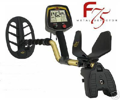

OK, who has one? Does this machine have negative pulses?
Fisher F-75
Negative
Hi Carl.
Fishers usually have the tip as positive, the ring as ground and the sleeve not used. However some machines have the pulse in a negative polatity at the tip. I have a customer that has no output on his F-75 on a headphone model I used to make that has a diode in series (it has a circuit that allows you to vary the tone to the speakers).
So I'm trying to gather info on the F-75.

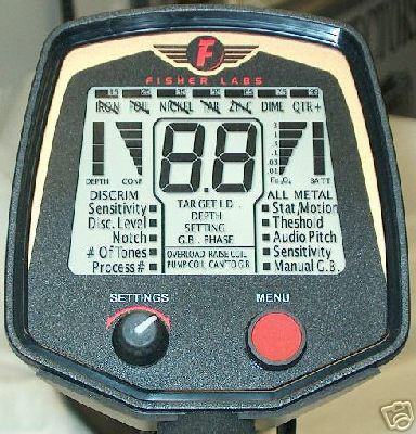

.....Although respect Fisher much, i dont like panels like this!
To much playing through menus.....
Reminds me on cell phone...
Anyway i do beleive it is hell of a machine...
Looking forward for some tests...

The F-75 us unlike the other Fisher detectors. Fisher bought Technetics and made improvements on their top model, the T2, calling it the F75. The F75 is basically a Technetics T2 with extra bells and whistles, as well as a claimed slight improvement in detecting strength. The Audio output will work with any standard headphones. All the signal processing is done before the audio stage, so the audio does not have large +/- voltage swings depending on a target.
I own a Technetics T2, I agree the F75 has tons of menus. What I have discovered is that most of the menus on the F75 as well as the T2 are for making adjustments in the discriminating mode, and I rarely use this mode. In the all-metal mode, these detectors show a visual ID of the target on the screen. When switching to discriminating mode, the electronics simply filters out some of the targets so they do not appear on the headphones or screen. All the menus are concerned with details of filtering and discriminating different signals. In addition to regular discrimination, the F75 has several hunting modes of factory preset discrimination settings, and it is also capable of filtering in an adjustable notch mode so you only see a narrow band of targets.Originally posted by Ivconic.....Although respect Fisher much, i dont like panels like this!

Discrimination menus that only clog up the panel face and do not add any detecting ability. I guess it doesn't hurt anything to have it there if you don't use it.

So maybe someone can hook up a T2 phone output to a scope? I'd like to know the output wiring/polarity and maybe peak output voltage no load, peak with known load (to calculate the output impedance), highest duty cycle.
I wish the manufactures would actually put specs in their specs. That would be nice!
I called Fisher...
I just got off the phone with Fisher.
The line in the manual "Mono headphones will not work" is not accurate. It should read "Headphones with a mono plug will not work".
Inside the machine, the tip and ring are shorted together and the sleeve is ground. This is a mono output, but a mono plug would short the output. Also the output impedance of the F-75 is 274 ohms with a peak of 6 volts (no load). Highest duty cycle is 25%.
