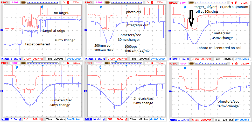

      A test. Target, three layers 1x1inch aluminum foil swinging from a pendulum 10 inches above coil. Varied swing distance to see the effect speed had on signal strength. 200mm coil. Target is glued to center of a 200mm disk to cover photo cell(centered over coil about .4inches below disk) when the target is over the coil. Sweep speed, meters/sec=.2meters/cover time(sec). Target at edge, signal about half target centered.
