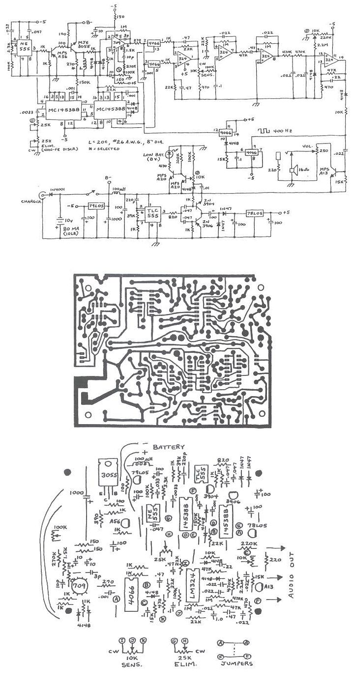

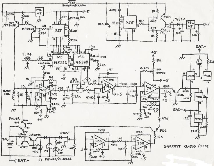

. You have right but take the XL500 schematic and look at the 709. Both schematics have yhe same circuit and componentsat the first op.amp (for me 709).
