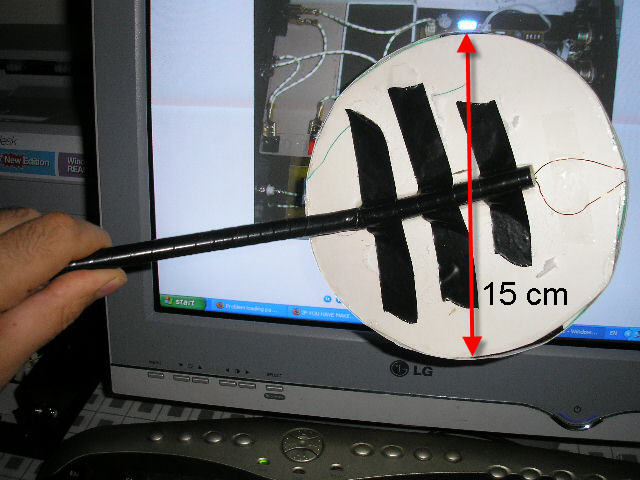

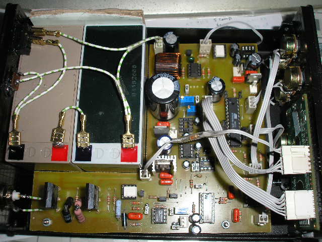

                            This is my new version minipuls-3.
                            I use in this , two 12V/1.2Ah battery and two V-MOSFET (with little change in peramplifier)
                            and detect with small coil (15cm) , 50cm * 50cm metal plate at 150 cm .
                            you can with a little thinking and good idea make this metaldetector better
                            because this is very simple .
                            if you have good idea I enjoy for listen and testing.
                              Hi Sisco.
                              If you detect with small coil (15cm) , 50cm * 50cm metal plate at 150 cm then i can tell only one..."Perfect ".
