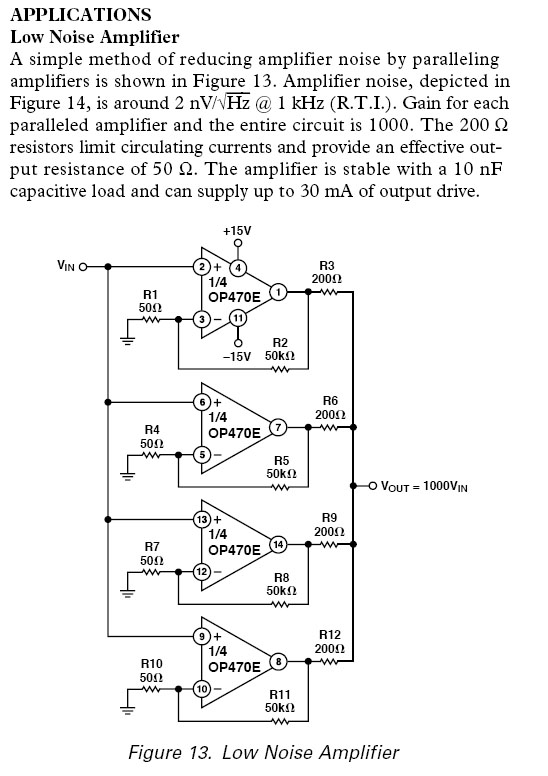

    This is an audio preamp circuit, but with slight mods to the gain path makes a cutting edge P.I front end. Minelab use AD797 chips in the front end but these become unstable at high input impedance. Using a J-fet input negates the negative effect on stabillity that is caused by off time of the front end.
    Noise is still 0.9nv/hz so it makes for a fantastic building block.

      Low Noise Fet I Use
      Hi Woody,
      These are the low noise fets I use
      in my home built PI and VLF detectors.
      Have used the Fet/opamp deal for decades.
      Works well, anyway Interfet likes to sell
      quantity so have to give a story and get
      samples.
      Use two and get 0.25 nv/rootHz.
      Hi Wizard,
      Yes, that is a configuration that was
      actually used on an old VLF detector,
      I don't remember which detector but
      it was older quad opamp, not OP470s.

                    Front End
                    And it is easier to read. Then stuff all strung out all over the place, and to a computer it is probably not much bigger in memory or anything.
                      Don't need no feedback
                      And when you are designing your front end Fet electronics save yourselfs some trouble and a simple grounded source fet with a drain/gain resistor based on gfs of about a gain of 20 to 30 then AC couple to the op amp more voltage gain. The voltage gain of 20 to 30 will make all the noise spec fall onto the fet and virtually none on the op amp. 1/A^2 of the first stage. No feedback to the fet. or you can feedback if you wish no biggy as long as you don't have any trouble with the oscillations.
                        common Low noise design
                        The Wizards design is common one in parallel, one can use LT1028 too. Or use low noise opamps cooled by liwuid nitrogen or helium....

                          The Wizards design is common similar circuit from elecktor old edition 1997 or older in parallel using LT1028 too. Or use low noise opamps cooled by liwuid nitrogen or helium....
                            costly
                            Whats the noise now cube/sqrt of the three!!! also the opamps are costly cant we use a low noise japanese Transistors in parallel !!!!
                              yes you can

                              Hey Sharky,
                              The old Corbon {misspell} does use transistor amplifier for
                              front end. He also uses analog switches to turn off input
                              during xmit. Good move. now you can have low noise fet
                              and then follow with transistors amplifier. Or if you are real
                              good you can make fet/transistor amp that recovers from
                              xmit flyback fast {hint don't saturate transistors or fet}
                              and get rid of the switches tooo.
