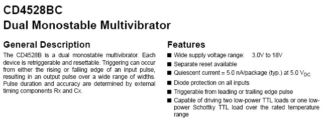

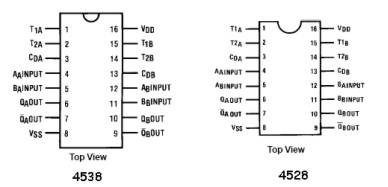

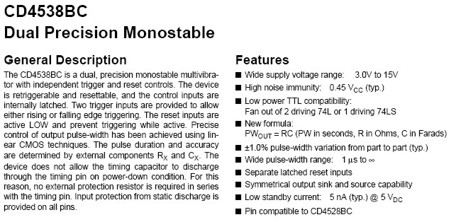

    Here is question for everybody;
    is it making any difference if i replace 4538 with 4528 ic???
    For example i can check this at Delta Pulse setup.
    According to datasheets those are replaceable.
    What do you think? Any suggestions?
    4538 - 4528
    Yes it does, in precision designs, the 4538 keeps better tolerances than 4528 and can actually produce very good narrow pulses.
    It may not really matter in some cases.
