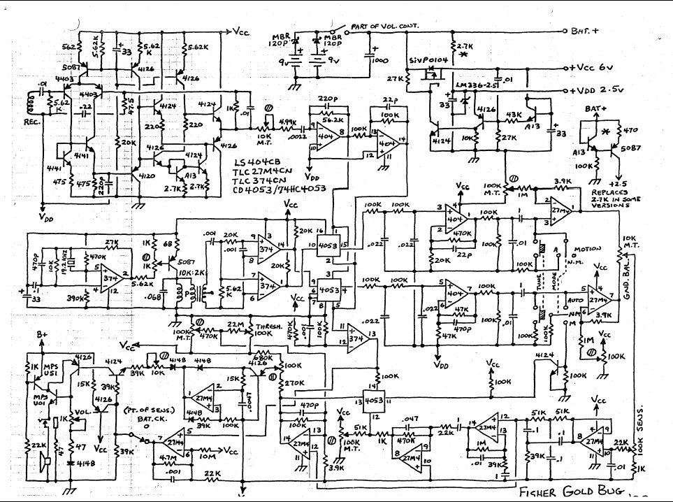

      Hi Nelson,
      I have this... don't know if yours is different.

        Hi Max and thanks for the schematic of Fisher Gold Bug.
        Indeed it will help me a lot, while is not Fisher Gold Bug 2, can give me an idea about his tech.
        I m also planing to run this machine with one acid battery, instead of those two 9 volts batteries that are also expensive. Any ideas on how to do this.
        I have a 12 volts 1.2 amp battery, but i need to run with 9 volts.
        In advance many thanks

          it's easy... some ideas:
          1. Use a 7809 regulator... you'll get 9v well stabilized and just add two capacitors of 470-1000uF at input and output to filter ...nothing else needed.
          2. Other solution... use an LM317T in voltage regulator config... use a trimpot to set 9V output.
          3. Other solution... put in series a 3.1V zener diode (catode of zener to + lead of battery)... then the anode of zener is your + output lead (about 9V)depending on current need by circuit you have to use 1/2W or 1W zener diode. Problem is that voltage at output follow drop at battery.
          The first is really easy and effective cause you want use it with lead-acid battery so you can search many hours before battery voltage drop under the dropout level (3volt dropout so...about 12V at input) of regulator. With battery fully charged you'll get about 12.7v or more... so more than enough to get it work.
          If wanna use at lower battery voltages you have to use LM317T or a low dropout regulator like KA78R09CTU or TA78DL09AF.

                            By the GB schem it uses 9v(bat+),6v(vcc), and 2.5v(vdd), which are sourced from the 9v. I would be wary about the GB2 though. The 2x9v suggests to me it may use 9v+. 0v, and 9v-, making a single 12v unsuitable. Perhaps ICL7660/LT1054 and 7809 and 7909, as per Baracuda schem would work?.
                            As the GB2 is a current model I am reasonably sure the schem is not available, or at least would not be published here. However it may be similar voltages, just with the second 9v for sound, or extended usage time.
                            2x9v Alkalines at Woolworths here $5. Not really a prohibitive cost.
