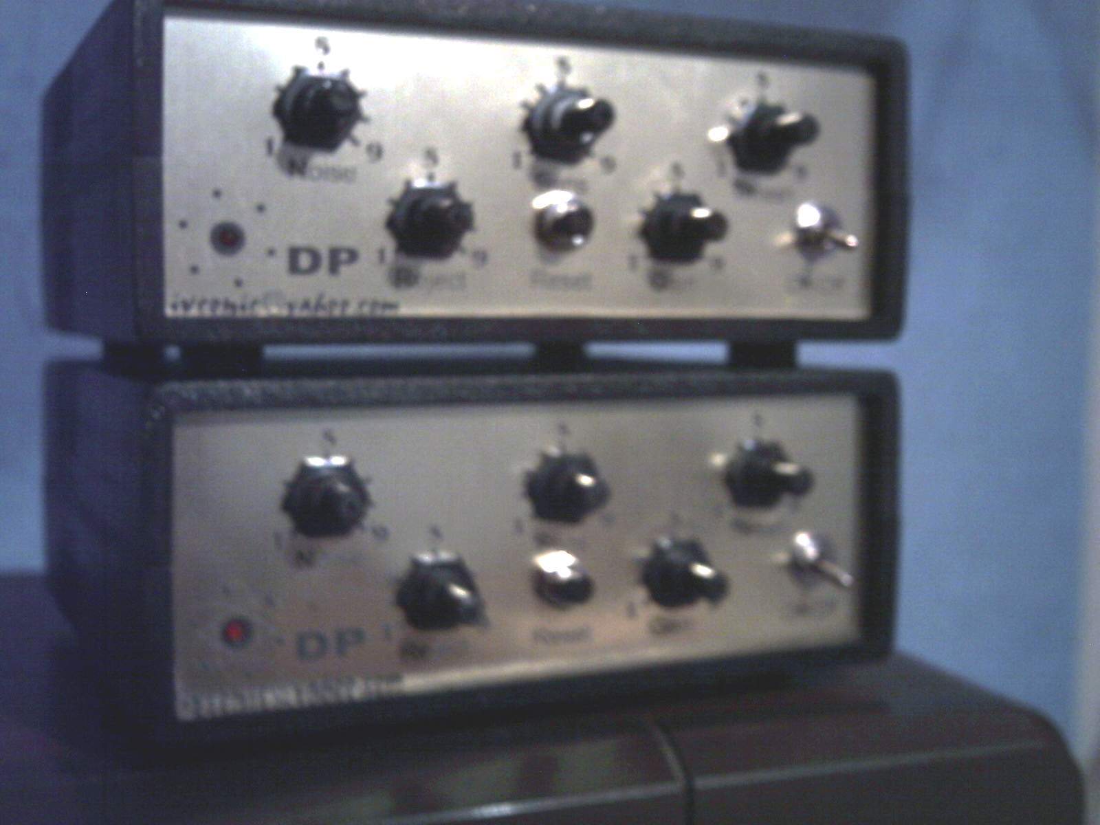

            Well, in case of Delta Pulse i used ready made,general purpose housings.Those are suitable due fact DP is PI usually carried on the belt, not on shaft....But in case of smaller VLF such as TGSL, it would be unappropriate to use simple,square box...It need small,well designed,nice housing with possibillity to mount on shaft...Such boxes-housings cant be finded at shops as general purposes. Ican find only square,brute...ugly boxes, usually made from recycled plastic....buuuiakk!

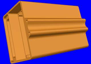

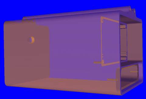

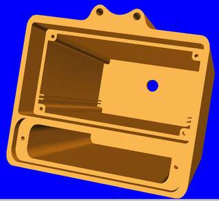

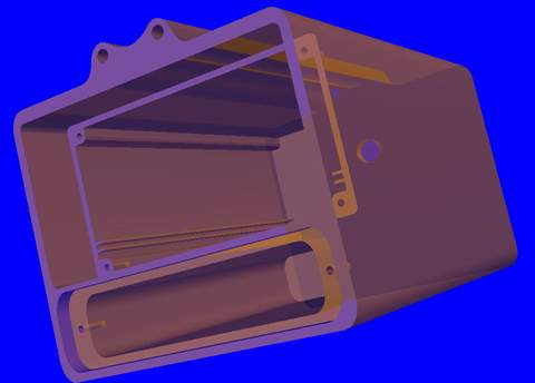

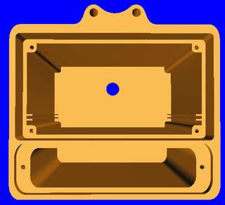

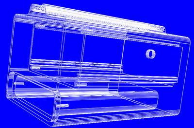

                            So i played few hours with this software....I designed one box/housing.
                            Uncommonly shape and sizes cose i wanted to put everything inside. My TGSL pcb is 120x65mm. Also i put lower space for batteries...
                            Not bad...this software! Not bad at all! I just need to learn it more...There were few things i wanted to change here, but didnt knew how!?
                            Anyway good for a start...
