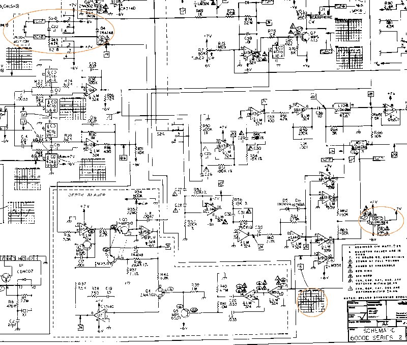

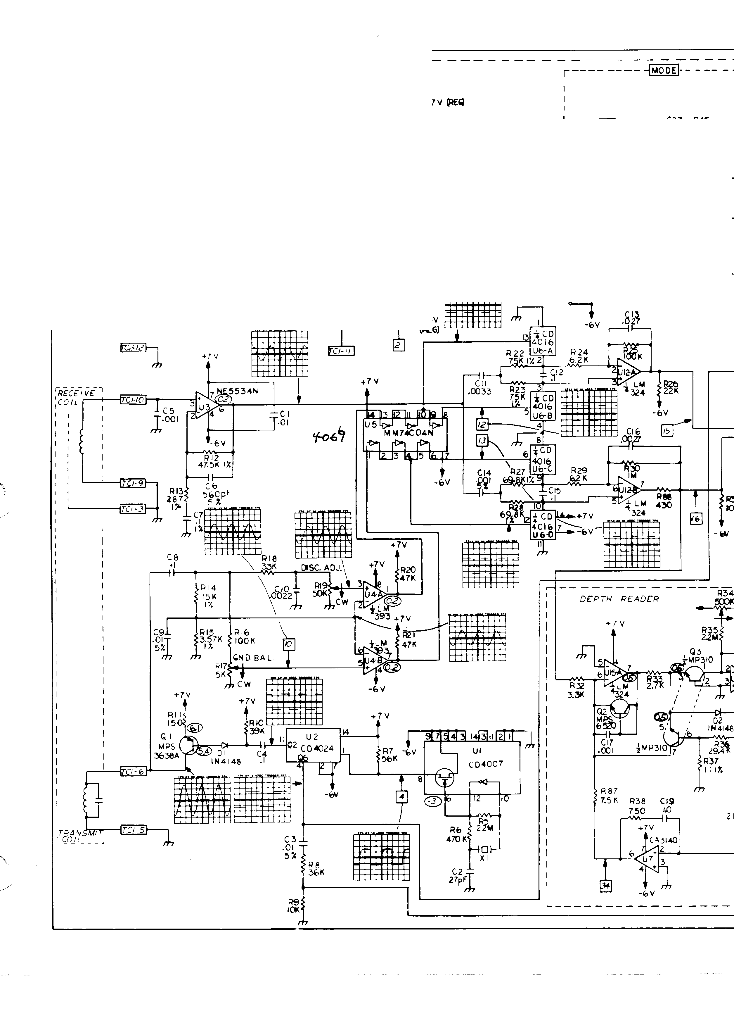

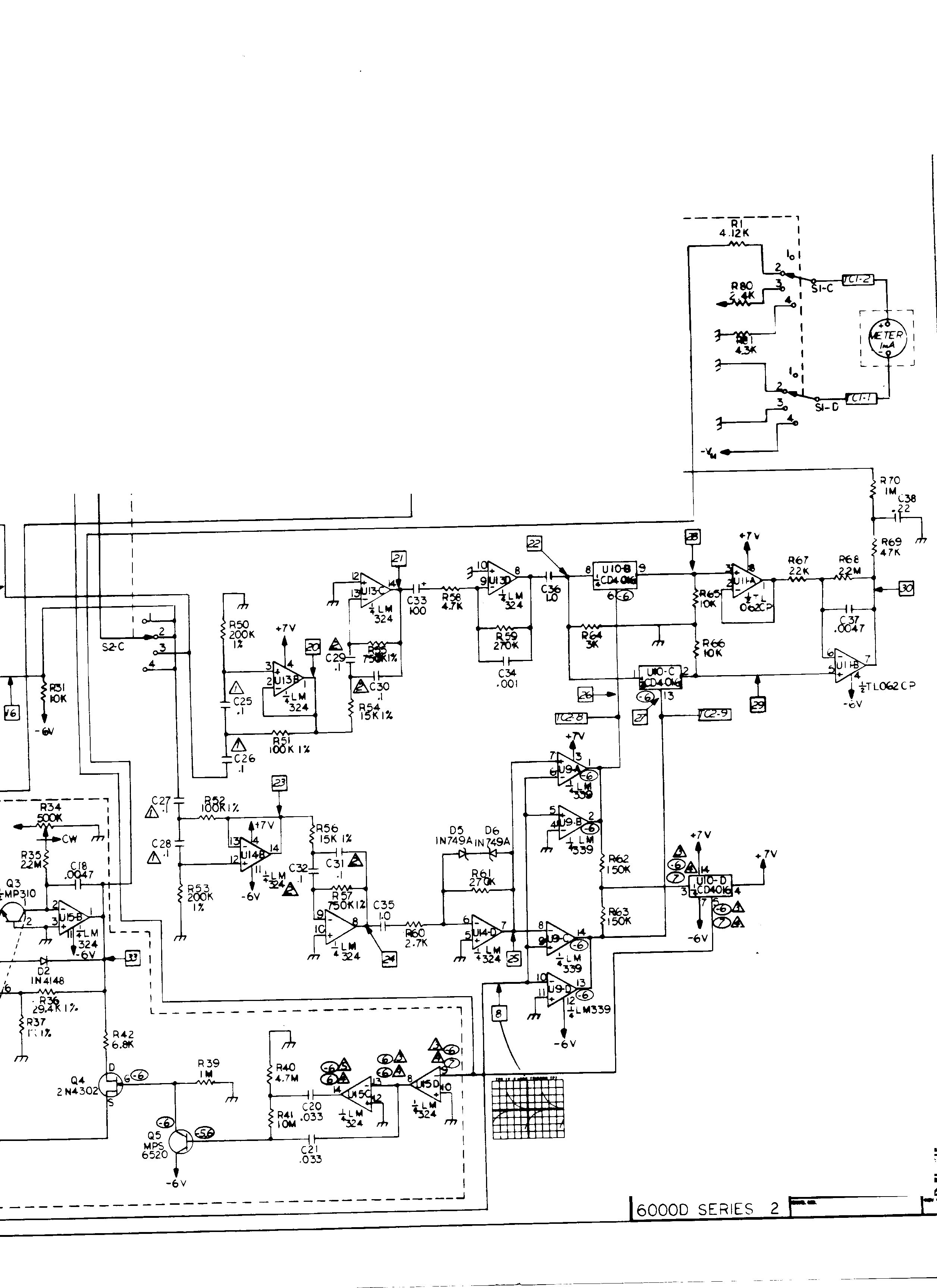

    Last time i study how works and how to construct a depth reader. I believe that it is time to design and construct a general purpose depth reader, so we to have the ability to connect it at the most detectors. So i need your opinion. A good place to see how it work is the schematic of Whites 6000D-2 and newer. Or everyone that knows any patent about it.... he may attach it here.
    For start i attach the shematic from 6000D-2 with the depth read. It take 2 signals, one from oscilator and one from the out of GEB. The out of the depth read is going directly to a mooving coil instrument.
    Now how does it work ???? Does it measure the time delay between Tx and Rx signal .....Or..........
      Hi Geo,
      I don't know well this white's model... or its feature of depth meter...
      and also circuit of it... so my are about guesses and advices.
      If the coil is a normal TX-RX with just one RX coil like in schematic then the depth estimation must be done by using some tricks... I think this is a case.
      Have you to push the button for having the depth reading ?
      If so... ok... maybe something happens when you push that button... I mean some analog gate could be in conduction or not... then "something" happens: actually I think that there you have investigate... if e.g. some stage change its gain and the like.
      That way you'll find the solution.
      Another thing... have you tested it very widely ? Gives sometimes errors like indicating a little mass at few cm and then you found a large thing depeer ??? If so... you can be confident that the "trick" is around gain setting for RX stages.
      Best regards,
      Max

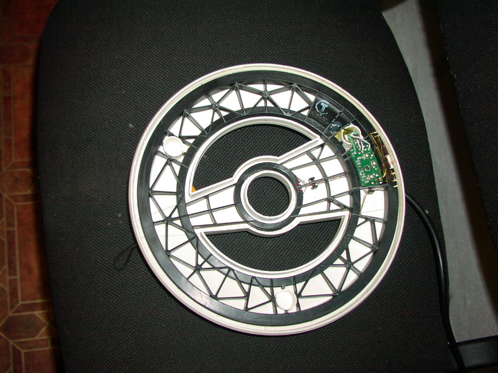

                            Nice Pic
                            Hi Geo,
                            Nice picture of the insides of the 2500 coil/s. neat.
                            You may need two eyes to see depth.
                            and two speakers to hear stereo.
                            Or maybe not, but if you figure it out let us know.
                              Originally posted by JC1 View Post
                              Hi Geo,
                              Hi JC1.
                              The photo is not mine. I don't remember good but maybe Ivconic post it here before 3 years
