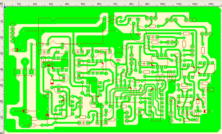

      There is a forum on the same site, the people that have built the ATiny-4 give good results, I have ever had the plan to make it, made the layout in SprintLayout-4 , but never made the pcb , so there can be errors in the layout ! The original layout can also be used, but i found the pads to small.
      Best regards.
      Ap

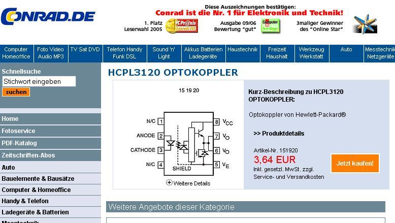

            Your right, there are some parts that are not easy to get, the opto is for sale at Conrad.de , not cheap.

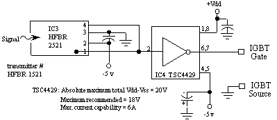

              yes it's an insulated gate driver (2.0A rated output) for IGBT thing.
              Here is datasheet. It's not easy to find and , as far as I know, it hasn't any direct replacement... so if one can't find it he must do another way... using e.g. some discrete components and ic to drive gate... then bypass the problem.
              PS: mouser.com has it in dip8 and cost is $2.21 each so about 1.5eur each, but you have to make international order (they are in the USA... and Europe site will mail you stuff only if they have in stock there...otherwise from US... anyway you'll pay much more than 1.5eur about shipping).

                    HCPL3120........ Ohhh yes, more expensive but it had it.

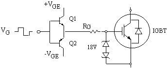

                          Why you don't use directly transistor like this circuit:
                          https://www.geotech1.com/thuntings/a...1&d=1195453471
                              http://www.thunting.com/geotech/foru...1&d=1195453471
                              You have right but i want to make it exactly as is because it says that can detect at very large depth so i want to be sure for the components when it will not detect at this depth
