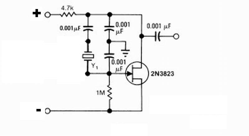

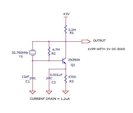

    Dont know....maybe i miss the point...but what do you think about this?
      Huh! Sorry! I am aging for sure! This is not sinusoidal......Sheeesshhh!
      Sorry again!
        or...
          or......

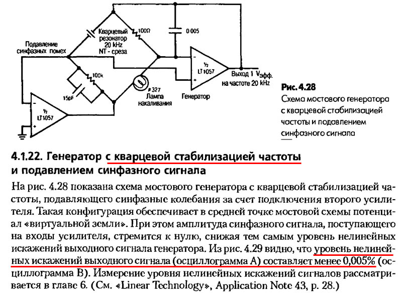

              Find shematic of generator with Vin(Win?) bridge. There is a lamp with glow filament in negative back connection. It can be used as amplifier and corrector of input signal.
              Or you can use DDS .

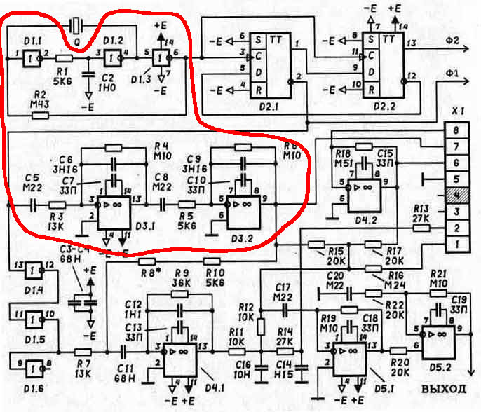

                this is a task and a schematic part of Schedrin's 'one-coil' detector. this generator is not good and gives fluctuations of some harmonics. it is the promlem. I see only one from a copy, but I hope maybe there will be all-on-chip generator? I repeat for Dear Ivconic that generator distortion must be very low for this metaldetector type.
                  maxim
