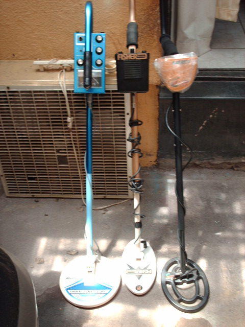

    Hi all.
    Does anyone knows if old Bounty Hunter VLF TR 840, can be use for gold or meteorite hunting?
    This detector is a no movment and by this days with the knolegment i have achived here , while i was constructing other detectors, i knew how to ground balance my detdctors . So with this ij mind, i took my ols BH vlf tr 840 and i tried to GB pumping the coil up and down. The detector gots GB and now i can get better targets with it.
    Indeed if anyone knows any mods for this detector, like how to get a DD coil, please share it.
    On the picture, are some of my detectors (BH VLF TR 840, Fisher Gold Bug2 and Garret ACE 250). Also i have two Clone PI and one Tesoro Golden Sabre, not on the picture.

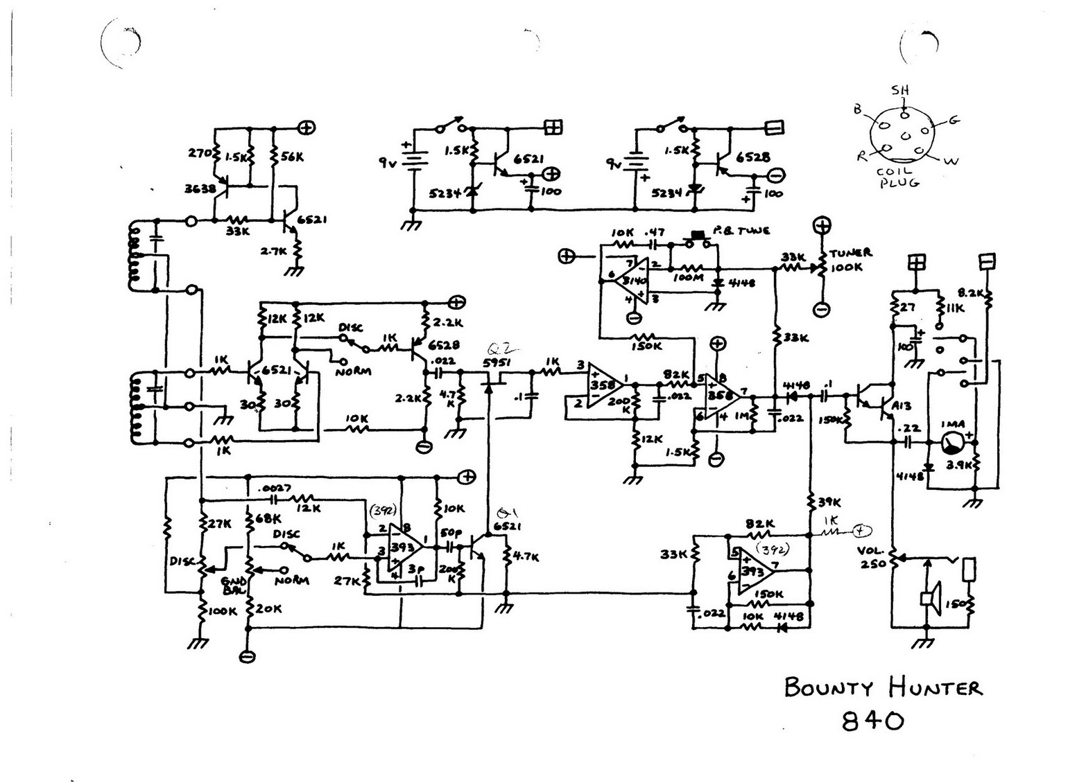

              Bounty Hunter TR 840 schematic (draw - W.Lahr)

                Hi Mrand
                Thank you. Another good reverse engineering from W.Lher,
                I also am searching Mr. W.Lher email address.
                Very best regards.

                    Mrand, thanks for schematics, cause i know i have it, but in some CD. The problem is that i have a collection of almos 500 CD´s, so you can have a picture of how hard is for me to find it. So many thanks.
                    Aft72005, no i don´t know the frequency and very important point to build a bigger coil. I heard that this old detector with few mods can by used for nuggets hunting. Not so shure of this, but i ll try this weekend to measure the frequency.

                              Hi friend Nelson
                              Please determine values of disc and gnd bal pot.
