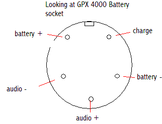

    Can anyone tell me the plug pinout for the GPX4000. This is the power - audio plug on the detector unit thankyou

          yes is different ... also different audio - power plug...
          any one have pin out on this... mainly positive and negative pins on unit box or power box

              This was posted on the MSN forum.
