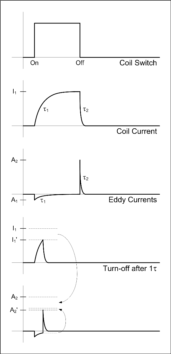

            Here is a graphical representation of what happens with premature coil turn-off.
            The first plot is simply the coil switch. The second plot shows the coil current (the magnetic field is proportional to this). The rise time of the current, tau1, is determined by the L of the coil and the series resistance of the coil, cable, switch, and battery (or tank). The resistance is a few ohms typically. The fall time of the current is set by a different tau... same coil L, but the R is now mostly the damping resistor, which is a few hundred ohms. Since tau = L/R, the higher R makes tau2 much faster. Let's say for example that R2 = 100*R1, so tau2 is 100 times faster. This is pretty typical in a PI.
            The third plot shows the waveform of the target's eddy response. Eddies are proportional to dB/dt (and therefore dI/dt), so if tau2 is 100 times faster than tau1, A2 will be 100 times larger than A1. Note that A1 is negative; that part of the waveform represents the residual eddy currents in the target.
            The fourth plot shows coil turn-off after 1*tau1. The current in the coil (and therefore the B-field) has reach 63% of it's peak value. The final plot is the resulting eddies... the 37% reduction in B-field directly impacts eddy amplitude by 37%. But the residual eddies started out at 1% (A1), and have reduced by 63% at turn-off, so their impact is 1%*37% = 0.37%.
            So, in this example, B-field reduction impacts target signals 100 times more than residual eddies. In general, the ratio is tau2/tau1, or Rdamping/Rseries.
            - Carl

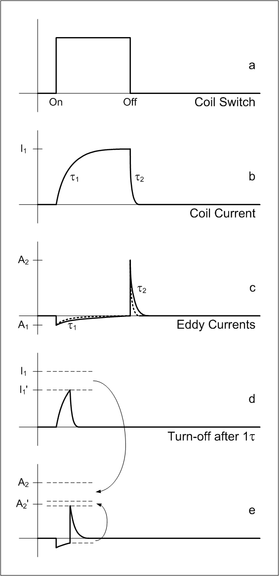

                          Now, my interpretation is the target response is limited by the target TC so once this target is saturated, then no further increase will occur in the target signal decay once that happens. Thus, the target decay time has reached its maximum.
                          Yes, target response is limited by the target TC, which I failed to account for in the plots. But for the issue of residual eddies at turn-off, it doesn't matter a whole lot.

                          Yes, but only because you've reached the peak current faster. It should have no effect on target response.
                          My analysis was a reply to the question about overly short turn-on times, and the comment I made in the HH article about the turn-on state not being "settled out" (steady-state). There are two components to this. One is that the current is still increasing and has not reached its peak value. This results in a weaker peak B-field. The other is that, as long as the current (and hence the B-field) is on the rise, the target has reverse eddies flowing in it. They will directly subtract from the desired eddies at turn-off.
                          I used to think that the second component was at least significant, but upon further thought, I believe it is in the mud, at least for the typical mono coil PI front-end design. The only component that matters is the B-field strength. As you leave the coil turned on for longer and longer, the B-field peaks out, and the target reverse eddies decay to zero, so leaving the coil on any longer has no benefit, but no detriment either.

                            Here's corrected plots with target TC added. Premature turn-off still will be dominated by B-field reduction, not residual eddies.
