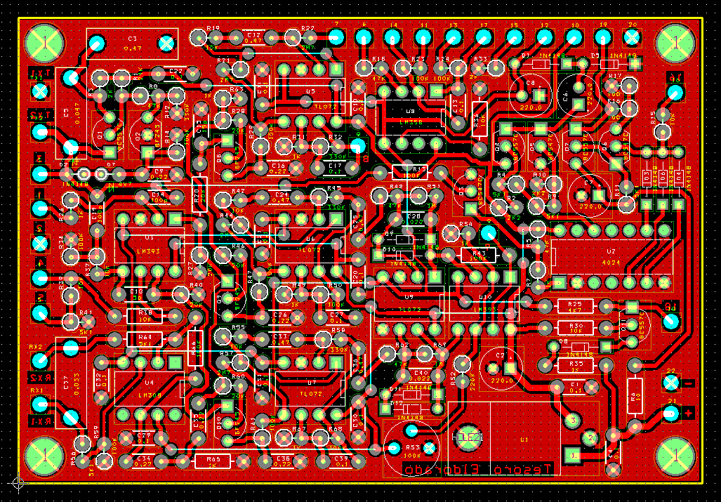

          PCB variant.
          • #50
            Hi AndyF
            This PCB very good designed.
            Are you test it?
            Best regards.
            • #51
              Originally posted by Andy_F View Post
              PCB variant.
              Hi Andy,
              seems very nice PCB! Very good you're sharing that !
              I'm on troubles now... cause tempted to try that design too!
              I'd like to have your impressions on how the prototype you probably made performs... just to know about e.g. stability and relative noise influence.
              From my point of view the pcb is really compact and good made but we have to consider also the effects of having near lot of ics and eventually what's noise propagation there and if it will create instability.
              As an example, I made a good TGSL thing with the Vladimir's PCB design (a really nice one, very compact) that seems good until I made the Ivconic's pcb one (the gift pack) with my little extra mods on audio.
              Well... have to say that, though both works as expected, the Ivconic's modded one is superior about noise reduction... works pretty much more stable than the compact one.
              Woudl be nice hear from you impressions about.
              Kind regards,
              Max

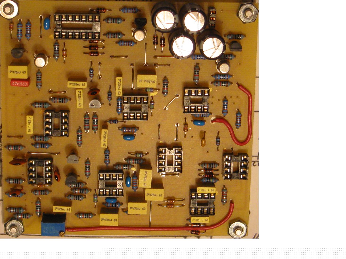

                  Eldorodo Project
                  Started work on new Eldorodo project. This is Ivconic 1265 PCB resized slightly. Installed most components and jumpers. Managed to put a couple a IC socket in reverse....damn!!!!! Maybe should sleep more and work less, but this fun right?.... YES, YES it is!!!!
                  Found nice aluminum box for project, so will be mounting pcb and controls next....

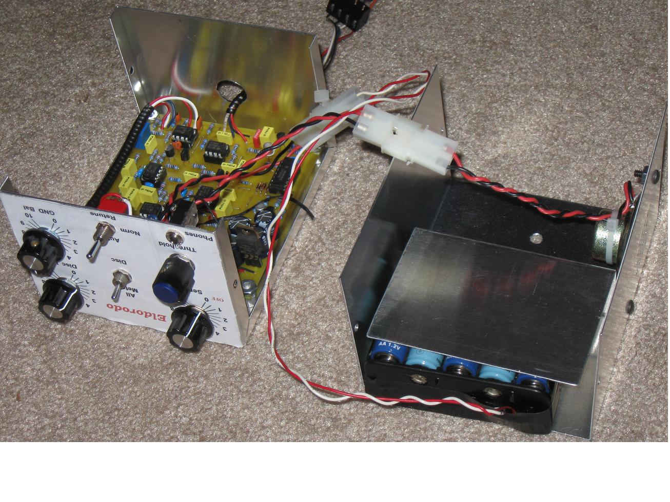

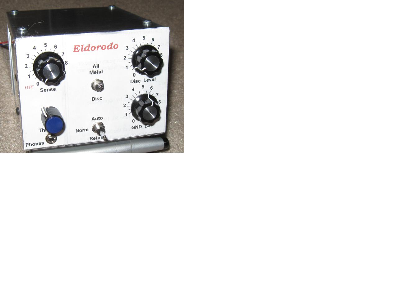

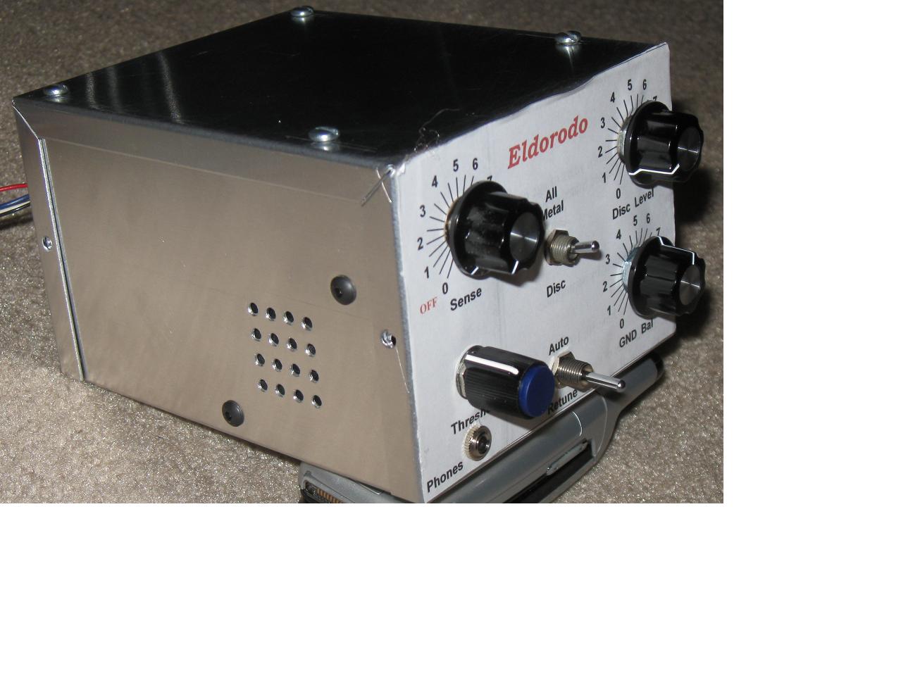

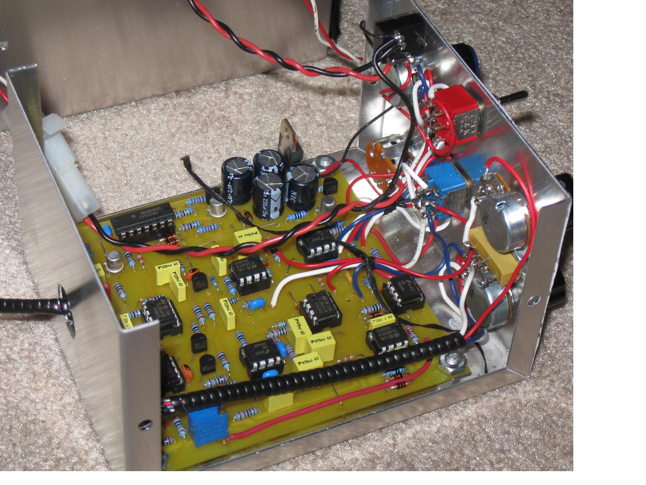

                                Eldorodo Build
                                Finally put final ICs in Eldorodo tonite....hooked up old Tesoro 10" coils and turned on .....not working!!! @#%#$
                                Lots of crazy beeps when playing with threshold.......
                                Got out meter to check voltages etc... found batery voltage only 5vdc...WTF! Then realize stupid mistake, 6 of 10 battery cell are dead... when I did battery compartment metalwork I just used anything I had lying around to use for dimensions and weight.
                                Hooked up good power and......works!!! Will do more tests and tuning soon... some pics..
