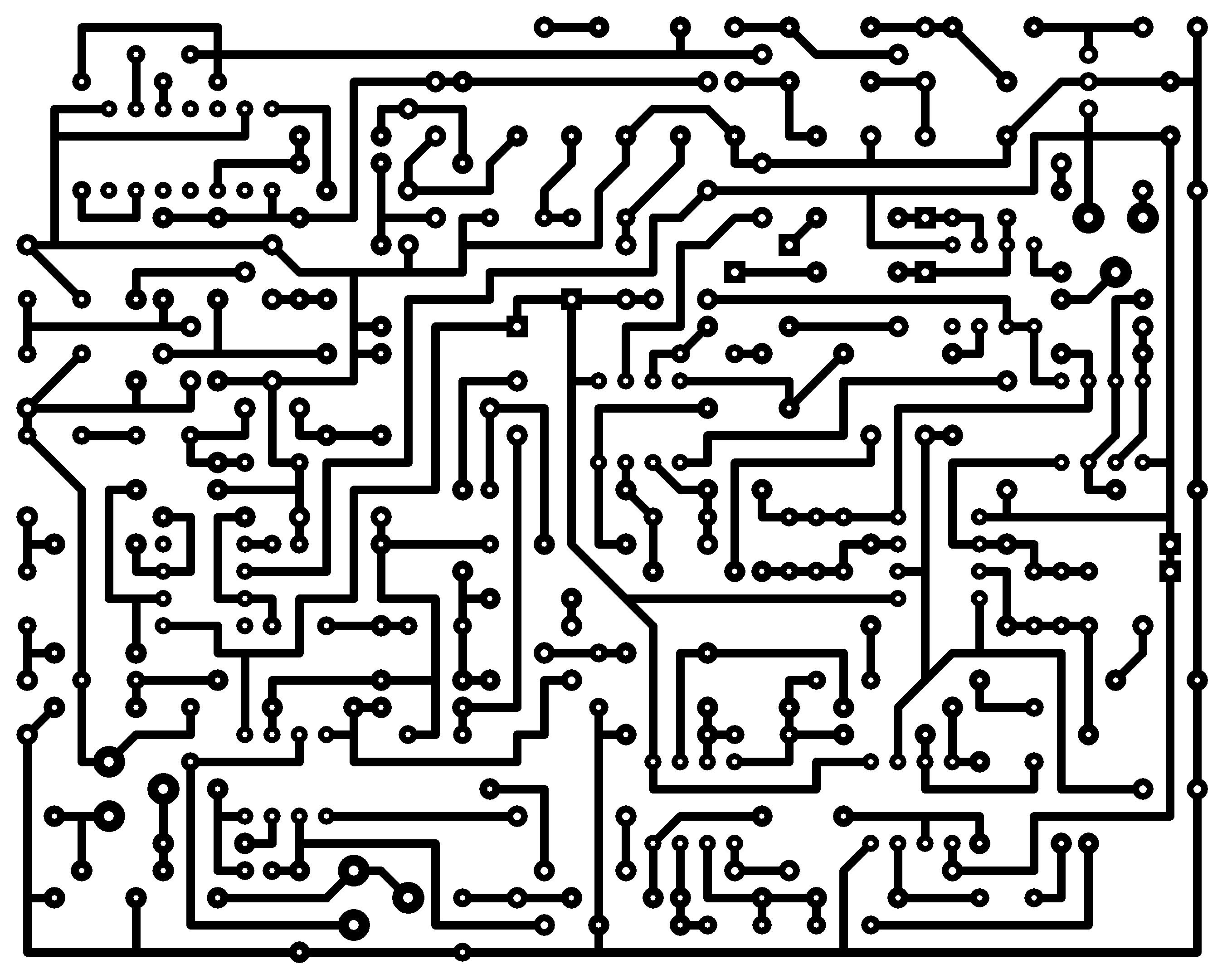

    hi can some one post pcb in bitmap format and without components
    thanks
    • #77
      eldorado pcb bmp
      check the size
      • #78
        uj
        thanks for your help but i need pcb designed by ivconic cause i havent licence of Sprint Layout BR!
        • #79

          • #80
            thanks for all finaly i found cracked version of sprint layout now i can start project
            • #81
              sorry this is correct and resized typon
