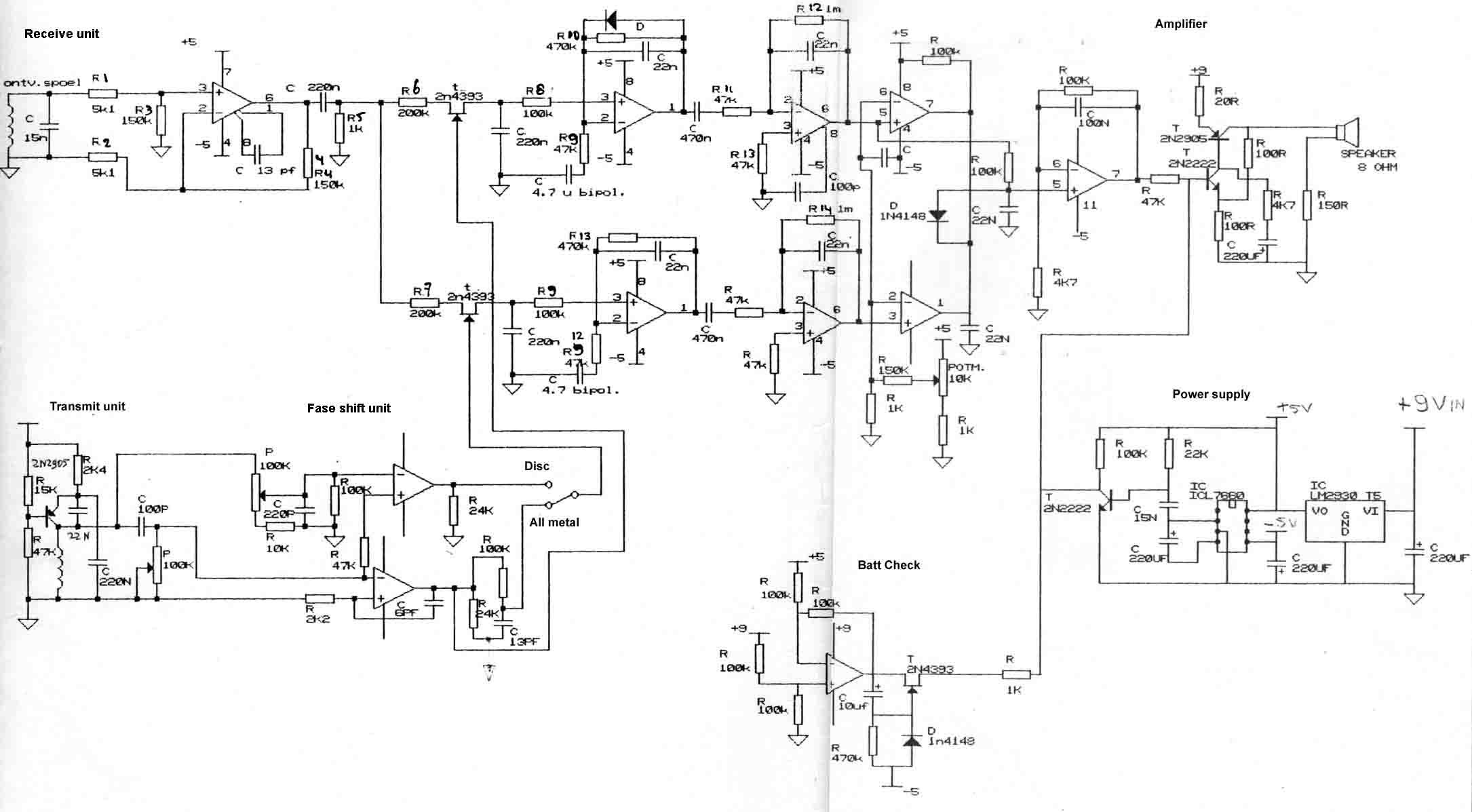

    Sorry, can someone tell me what metal detector is this scheme?
    Tesoro one.
      It seems to be Tesoro
        The image is labelled "metal_detector_drawing_01_silver".
        As others have already stated, this looks like a classic Tesoro circuit.
        It doesn't seem to be a Silver Sabre 2, or a Silver Sabre Plus. So it might be an original Tesoro Silver Sabre.

          Yes, it is from tesoro ,can you determine ICS specification ?
            I forgot , may be that circuit with manipulation because all of tesoro circuit
            Which I saw yet without 7660 ic.
              Schematic
              Well... you all are right, I drawn that circuit some 20 years ago ( wow.. getting old), the basic for it were the silver/golden. Never made it as pcb so there can be errors in it !

                Hello, so this scheme is higher than the silver sabre 2?
                  Hello
                  Well it was some 20 years ago..., I think it was most silver ( the first one)

                          Yes, but I need a picture of the real original pcb to see if there are errors.
