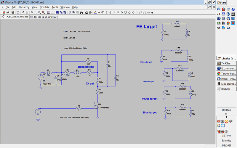

      Looking at the TC2 of the ground response above, I just realized that a problem I have with a damping resistor R5, might be turned into an advantage.
      Below is a simulation circuit. The inductor L3 with Resistor R5 form a high pass filter. Choosing the right cutoff frequency it might be used to mitigate the T2 response.

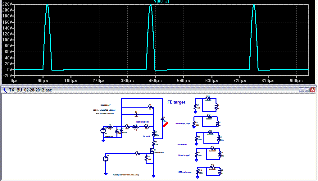

              Tinkerer, please explain the problem, how to simulate it and where is the output point. I see only butiful TX pulses.

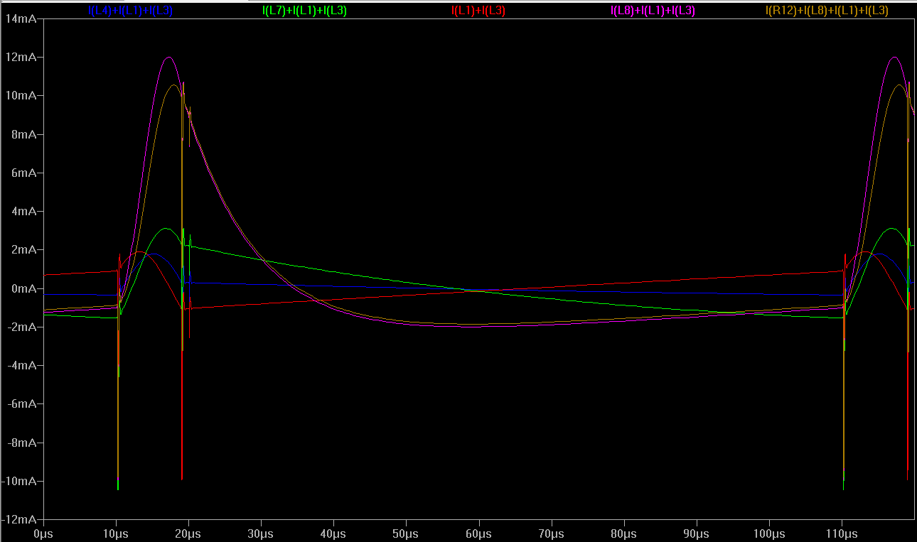

                  Thank you for the interest. I attach the picture of the traces. On top you can see the formulas I use.
                  L1 is the TX coil
                  L3 is the Bucking coil the sum of TX+BU is the balanced coil.
                  Adding the target response to the balanced coil trace (red) we see what the actual output of the RX coil is.
                  This is an actual real circuit that works. I try to reproduce the traces I see on the oscilloscope.
                  When we balance the coils, sometimes we get a little movement when potting the coils and the balance is upset. I have used a pot at R5 as current bypass to correct unbalance.
                  R5 has several functions. It is damping L3, to avoid HF oscillations.
                  However, when simulating R5 for best damping, I noticed that it also influences the response of long TC targets, as HP filter.
                  You got the Flyback pulse on your picture. I prefer to look at the currents as this is what I see at the RX pre-amp input.
