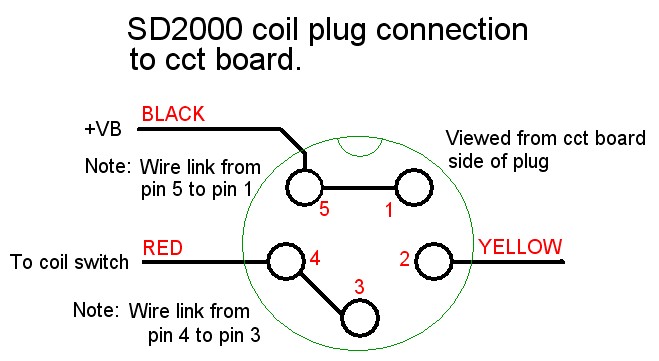

    I recently purchased an sd2000 from a guy that was going to mod it. He detached the plate that has the coil connection. There is a red, black, and yellow wire that goes to this coil connection. However, there are five terminals on the connector. Does anyone know which wires go to which terminal. The terminals are numbered 1 through 5 going clockwise. These numbers are also on the plug on my coiltek coil. Also, the guy lost the ferrite ring that goes around these wires. Does anyone know a part number for a replacement or whether a clamp-on ferrishield will work?

    Here ya go James
    If you want a little ferrite thingy try giving m/lab a ring,all though i find the detector works ok with out it.
