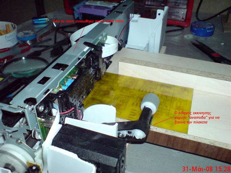

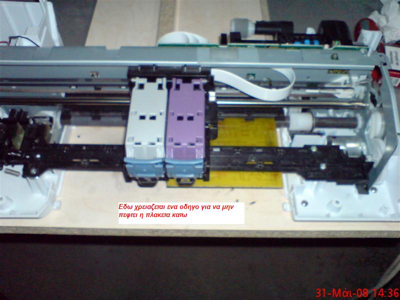

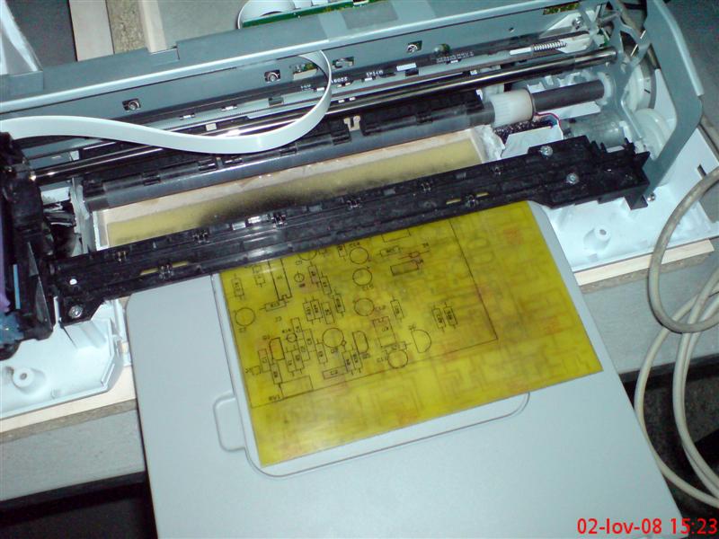

                Hi Max.
                Difficult work for me.Now I use a Inkjet and manufactures PCBs double layers with sillscreen in 1 hour, very easy and fine analysis .The problem is only one (best calibration machine for printing PCBs)
                  Originally posted by ANDREAS View Post
                  Hi Max.
                  very nice machine!
                  I'd like to make one too using an old plotter thing but cannot find enough time for little mods required.
                  I also had on hands a very fine machine some years ago... cause a friend borrow me for a couple of months... it was like little plotter stuff but using a rotating tool to cut tracks on pcb directly... it made also kind of silkscreen on relief... very pretty toy used for proto stuff but I had to get back to owner after few time and then device was lost cause of fire in the building it was employed at that time.
                  Unfortunately nice stuff like this are often too expensive for the hobby but your solution is what I had in mind for something 15years...
                  Sooner or later I will do it similar way.
