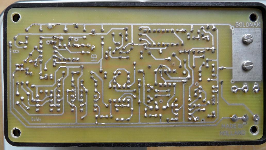

      I am trying to get the board out and I can just see a signature and date on the underside of the box. It reads: V Burnett 10th June 1993. (Victor Burnett was Vic Fiveash).Will post more photos when/if that board budges.

            Heres some photos of back of board, the best I could get without de-soldering.
            Pretty sure theres enough info here though.
            URL=http://www.imagebam.com/image/9aa008155860383][/url]
            Wire under masking tape running to coil socket.

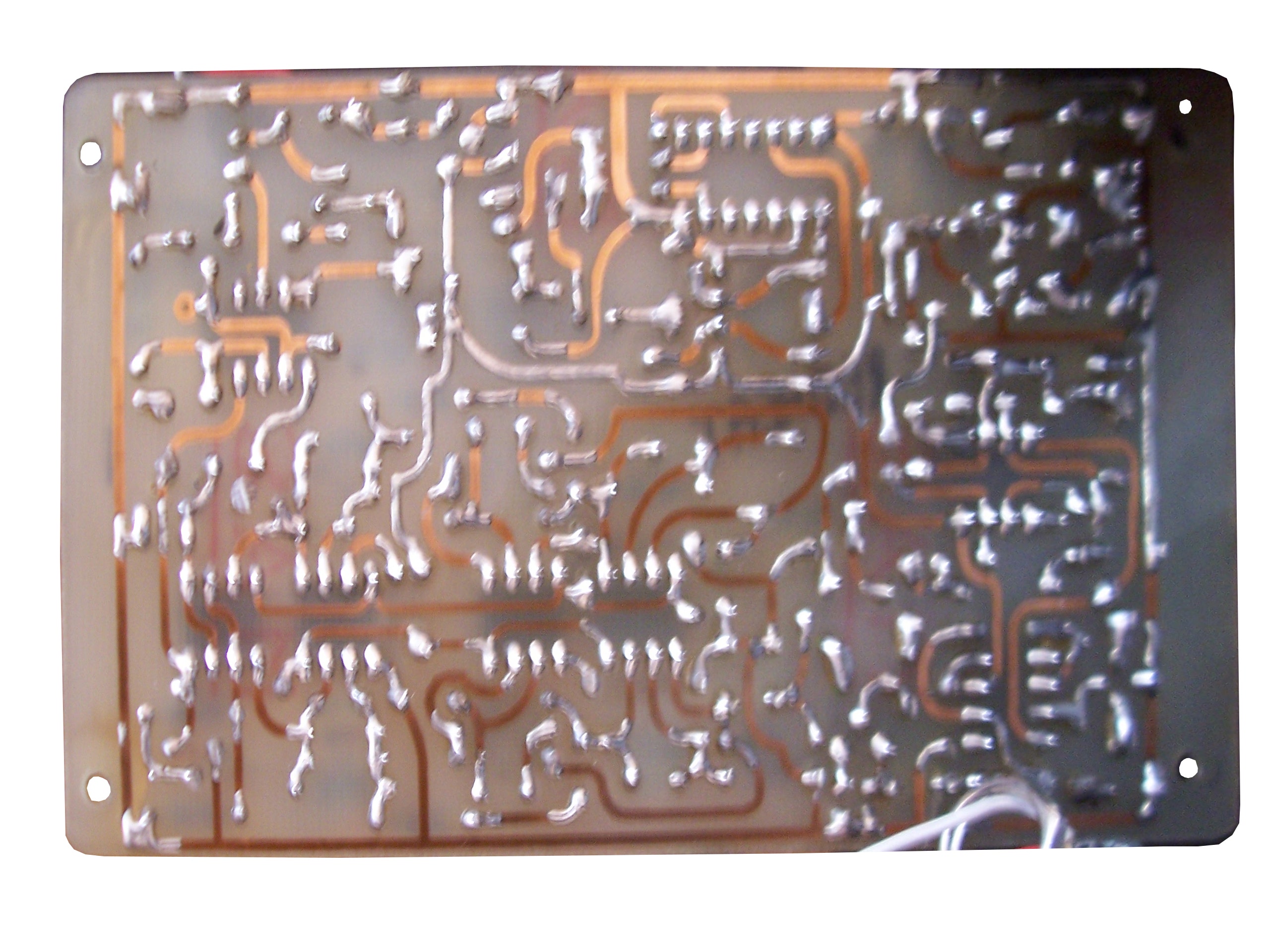

            • Eeh!
              Can you try to make shot with bottom layer exactly parallel with photo lens?
              The way it is now, pcb is too aslant and i can not redraw it without much of a job.

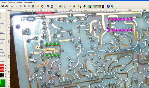

              I will explain how usually i do that, than you will see why is important pcb to be straight parallel to lens.
              I will take your photo and convert it to BMP format. Will cut all the parts of photo which i don't need (background).
              Than i will input that BMP as background in Sprint Layout and adjust sizes so to match 1:1 of original size.
              Than it is piece of cake to place components and draw tracks over photo.
              With aslant pcb like this one i will have lot of problems to see and mark all tracks properly.
              I am sorry to annoy you, if you are not comfort to make another shot -than don't, it really doesn't matter.
              But if you can, than i will do the draw pretty quickly and post it back here.
              Cheers!

                    • Is this any better?
                      I took the image that shows all the tracks, and twisted it around using the perspective and rotate tools in GIMP. After a bit of sharpening and background removal, here it is:
                      Not perfect, but the original image was very out of focus.

                          I think it's more important to get an in-focus sharp image of the whole board, even if it's at a slight angle. It's relatively easy to twist it back into shape with GIMP.
