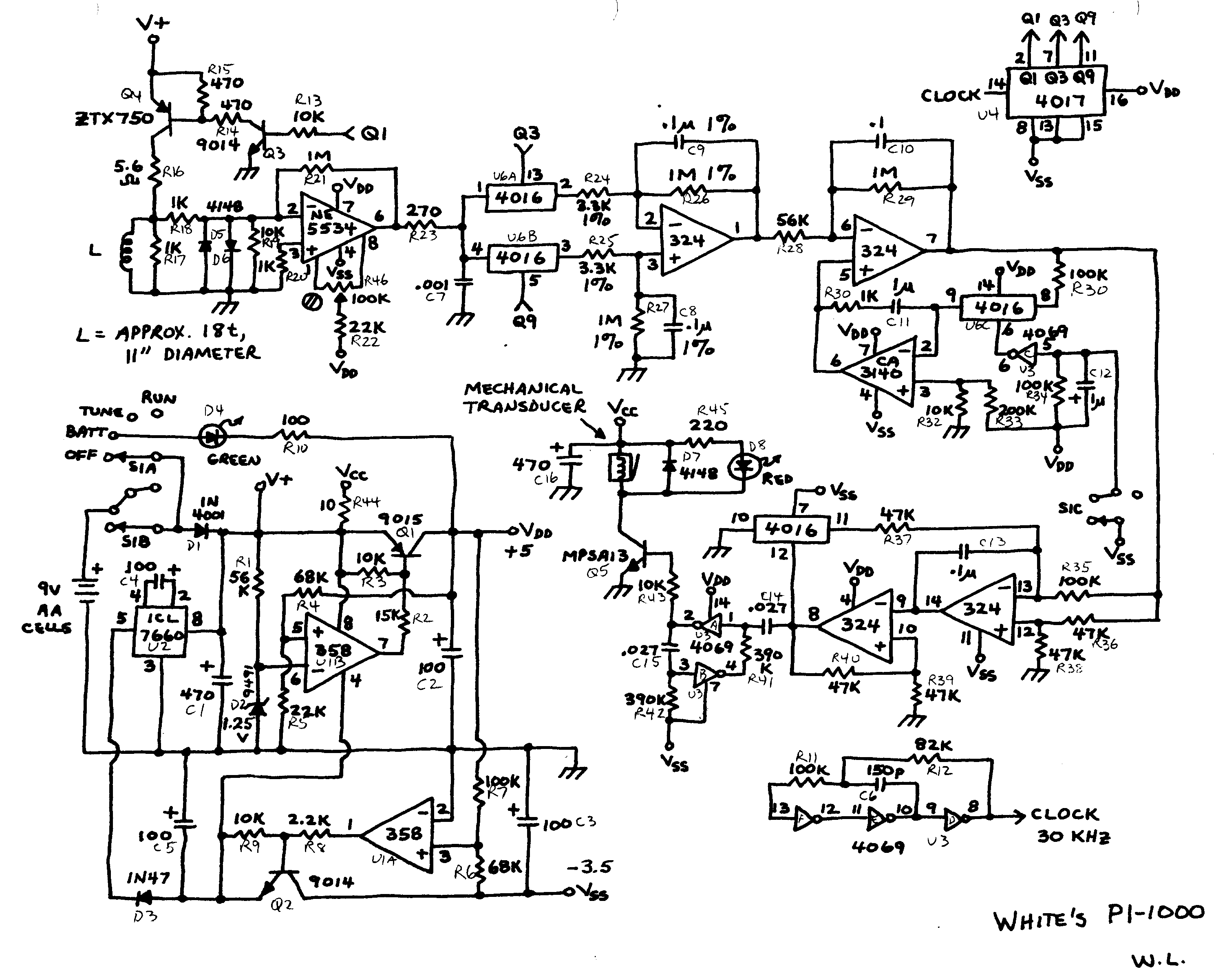

            PI 1000 Schematic
            ......... While everyone is waiting for KT315 to post his "Micronta Discovery 2 " circuit board "inside" photos !!!!! Here is another True Legend !!!............Complete with build it yourself photos and the user manual !!!!! WOW..............................Eugene
            Here's the schematic:

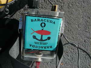

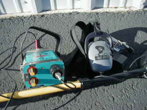

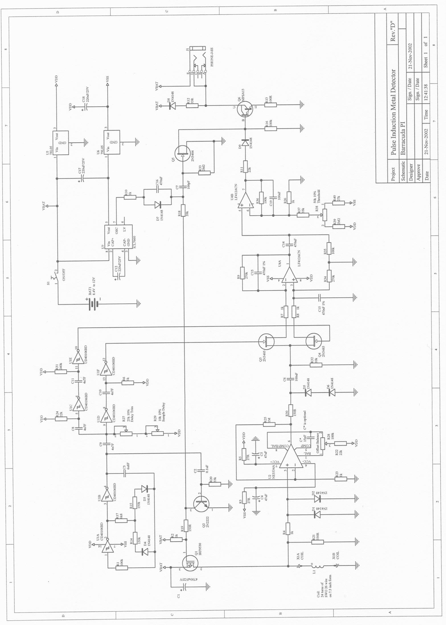

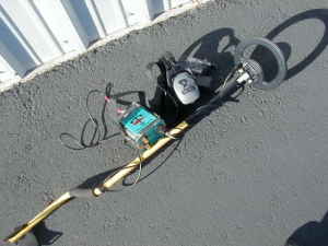

                  Hello DIRCEU, Here is what I have . You can add to it also!! This Detector is a "True Legend" !!!!!!!! Barracuda by Anchor Electronics. List Price was $795.00 , 8 inch search coil and had an optional 11 or 16 inch search coil..........Eugene

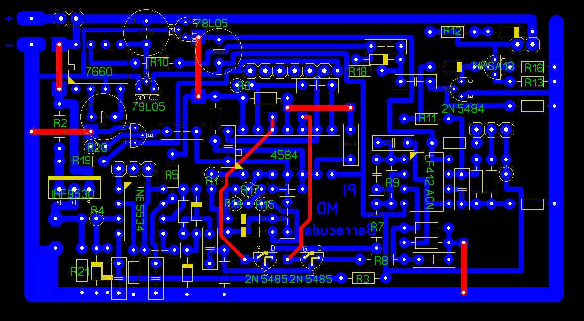

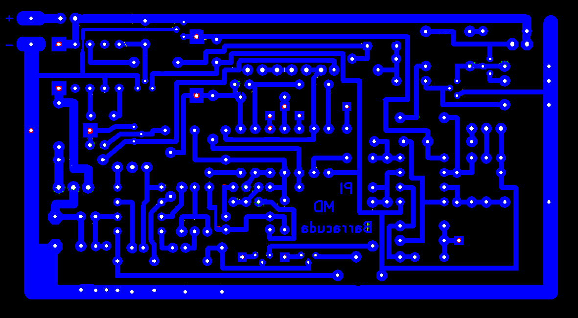

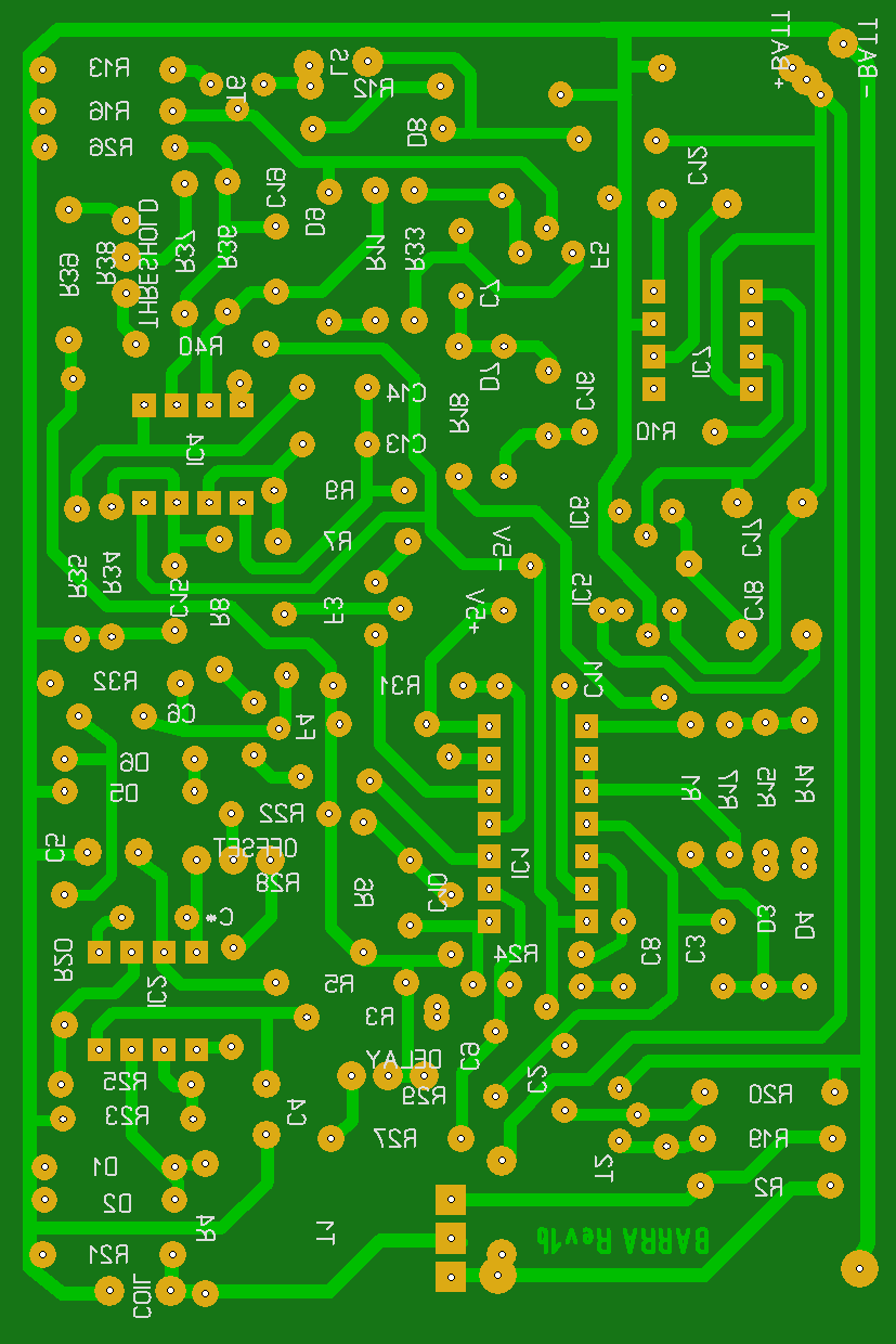

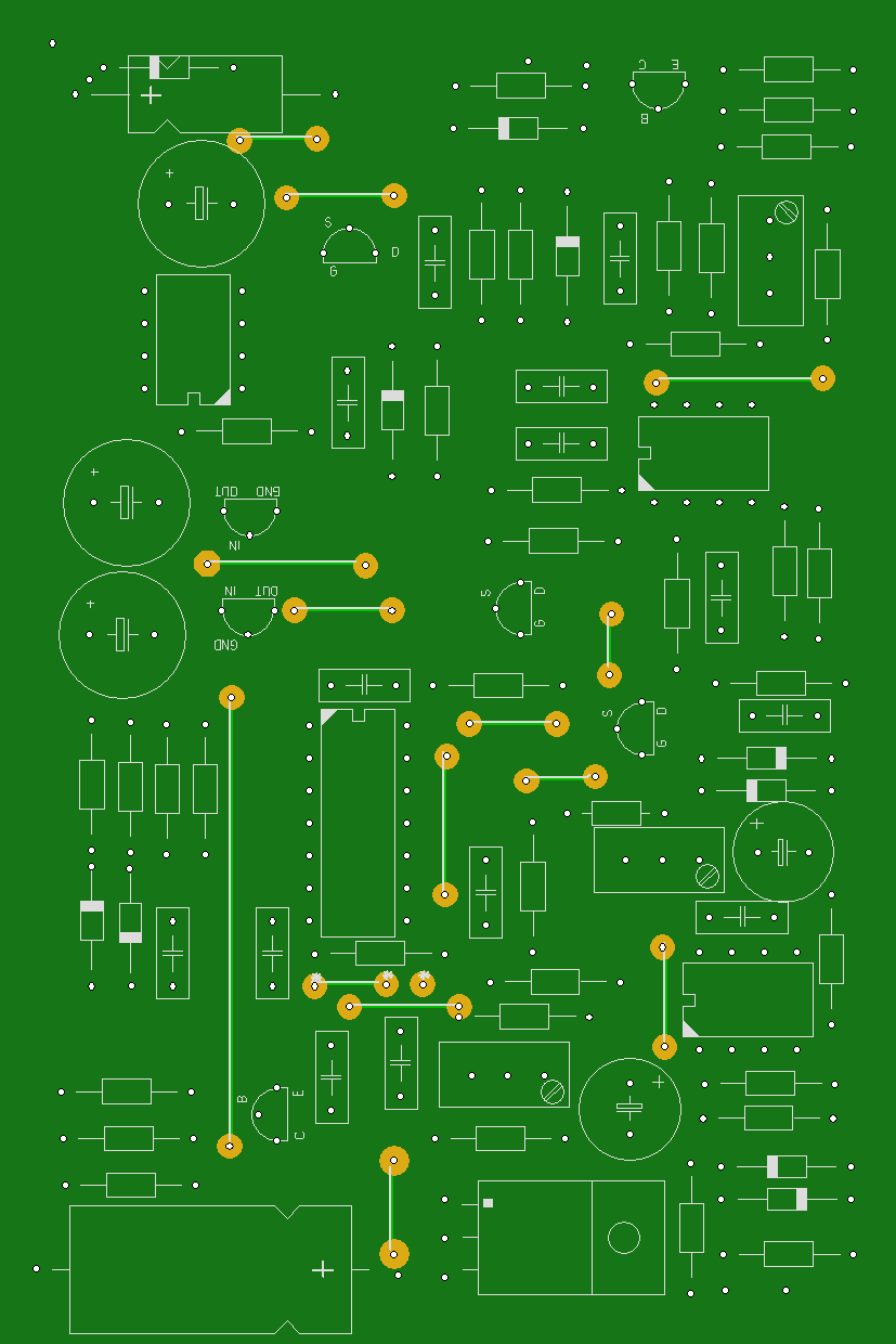

                    Here are 2 sides of the .lay file of the Barracuda just for reference only !! Because there are some errors on the Schematics again , "AS USUAL". Since I am going to travel for a couple of months. I will just have a little time to work on my "circuit analysis" thread I started here , on this forum ............. Take Care Everyone.........Eugene

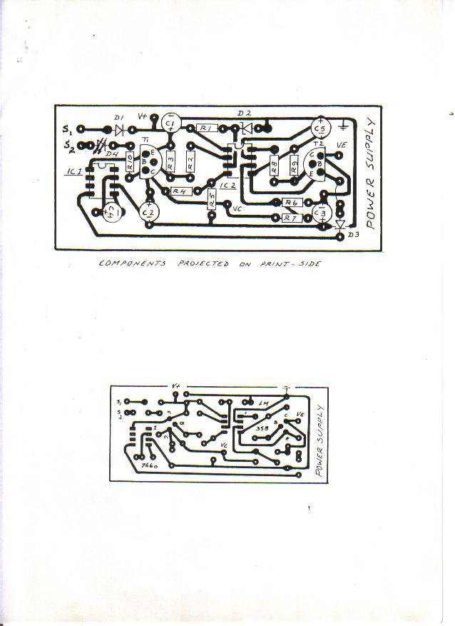

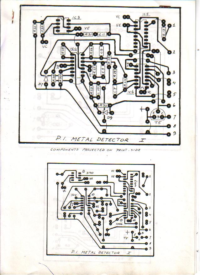

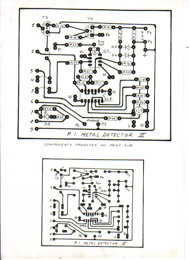

                      Quiaozhi, i also thought that way! Yesterday i was not lazy and performed detailed checks, comparing that schematic and pcbs posted above. Very simillar but not matching in many points????
                      Schematic looks as improved or modded version? Trace pcbs and you will see quite older design....
                      Is it possiblle that PI1000 has few versions?
                      Possible that schematic represent underwater version?

                        Interesting ... I'm afraid that I was lazy, and never compared the schematic and PCBs. The schematic was traced by W.L., who I assume is William Lahr, and he has a good reputation for accurate schematics.
                        Maybe there were some variations of the PI1000. Anyone know?

                          Hi Dirceu and thanks for posting Barracuda files.
                          Do you know if this files are correct?
                          Here i m sending a review for Barracuda, that i found on the web and one thing that opend my eyes, is that this detector could discriminate by diferent sound tones.
                          Anyway i have great interest on barracuda, so if there is any extra information to see, just post it.

                                OLA! NELSON
                                Thanks for post this articles.
                                I believe which the Barracuda Schematic have a lot of proposital mistakes.
                                At now no one built it. Why?
                                Only ALEXISMEX in SCHEMATICS topic in BARRACUDA...UP DATE (2) THREAD 45 have mention which he contrived to run a Barracuda variant.
