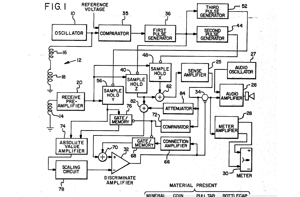

    THIS NEW THREAD WILL BE TO SEE HOW I.C.'S ARE USED IN VARIOUS STAGES OF A METAL DETECTOR CIRCUIT. THIS THREAD WILL BE DOWN TO THE "COMPONENT LEVEL". I CHECKED THE T.HUNTING ARCHIVES ON PATENTS AND FOUND 86 PATENTS ON VLF DETECTOR'S. MASSIVE AMOUNT'S OF INFORMATION !!!!! WHAT THEY ALL HAVE IN COMMON IS ALL OR MOST FILES HAVE "BLOCK DIAGRAMS" !!!!! BLOCK DIAGRAMS ARE VERY IMPORTANT FOR WRITING PATENT'S AND TO UNDERSTAND WHAT A ENGINEER OR DESIGNER IS DOING . SOMETHING WE DO NOT POST HERE TOO OFTEN ARE BLOCK DIAGRAM'S. PLENTY OF SCHEMATICS ARE POSTED HERE BUT THAT IS NOT ENOUGH. SO THIS NEW THREAD WILL IDENTIFY EACH STAGE OF A METAL DETECTOR AND WHAT IT DOES AND THE I.C.'S ROLE IN THAT CIRCUIT OR STAGE . IT WILL EITHER BE A PORTION OF THE BLOCK DIAGRAM OR PORTION OF THE SCHEMATIC.....OR IT COULD EVEN BE A PART NUMBER OR MULTIPLE PART NUMBERS IN QUESTION. HERE ARE SOME EXAMPLES OF METAL DETECTOR STAGES 1. TRANSMIT SECTION OR FRONT-END 2. DIGITAL TO ANALOG CONVERSION. 3. MULTIPLEXING 4. RECIEVE SECTION 5. AUDIO THRESHOLD OR AUDIO AMP. 6. DISCRIMINATION OR NOTCH CIRCUIT'S. AGAIN THE PURPOSE OF THIS THREAD WILL BE TO UNDERSTAND WITH 100% ACCURACY, WHAT THE COMPONENTS IN THE CIRCUIT STAGES ARE DOING. I HOPE THIS THREAD IS A SUCCESS. I WILL POST SOME SCHEMATICS THAT ALREADY HAVE THE STAGES IDENTIFIED. AND THEN WE WILL BREAK IT DOWN FURTHER TO GIVE A VERY INFORMATIVE "CIRCUIT ANALYSIS" OR EDUCATIONAL DESCRIPTION............EUGENE

    I AM NOW TRYING TO GET MY CLIPBOARD FUNCTION WORKING ON MY WINOWS XP SOFTWARE. THEN I WILL POST SOME BLOCK DIAGRAMS AND THE CORRESPONDING CIRCUIT DESCRIPTION'S . I DO NOT WANT TO DOWNLOAD FULL PAGES , JUST SMALL SIZE IMAGES AND SMALL SCHEMATICS. IT WILL SAVE SPACE ON THE FORUM AND BE MUCH EASIER TO STUDY !! EACH SECTION POSTED MAY ONLY HAVE 10-15 COMPONENT'S , MORE OR LESS, BUT THE PURPOSE WILL BE TO SEE WHAT IS GOING ON WITH THE CURRENT,VOLTAGE AND FREQUENCY OF THE CIRCUIT "HIGHLIGHTED" AND THE PURPOSE OF THAT STAGE OR "ITS FUNCTION". I AM NOT ACTUALLY POSTING DATASHEETS ON I.C. CHIP'S THEMSELVES , WE ARE STUDYING HOW THE CHIP WILL BE USED IN THE CIRCUIT. TRANSISTOR CIRCUITS WILL BE STUDIED ALSO...............EUGENE

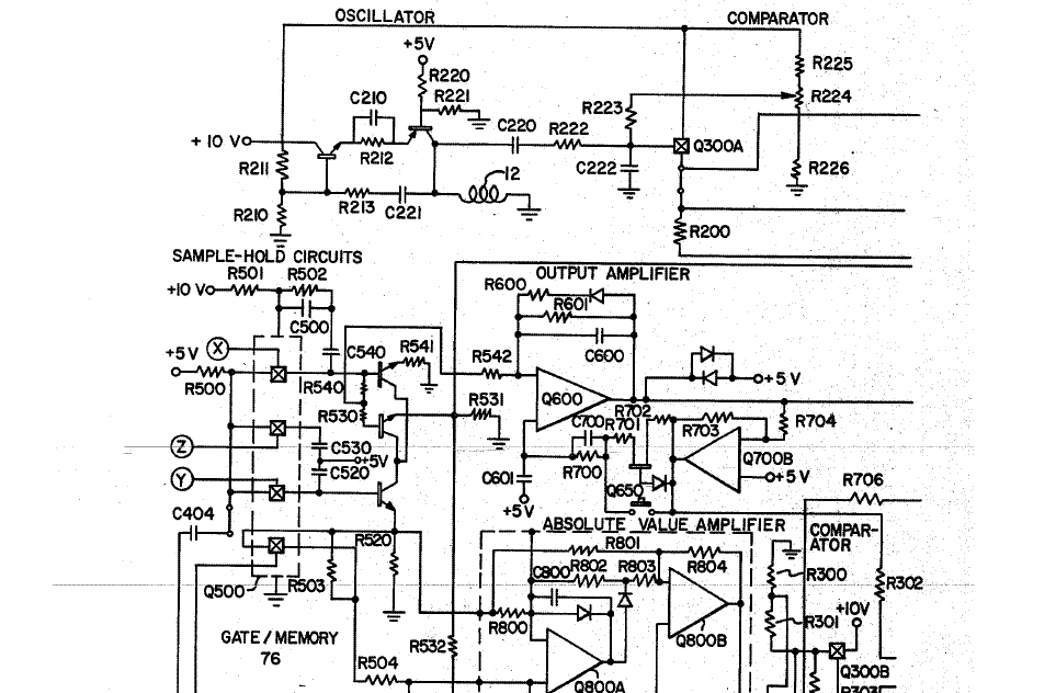

      HERE IS JUST ONE OF THE THINGS I AM TRYING TO DO . I HAVE DOWNLOADED A TON OF U.S. PATENTS FOR REFERENCE . AND THEY ARE PDF FILES AND THEY ARE OF COURSE "PUBLIC RECORD". I WILL SHOW 3 TYPES OF IMAGES. THESE HERE , ARE JUST AN EXAMPLE FROM COMPASS ELECTRONICS ... #1. BLOCK DIAGRAM #2. SCHEMATIC # 3. CIRCUIT DESCRIPTION . IF I GET THIS "CIRCUIT ANALYSIS" OR SOMETHING CLOSE TO IT TO WORK . THAT WILL BE GREAT !! ANY COMMENT'S OR CRITICISM ARE VERY WELCOME. ALSO "CIRCUIT ANALYSIS" FROM OTHERS WILL BE WELCOME................EUGENE

        ANOTHER WAY TO DESCRIBE A CIRCUIT , IS LIKE THIS PDF FILE WHICH I AM USING ONLY FOR REFERENCE . I LIKE THE BLUE OUTLINED BOX OVER EACH AND EVERY STAGE . LIKE SAMPLE & HOLD OR ANALOG POWER , PULSE CONTROL , JUST EXAMPLES.............EUGENE

            TINKERER , MY GOAL IS TO TAKE A SECTION OR STAGE OF ANY METAL DETECTOR MADE . DESCRIBE THE CIRCUIT AND ALSO WHAT THE PARTS ARE AND THEIR PURPOSE............EUGENE
