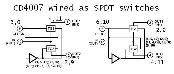

        Thanks to Qiaozhi, and some further research, I have completed a LTSpice model for a CD4053. I am making it available to this forum. To use it you will require the 3 files in the attached zip file. The Inhibit pin (pin 6 on the CD4053) on the model is non-functional. All other pins give a fair logical emulation of the original component.
          CD4007 SPDT Models
          Here are models and symbols for two versions of a CD4007 wired as a SPDT switch. I expended a good bit of energy trying to make sure that the pinouts are accurate, but I have not actually used these devices to validate them. I think they're OK, but I make no promise. Use them at your own risk.
